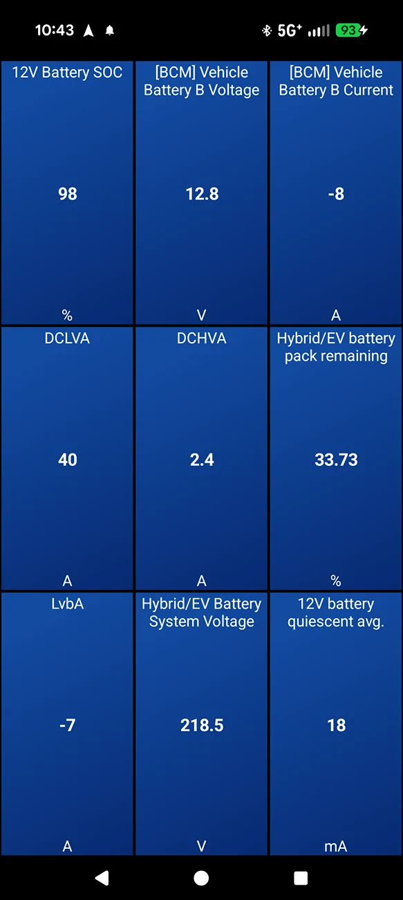

So now I will show my screen shots and try to describe what you are seeing.
12v SOC = 12 volt battery state of charge
Vehicle B battery Voltage = 12 volt battery reading in volts
Vehicle B battery Current = 12 volt battery amps (the amount of charge being sent to battery)
DCLA = DC/DC converter amp output to the 12 volt system of vehicle (this is like your alternator powering everything in the vehicle while running)
12 v battery quiescent avg = this is how much parasitic draw is while the vehicle is off
So to give you an idea my truck is a 2025 Hybrid fwd XL. It has had all the software updates by Ford including ACCM and ABS. It has an AGM battery from Ford OEM. My parasitic draw is between 12 - 18 mA which if you look up on google is outstanding for any vehicle 12 volt discharge while the engine is off.

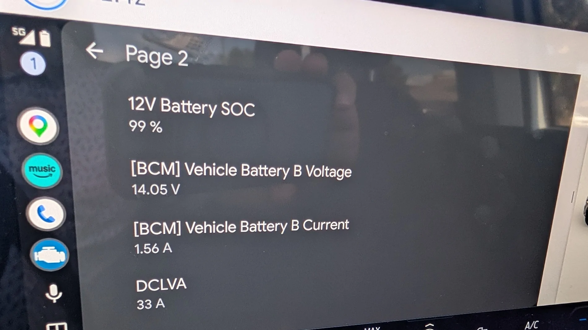

The first picture is with my headlights on (it's daytime here) and the battery is 99% SOC, Battery voltage is 14.05v, the charging amps are 1.56A (trickle charge) and the DCLVA is 33A due to the truck's needs.
The second picture when I started my vehicle you can see the truck went into immediate discharge of the battery and headlights are off. SOC is 98%, battery voltage is 12.8v, charging amps are -8A, and the DCLVA is 40A due to the truck requiring that much to run the 12v system.
(See how the dc/dc converter is supplying more Amps, but the truck isn't charging the battery but instead it is draining the battery on purpose. Once I turned on the headlights the battery started to charge.)
Just FYI I also changed the maximum state of charge from 80% to 95% in Forscan, and this did not change anything at all to how the truck performs on charging the AGM battery.
Anyway, I thought this was good info for people out there, and if anyone wants to test theirs they know more about how to do it.
I am using Car Scanner Pro (it's like $8 for a lifetime membership)
I am using Vgate vLinker BT OBD2 scanner from Amazon

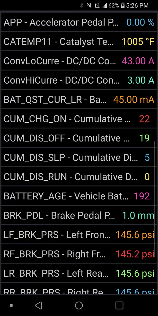

I'd always wondered what the PID for cumulative discharge while running was used for - now I know. And why I won't see any Amp hours on it.
you said yours is forscan lite, right?
