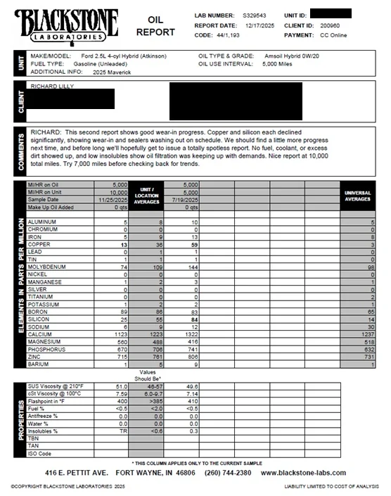

If anyone wanted to see this and compare. The first 5k miles were OEM oil and Filter. The 10k mile readings were with 0w20 Amsoil and Amsoil Filter.
I’m sending in my first sample today. I expect to see high levels of wear metals as my EB is still going through break in. What I’m most concerned about is oil dilution - with a TSB for my VIN for that issue.
I really like how Blackstone formats their analysis….thanks for posting!

Another report that shows changing oil too early.
Hybrids really can go 10,000+ miles between changes.
It's not a stretch. It is not a risk.
10,000 miles is way conservative in a hybrid.
And you're the say all be all on oil changes, or what? I changed at 5k to make sure to get the oil out during the motor break in period. I then changed at 10k to see the difference in OEM vs amsoil. You do see they recommended 7k oil changes, or did you skip that part? However, I'm at 15k and will do my next oil change and analysis at 20k. I've done 10k oil changes on all my Toyotas and no issues. My wife's Toyota at 150k oil analysis is great. My Camry at 170k was too.
As far as changing the first oil change before 10k is actually a good idea to get all the metal from machining out as early as possible. Several people do it at 1k. But if someone doesn't buy into 10k oil changes who are you to tell them what to spend their money on? 🤷🏻‍♂️

“The first 5k miles were OEM oil and Filter. The 10k mile readings were with 0w20 Amsoil and Amsoil Filter.”
Only way this would speak to me is to do another truck with
OEM oil and filter on the second service also,
Without Amsoil,

@OP, I don't see a serious conflict here. I agree that the hybrid can go 10K miles per oil change under normal driving conditions.
I also believe in doing the first oil change early as prescribed by "The Oil Geek".
I did my first (hybrid) oil change at 2,000 miles and I will do my second oil change after that 7K. After that I will go up to 10K, if I put that many miles on at the warranty's prescribed one-year mark.
Essentially, I think you are both right! I appreciate you sharing you oil test results.
Thanks for your post!
