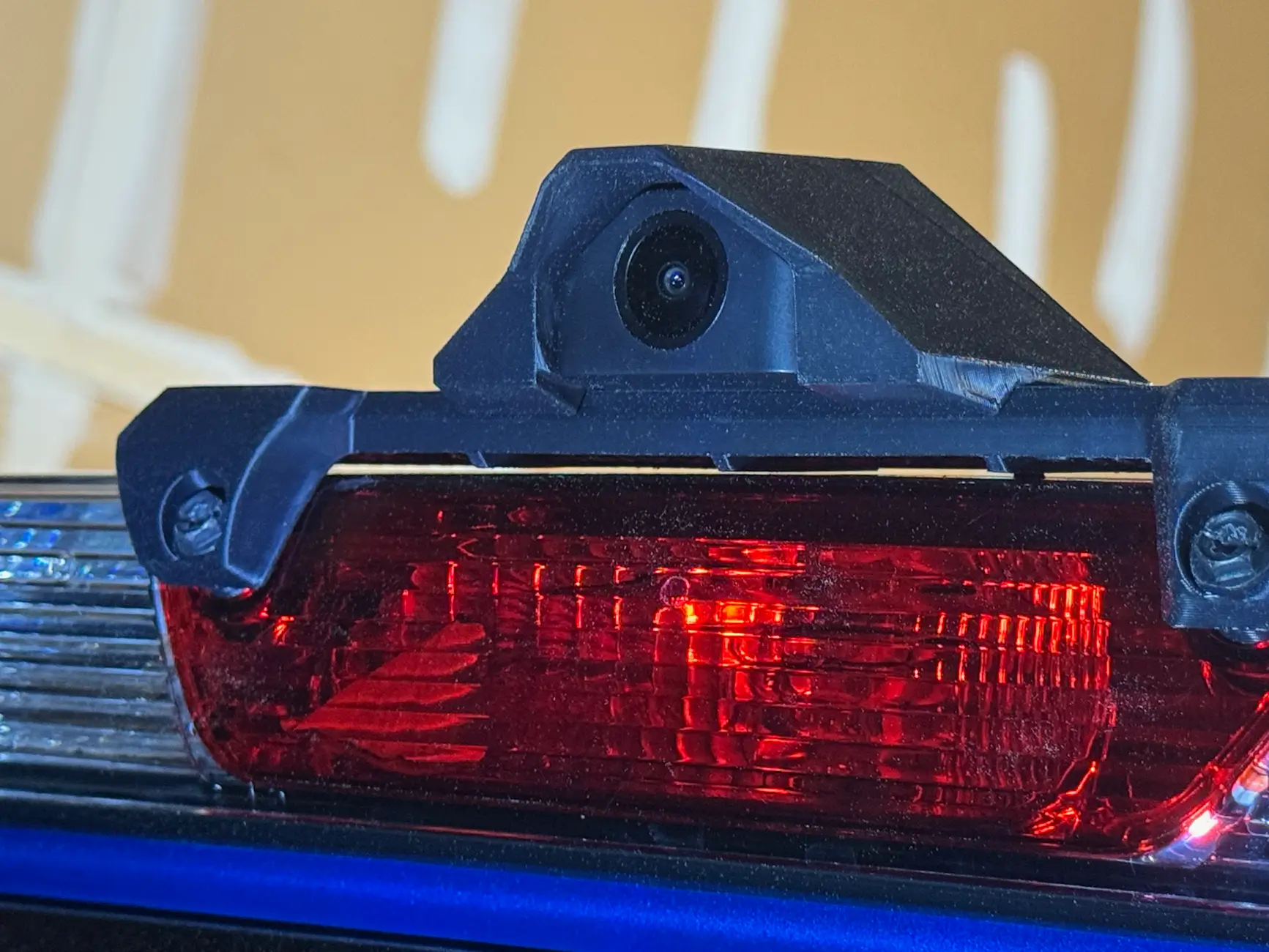

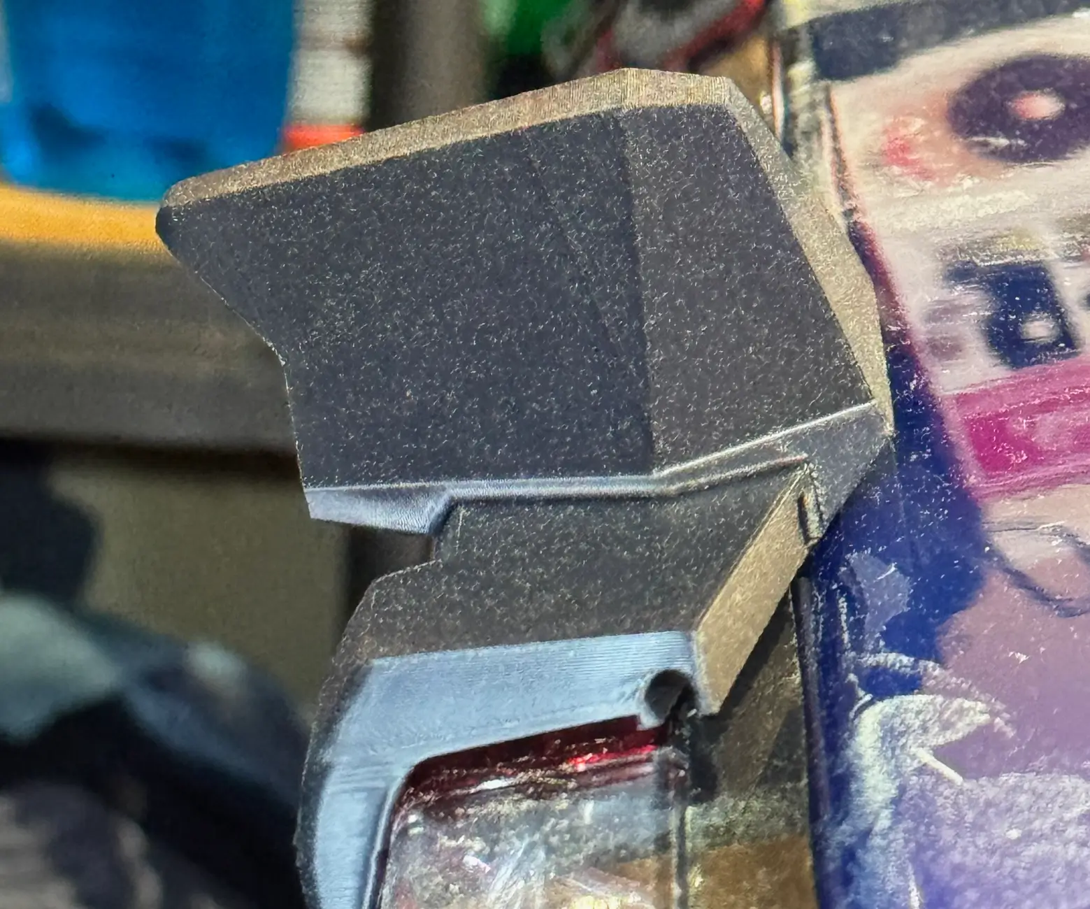

The rear camera was mounted above the third brake/cargo light in a 3D printed housing purchased from Etsy.

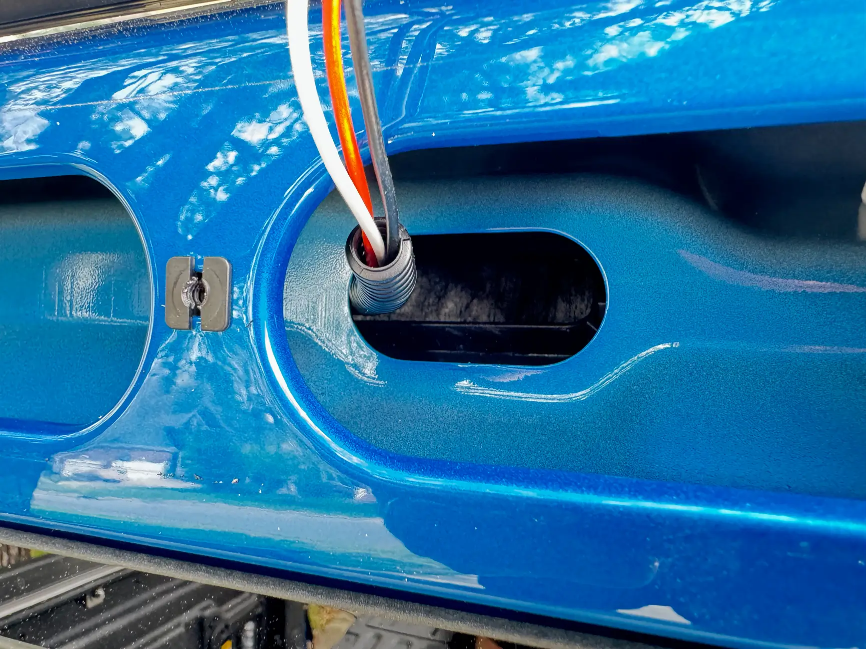

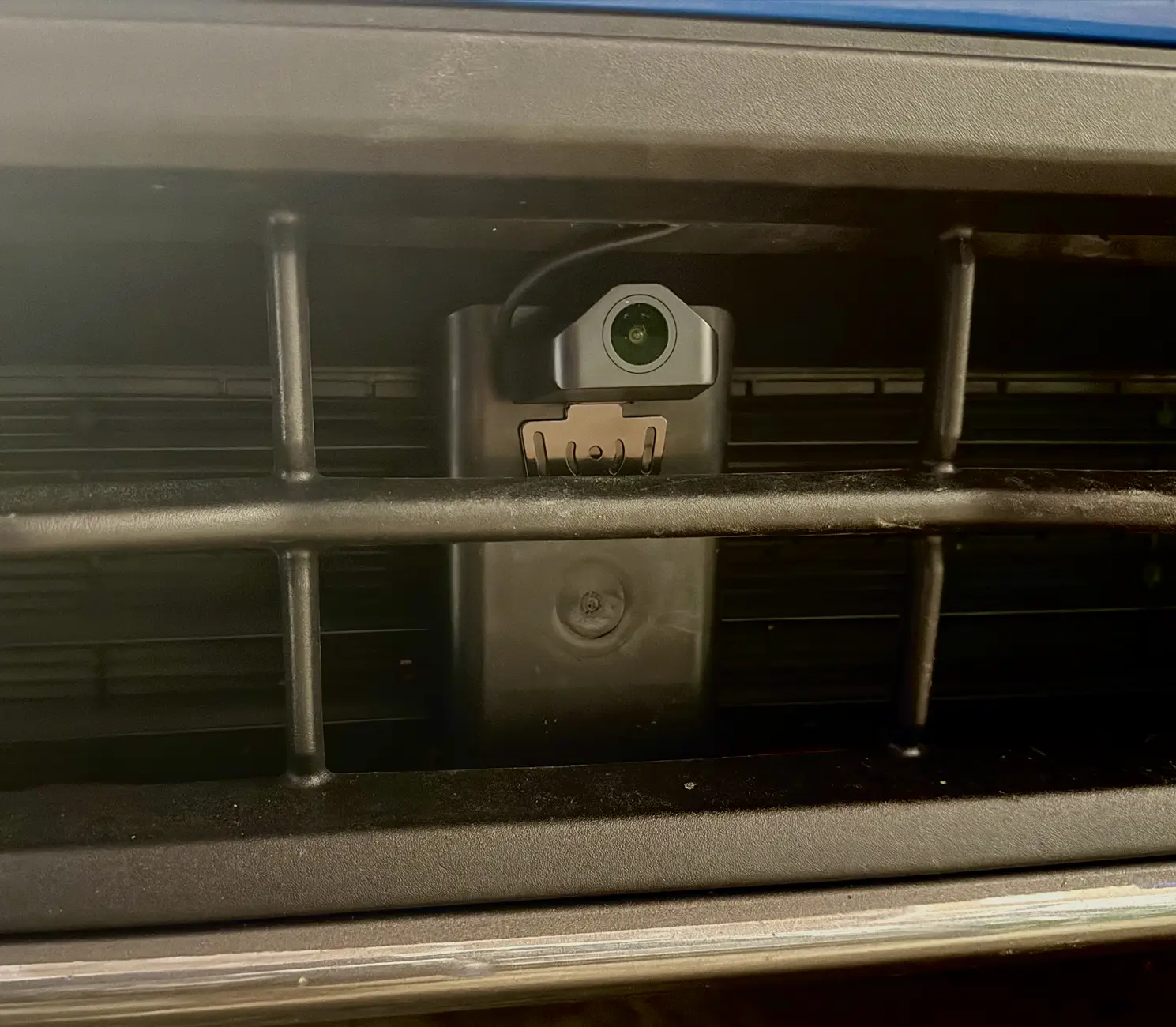

That bumper camera (labeled as "extra" in the menus) was mounted in the center of the lower bumper cover. Running this cable was by far the most challenging part of the install (more on that below)

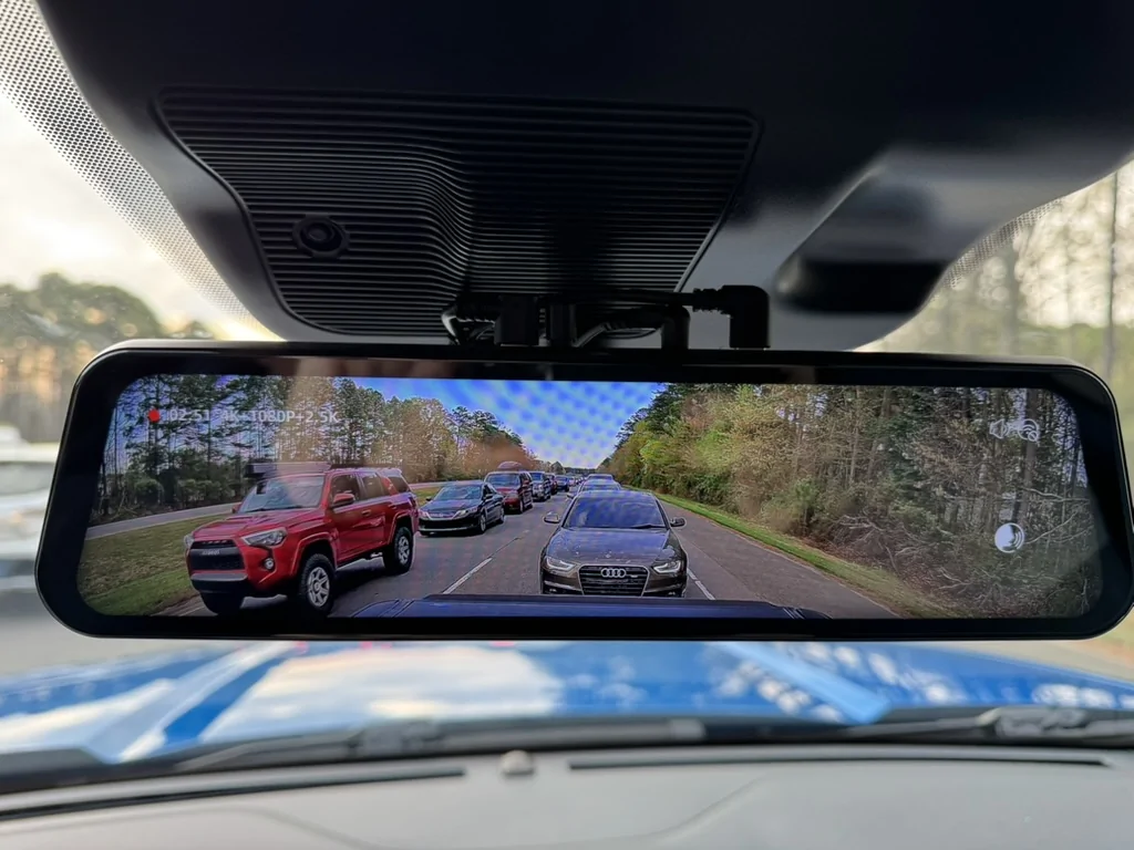

    • The rear camera's 170º field of view (FOV) essentially eliminates blind spots, removes obstructions like headrests and rear seat passengers, and when mounted above the 3rd brake/cargo light, eliminates whatever is in the bed from blocking the view.
      To give you an idea of how much more you can see, I photoshop'd a view of the original mirror over the Wolfbox screen. The Wolfbox is only physically a little bit bigger.

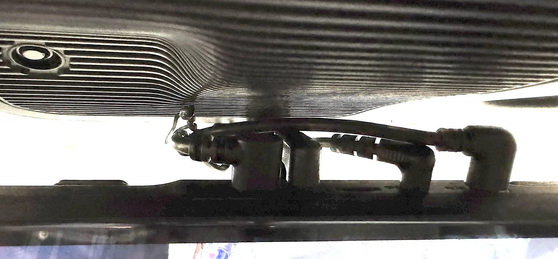

  • The mass of cables connected to the top doesn't look great, especially after you've spent time hiding them elsewhere.
    This design choice was clearly made to support rubber banding the screen to an existing mirror (see comments about stock auto dimming mirrors above). A very poor tradeoff to me.
  • The right angle USB-C cables all must be left facing, which makes bundling the mass of cables for a cleaner install more difficult.

  4. mounted the camera into the 3D printed housing (see above), mounted that to the 3rd bake light using the remaining (original) screws.

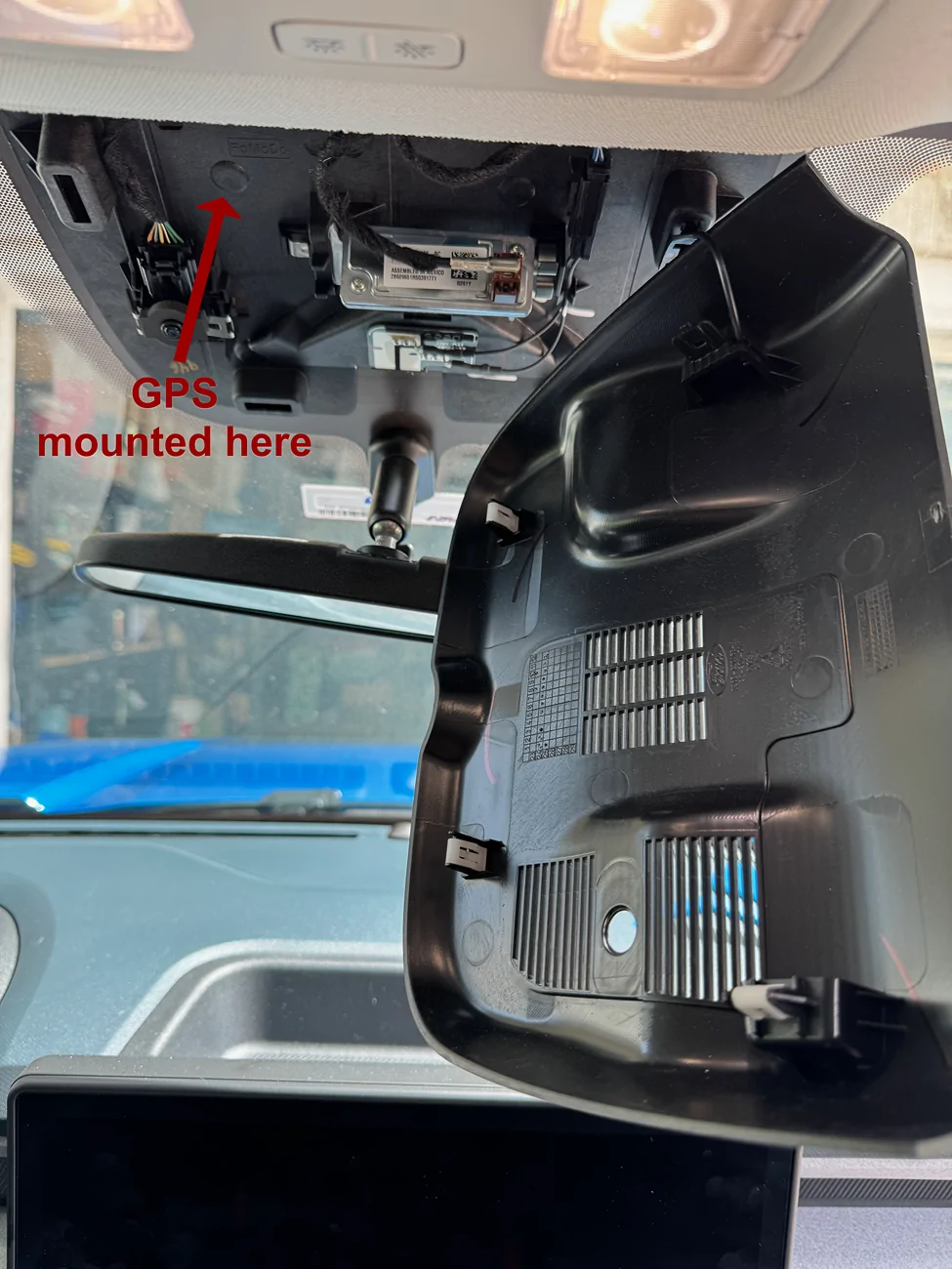

  2. mounted the GPS above the vision assist camera, zip tied excess cable covered both with the black plastic housing, works and looks great.

  2. cut a small slit in the rubber firewall grommet above the brake pedal, pulled the cable through using a fish tape
  3. ran the cable over the top of the strut tower, but under the black plastic cowl covering the windshield wipers (no need to remove it, just run it under) , along the drivers side of the engine bay, zip tying to the frame or other wire bundles along the way
  4. after searching for an hour, finally found the one bit of daylight that can be seen from the engine bay through the very top of the grill, all the way on the front right, fished the wire through that gap and through the grill, tucked along the backside of the grill. This avoided removing the front grill and bumper cover which I did not want to do if possible.
  5. again using the fish tape, ran the cable through an existing v-shaped opening at the center in the gasket between the bumper cover and the grill, out into the lower bumper cover
  6. mounted the camera (using the provided 3M adhesive) in the lower bumper cover (see image above).
  7. tucked the connection and excess cable behind the bumper cover.

Rear camera is mounted above the third brake light in a 3D printed housing purchased from Etsy.
"Extra" camera is mounted in the center of the lower bumper cover. Running this cable was by far the most challenging part of the install (more on that below)

  • cable connections don't look great, I really wish these could be plugged in behind the camera instead of on top.
    • There are many (1 USB-C for power, 1 USB-C for the rear camera, 1 headphone type plug for the GPS, and another for the front camera)
    • The power cable can't be plugged in with the cable facing to the center (to make bundling the cables cleaner) when the bumper camera is plugged in
    • This these top mounted ports were obviously chosen to make the product installable by strapping it onto the factory rear view mirror as well as the OEM mount, The result is a poorer result.
      I plan to heat shrink these to make them a bit more tidy.

  4. mounted the camera in the 3D printed housing (see above), mounted it using the remains two screws to the brake light

  2. cut a slit in the rubber firewall grommet above the brake pedal, pulled the cable through using a fish tape
  3. ran the cable over the top of the strut tower, but under the black plastic cowl, along the drives side of the engine bay, zip tying in several places.
  4. again with the fish tape found the one bit of daylight that can be seen from the engine bay through the very top of the grill, all the way on the front right.
  5. ran a fish tape through there and pulled the cable through the grill
  6. using the fish tape, ran the cable through an existing v-shaped opening at the center in the gasket between the bumper cover and the grill, out into the lower bumper cover
  7. mounted the camera (using the provided 3M adhesive) in the lower bumper cover (see image above).
  8. tucked excess cable behind the bumper cover.

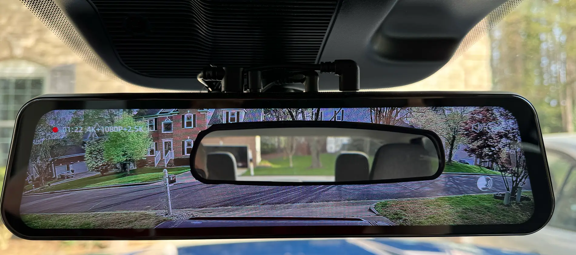

NIce. Can you post a couple of pics of the cabin view of the mirror. Interested in how clean it looks considering the cables plugged into it.

My only question would be do you have any input on how UV resistant that 3rd brake light mount is considering the NC sun?
Updated above with a broader image of the mirror while stopped at a red light. The cables blend in pretty well with the black plastic cowl over the factory windshield camera.
But it still annoys me because it's clearly a design choice placing compatibility strapping the product to really really big mirrors, over what could have been an ultra clean install.
The mount is printed using ASA plastic which should be UV-resistant.

Putting a few more miles on the Wolfbox, I realized I'd way undersold the coverage of the rear camera. It easily triples the field of view over the mirror. Getting the rear head restraints out of the way helps but the width of the view is game changing.
it's going to be strange driving a car with a regular mirror after getting used to this. More info on this comparison image in the original post above.
Edit: this is photoshopped with a cropped image of the mirror view superimposed over the Wolfbox's rear camera view. It's a hacky way to visualize the field of view of each. The Wolfbox is bigger (11" screen) just a bit bigger than the stock mirror, but the field of view is MUCH bigger.
why are there two images in the mirror? Makes me dizzy.
Mudduck
JD
Dec 13, 2025
415
718
Utah
24 Maverick FX4. 21 Wrangler Rubicon. 72 VW Ghia. 88 Suzuki Samurai. 23 FOZY
Its almost completely takes away the blind spots. I can see cars coming up in my side view mirrors long before I stop seeing them in the wolf box rearview.
GNprime
Dec 21, 2024
Ohio
2024 Maverick Lariat
The little mirror was superimposed to show how much can be seen versus the stock mirror (tiny image). It doesn't actually exist in real life. Just photoshopped perhaps. But, this was quite a very impressive representation of a comparison honestly! Makes me hyped to get to install mine!
