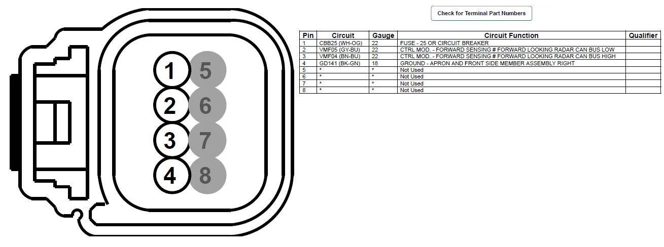

CCM harness wiring.
The face of the plug is towards you on this diagram, the wires are coming out the back of the plug away from you. Pay close attention as its easy to wire this one mirrored if you forget and use pin 4 as power in from IPMA terminal 18, and it wont work. We only need the 4 wires on the left column from this view.
Ford Maverick 2025/2026 XL/XLT Adaptive Cruise Is Working -- DIY how-to install instructions IMG_1431

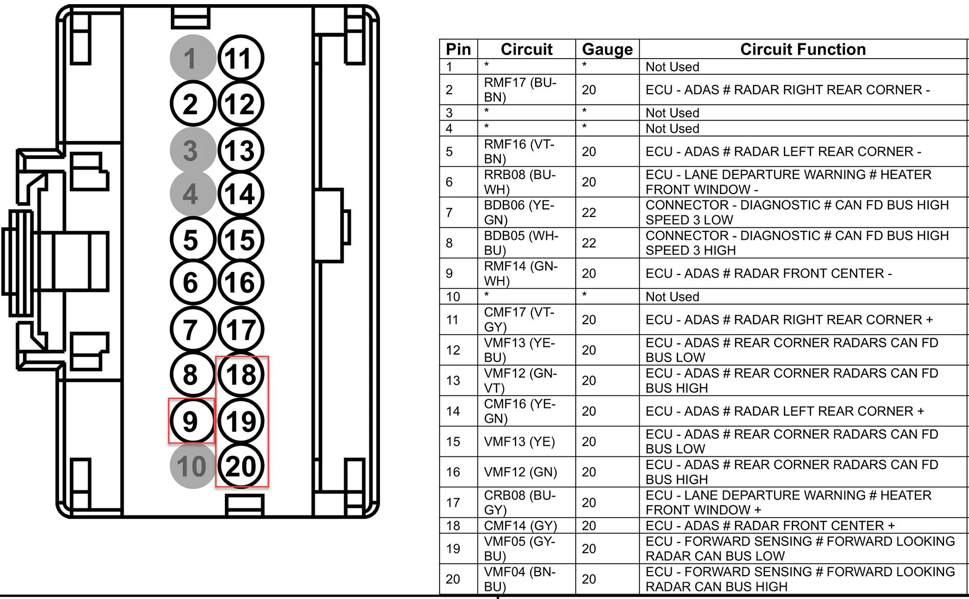

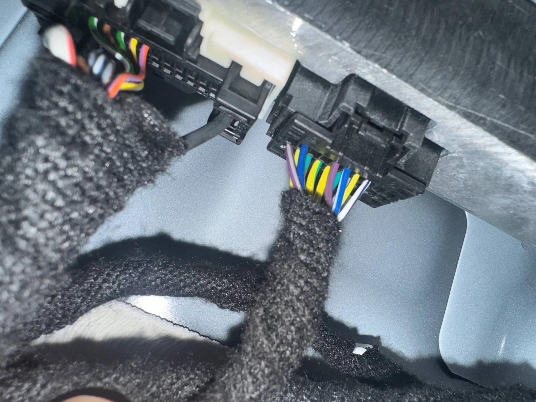

In the following pic you'll see the bottom of my IPMA with rear park aid and blind spot sensors wired up. notice 5 empty holes on the right hand side of the right hand plug. closest to us from left to right is pin 9 and pin 10, 9 is your CCM ground. 10 is unused here.
Behind it from L to R is empty 18, 19, 20, you'll need all 3 for 12v+ and communication to the CCM
Ford Maverick 2025/2026 XL/XLT Adaptive Cruise Is Working -- DIY how-to install instructions IMG_1856

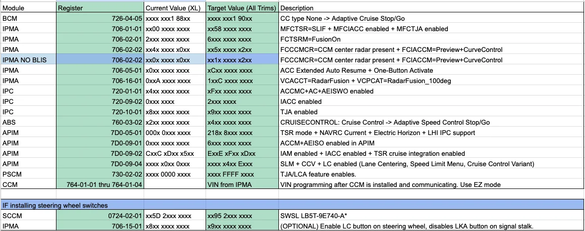

FORScan
When you get to the programming part, take note when you get to IPMA 706-02-02. Vehicles with blind spot sensors follow one line, those without follow the other.
If you are wiring the CCM behind the seat just to test if it will connect before committing to the rest of the work, the only change you should need is IPMA 706-02-02.
Disconnect from the truck once you save it, power cycle the truck, then reconnect and do not use the saved profile when FORScan asks. Again, there will be dtcs, clear them or ignore them, but the CCM should show up.
I think the APIM changes are optional, but you wont get the menus to change anything.
Ecoboost, should see in BodyCM 726-04-05 xxxx xxx0 88xx, leave the 0 alone only change 88 to 90
Ford Maverick 2025/2026 XL/XLT Adaptive Cruise Is Working -- DIY how-to install instructions Screenshot 2026-04-14 at 11.29.41

IPMA C3676B pinout.
Ford Maverick 2025/2026 XL/XLT Adaptive Cruise Is Working -- DIY how-to install instructions 1773409328367-fu

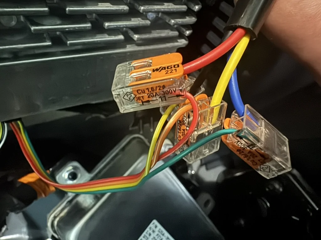

I used 4x 18 AWG stranded wire in a PVC sleeve, when you remove the trim on the driver's side you can route the wire through the white plastic wire guides.
I think 18 AWG is probably a bit overkill, 20 AWG would be easier to crimp (and appears to be what Ford used).
I used crimp butt connectors on the bumper side, I used heat-shrink over top, something like this:
Ford Maverick 2025/2026 XL/XLT Adaptive Cruise Is Working -- DIY how-to install instructions 1773678390116-ix
and Wago connectors for the interior, connecting to some cheap "dupont" breadboard/prototyping wire which had the correct connector for the IPMA side pre-crimped on.
Ford Maverick 2025/2026 XL/XLT Adaptive Cruise Is Working -- DIY how-to install instructions 99729A7D-E6DF-4015-831D-5457D3BD69EF_1_105_c

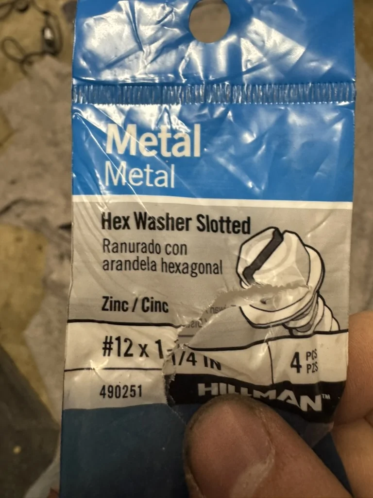

btw, instead of purchasing the screws from Ford, I just bought these generic screws from Lowe's along with some generic washers and it worked great.
Ford Maverick 2025/2026 XL/XLT Adaptive Cruise Is Working -- DIY how-to install instructions 53C0A37D-2CC3-4208-90EE-58DBCFA96424_1_105_c
