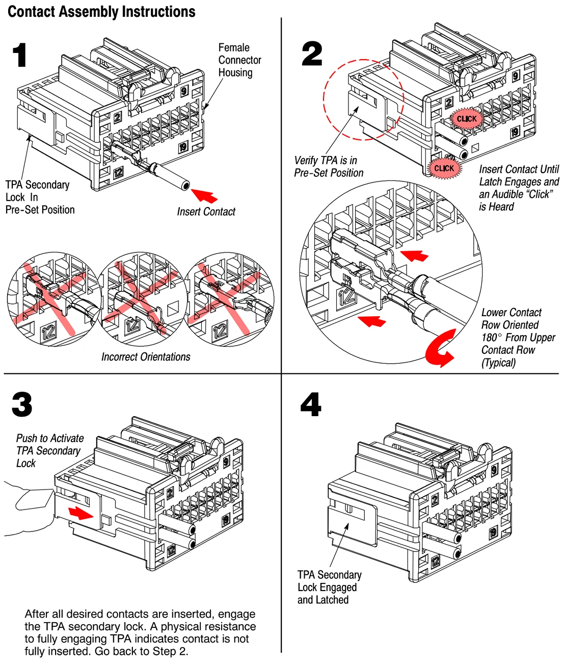

@JCMavGuy
"do I just push them into the empty slots? Is there some kind of locking mechanism?"
The IPMA connector might be like a Gen Y:
Ford Maverick 2025/2026 XL/XLT Adaptive Cruise Is Working -- DIY how-to install instructions 1775186902726-l2

@JCMavGuy
Guess I got lucky that they popped in, I didn’t know to pull that piece back. Thanks.

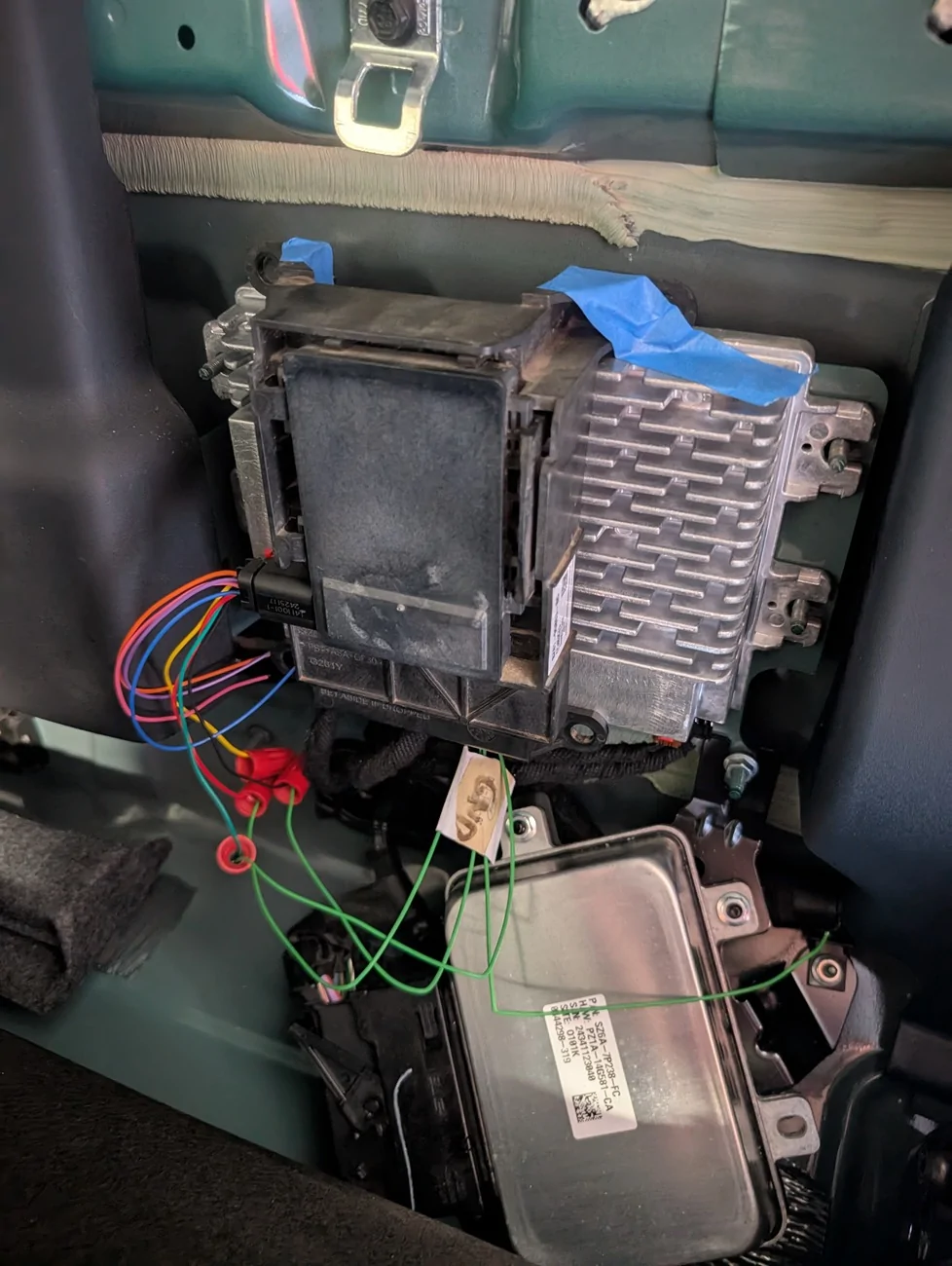

Damn. I've got it wired up in back and changed all lines leading up to CCM from the screenshot on page 1 but CCM isn't showing up.
Are those the only lines I have to change, or just the only ones that are different from the original 2022 post back in the day and there are more?

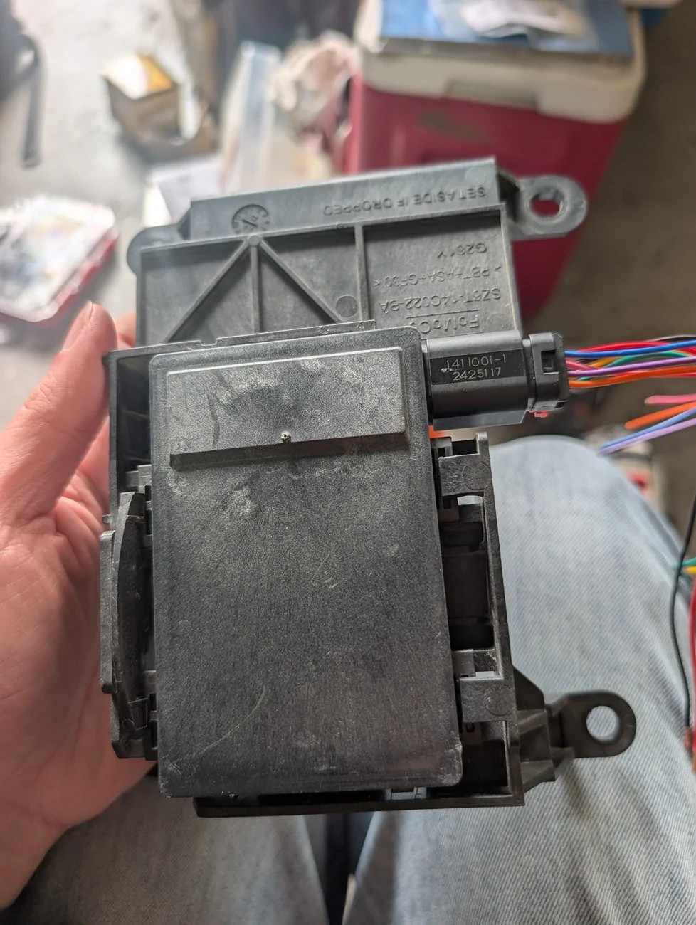

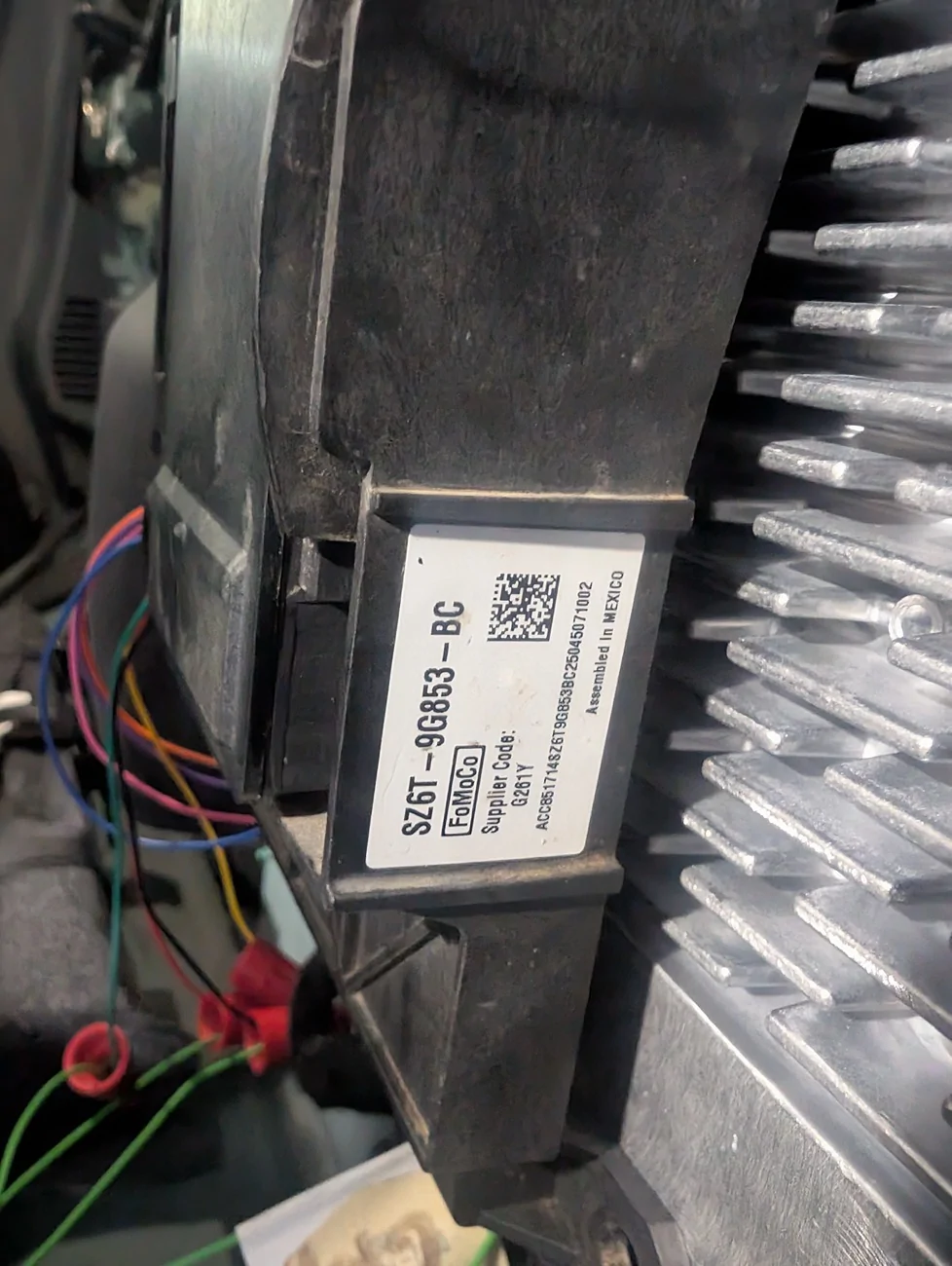

This is the one they sent me. Ebay seller said it was from a 2025 lariat but numbers don't seem to match(?) it does have the mounting bracket included
