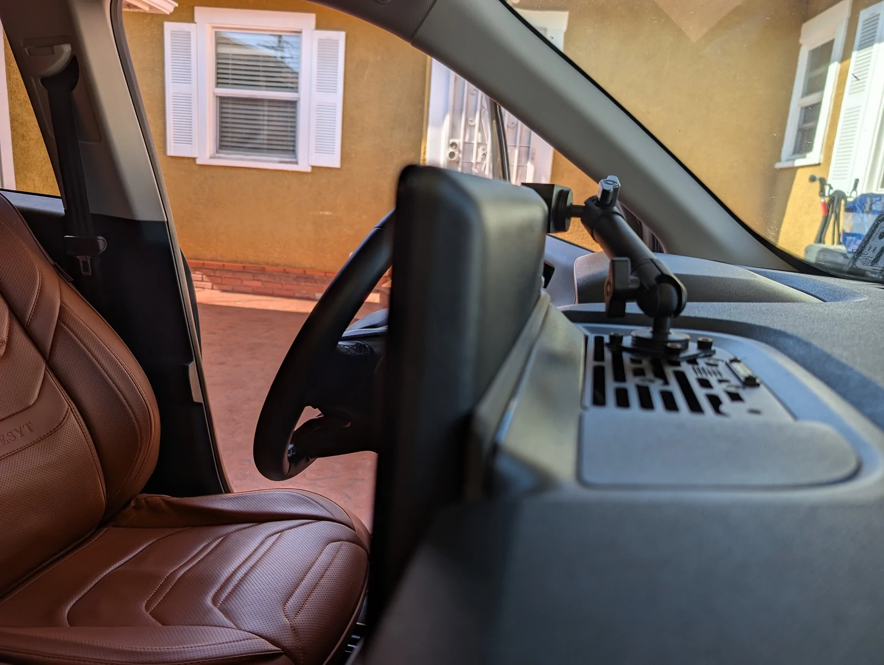

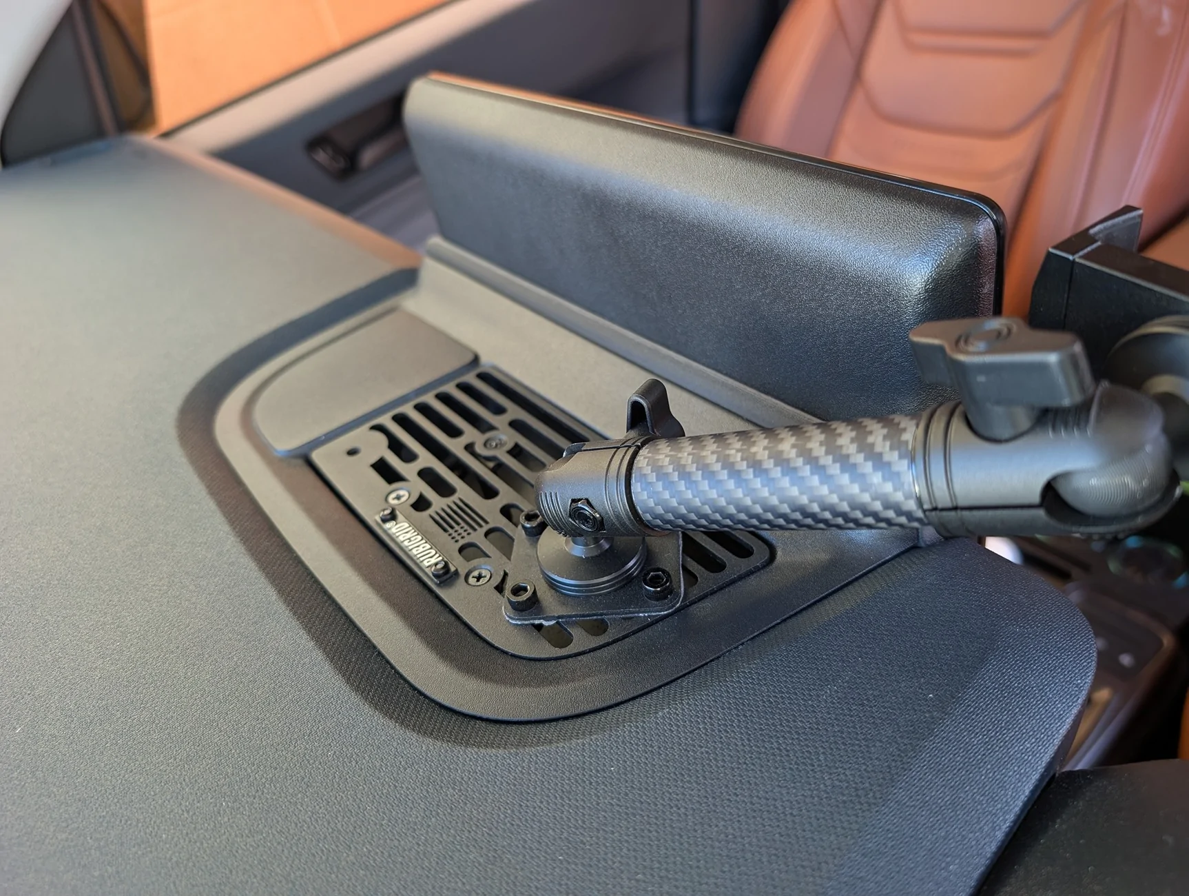

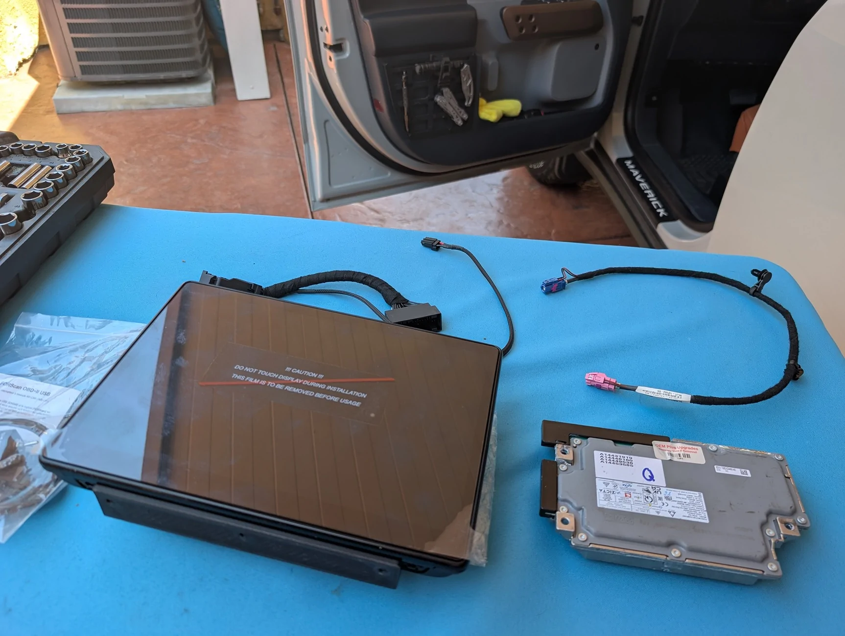

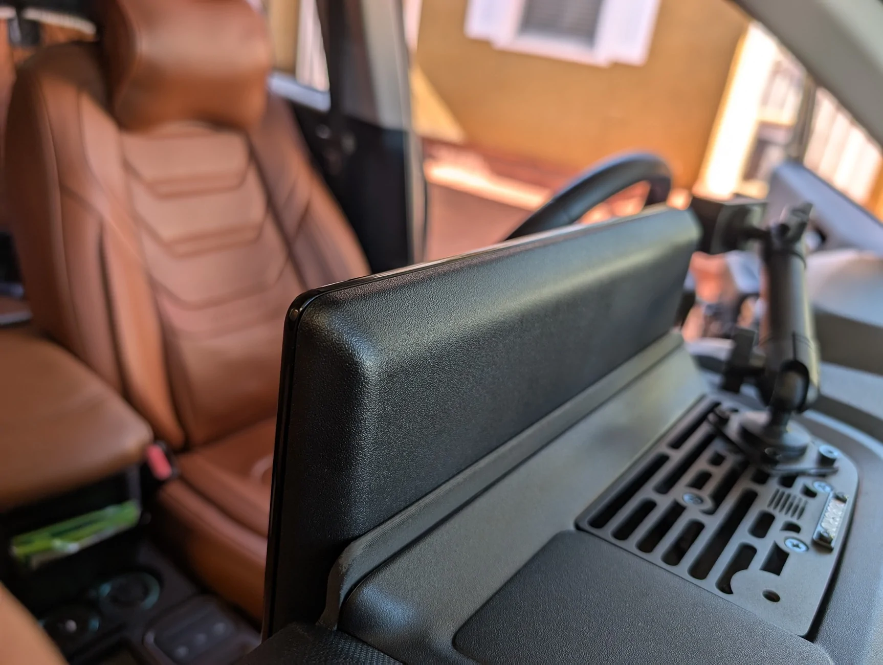

if not too much trouble, can you post a picture from the back side of the unit? i want to see if there is any gap where it connects.
The unit comes with a back-plate trim piece to cover the gap on the back of the touchscreen.
You still can rock the touchscreen without the trim piece, but it will look unfinished. I suffer from OCD, so without it, it would be a no-go.
I've attached some pictures below. The pictures don't do it justice. It looks better in person.
