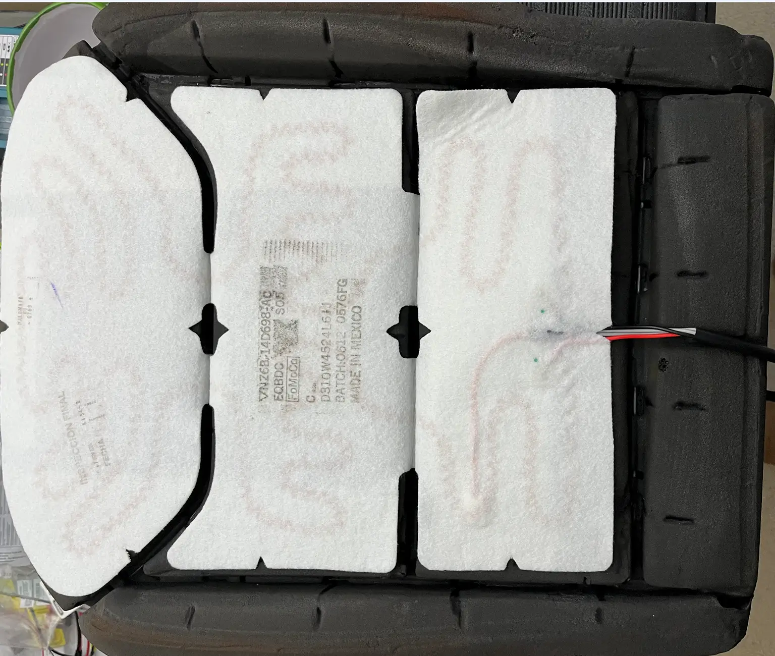

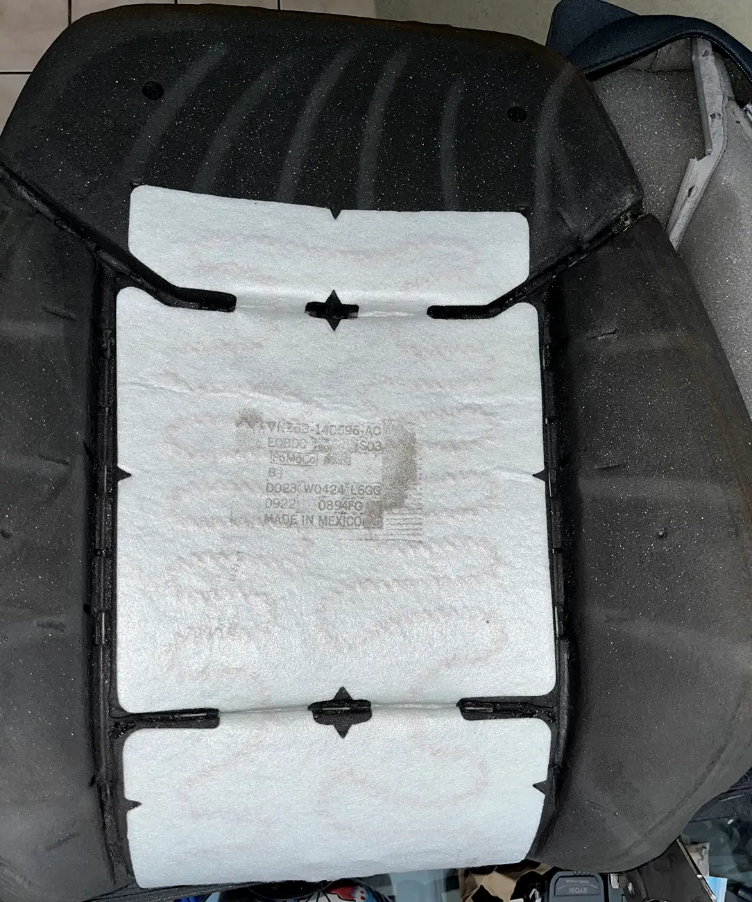

Removed each seat cover, installed Ford heat pads that have covered adhesive.

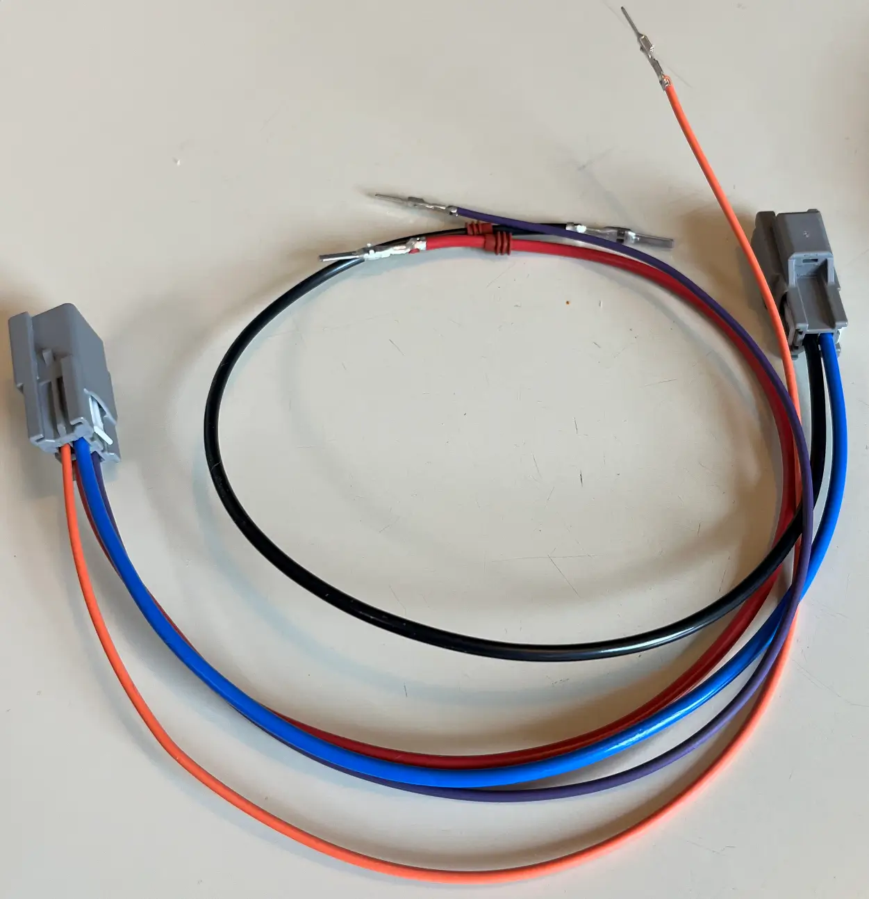

Made seat heat harness for each seat that connects to heat pad Yazaki connectors and the seat Molex MX150 connector.
Made harness with (1) 16 Awg seat heat feed , (2) 22 Awg for seat cushion temperature sense for HVAC C228B to Front Seats.
(1) 22 Awg that is spliced onto Sig Rtn near C228A.
Two Sig Rtn wires are needed, one for each seat. I just wanted to reduce my 1st splice thickness near the HVAC C228A connector.
I added another 22 Awg onto that wire under the floor console so have a Sig Rtn wire going to each seat.
Run my tesa taped harness along existing harness that goes up above and then down toward RH side of floor console.
Then ran harness in the floor console. Y off to each seat just behind front mount bolts, under carpet & up from carpet where existing body harness is for each seat.
Removed (depinned) existing body harness connector heated wires and installed my wires from the HVAC module in their place on each seat body harness connector.
Seat Heat Pads:
Driver Seat Cushion
Ford Maverick Heated Seats Install (OEM Factory) in 2023 XLT 1772209753004-f4
Driver Seat Back
Ford Maverick Heated Seats Install (OEM Factory) in 2023 XLT 1772209673709-z3
Seat Heat Harness for Seat Cushion & Seat Back:
Ford Maverick Heated Seats Install (OEM Factory) in 2023 XLT 1772209957766-uv

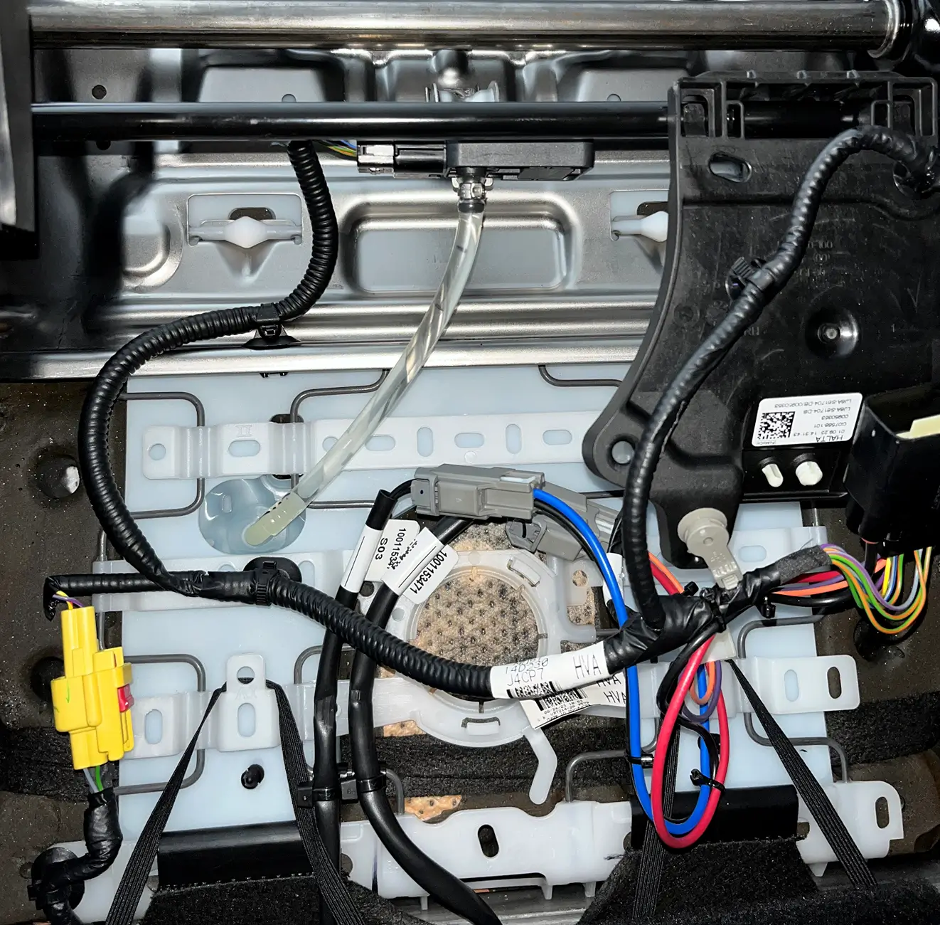

Passenger Seat with Cushion & Back heating harness:
Ford Maverick Heated Seats Install (OEM Factory) in 2023 XLT 1772211712285-qk

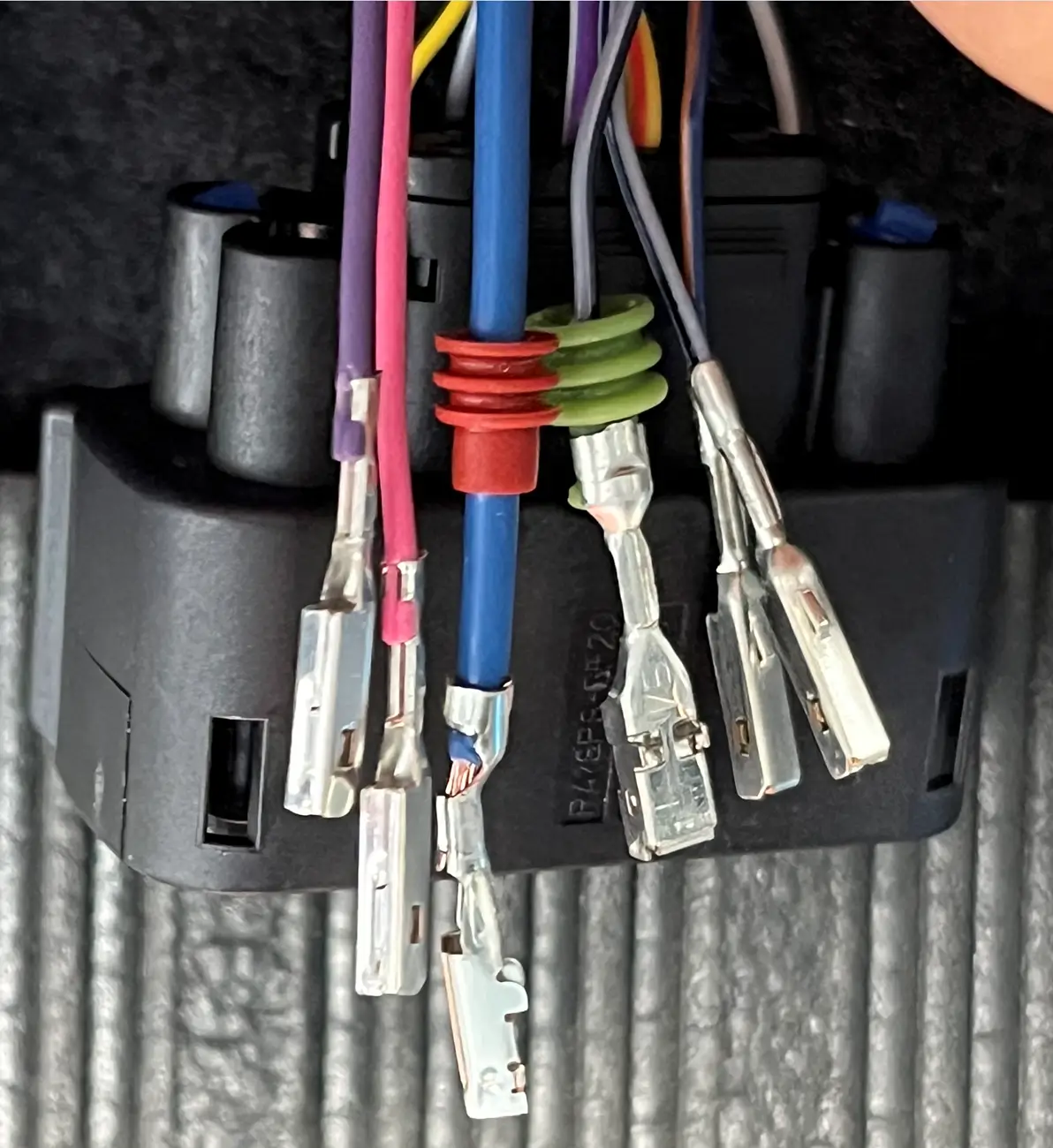

Driver Seat C305 Molex Connector with heat harness wires:
Ford Maverick Heated Seats Install (OEM Factory) in 2023 XLT 1772210062900-7

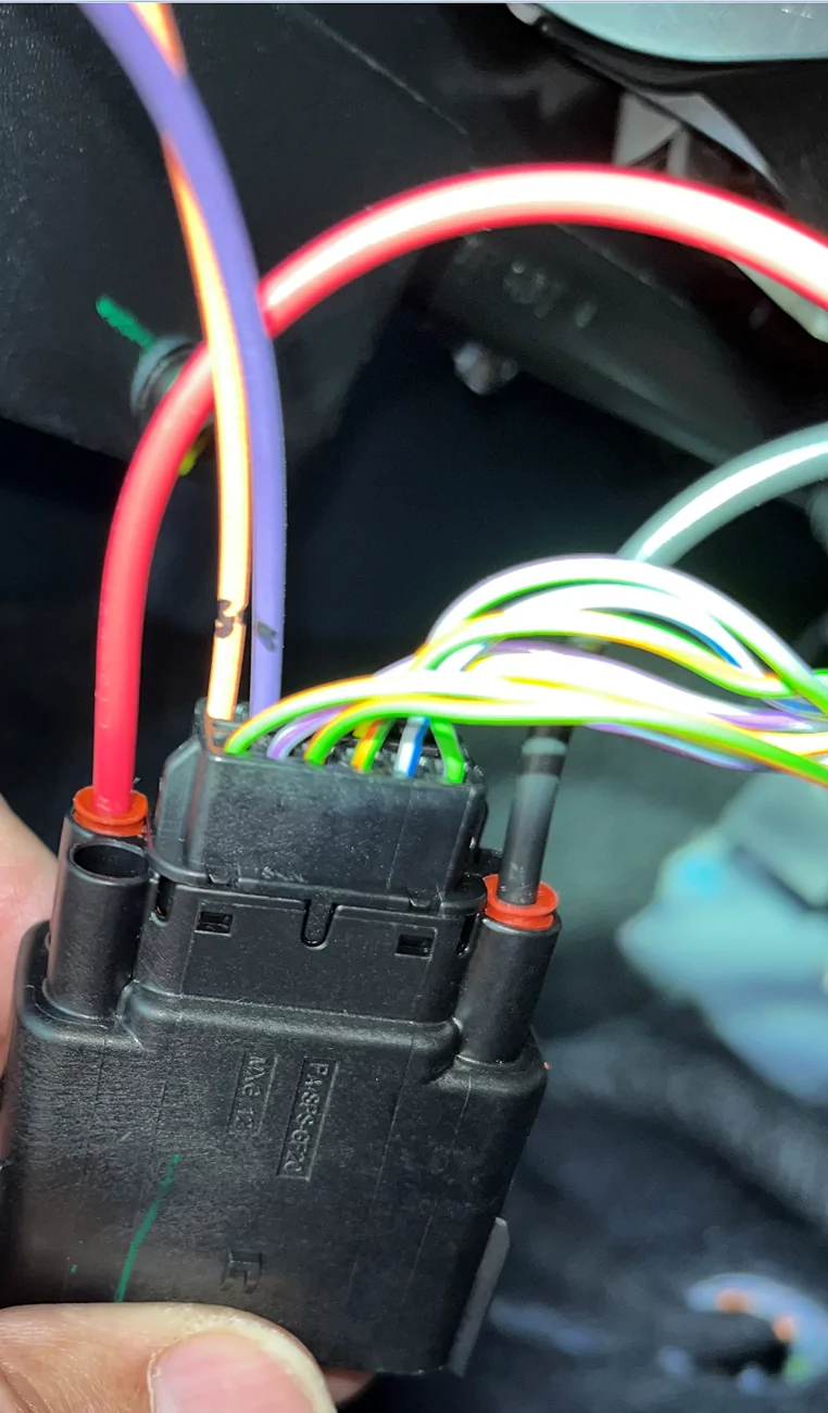

Passenger Seat Body Harness Molex connector with 3 added HVAC wires on left, 3 replaced wires on right that ran to only one side of C207 at right side above kick panel.
Ford Maverick Heated Seats Install (OEM Factory) in 2023 XLT 1772210217536-83

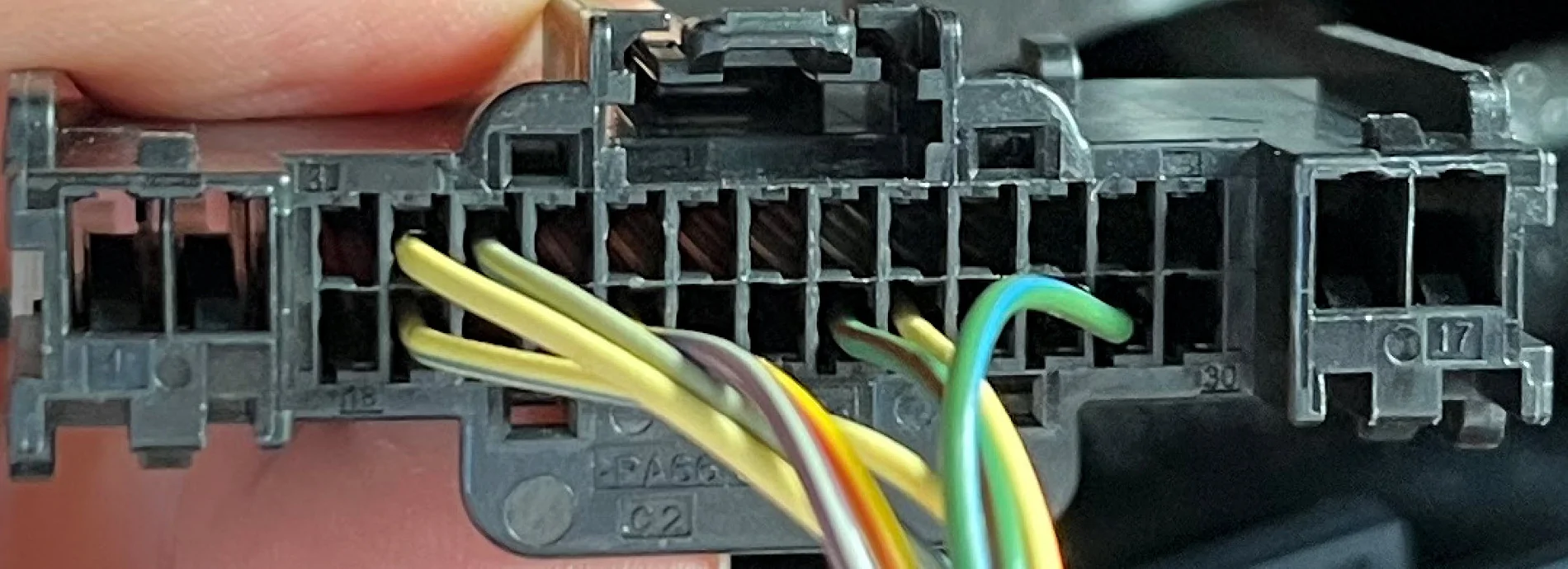

HVAC Module Connectors:
C228B - HEATING, VENTILATION AND AIR CONDITIONING (HVAC) CONTROL MODULE
Ford Maverick Heated Seats Install (OEM Factory) in 2023 XLT 1772205875158-8
Ford Maverick Heated Seats Install (OEM Factory) in 2023 XLT 1772206320487-98
Ford Maverick Heated Seats Install (OEM Factory) in 2023 XLT 1772206377311-m6

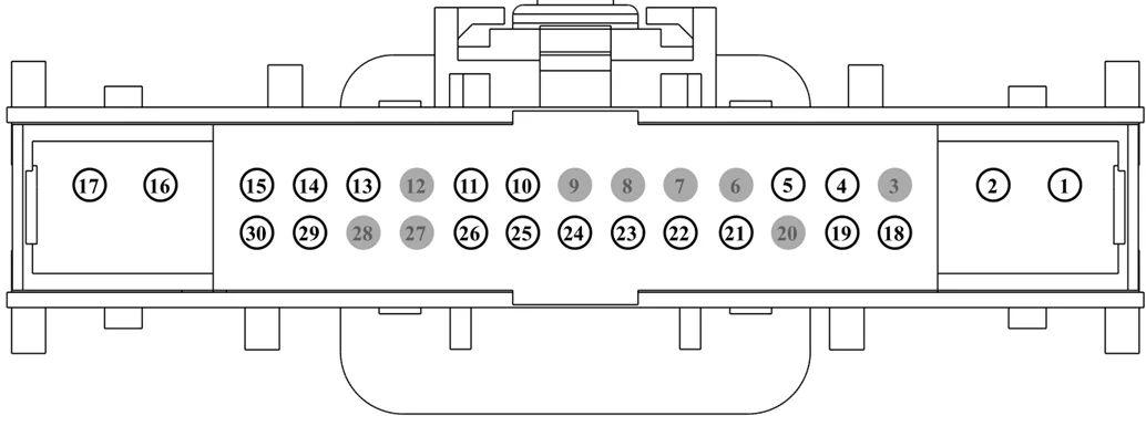

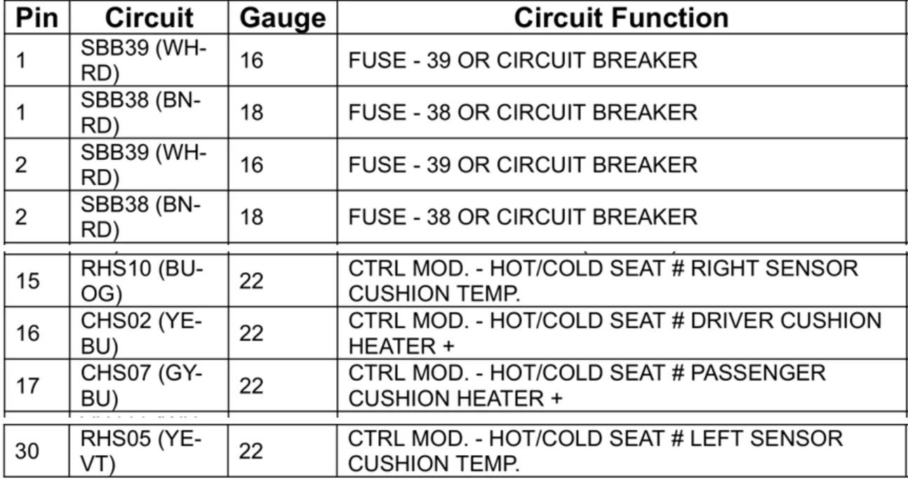

C228B Terminals

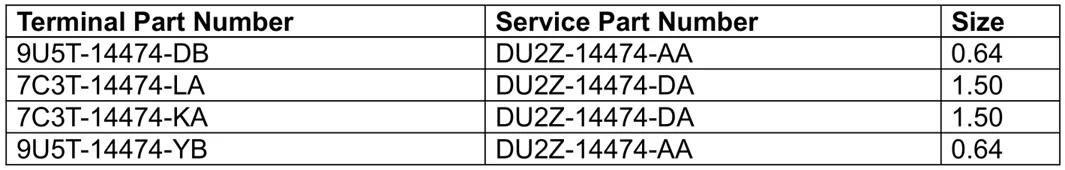

Pins 1,2,16,17 Female Terminals: DU2Z-14474-DA, or Molex PN 34083-2002 MX150 Cable Seal Female Terminal, 18 - 20 AWG.
Pins 15, 30 Female Terminals: TE Connectivity PN 1924955-3 Desc.: Gen Y 0.64 Female Terminal 20-22 AWG unsealed

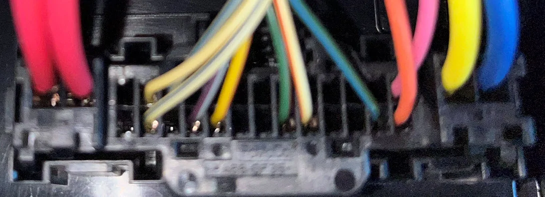

C228B wo heated seat wires
Ford Maverick Heated Seats Install (OEM Factory) in 2023 XLT 1772208094436-lc

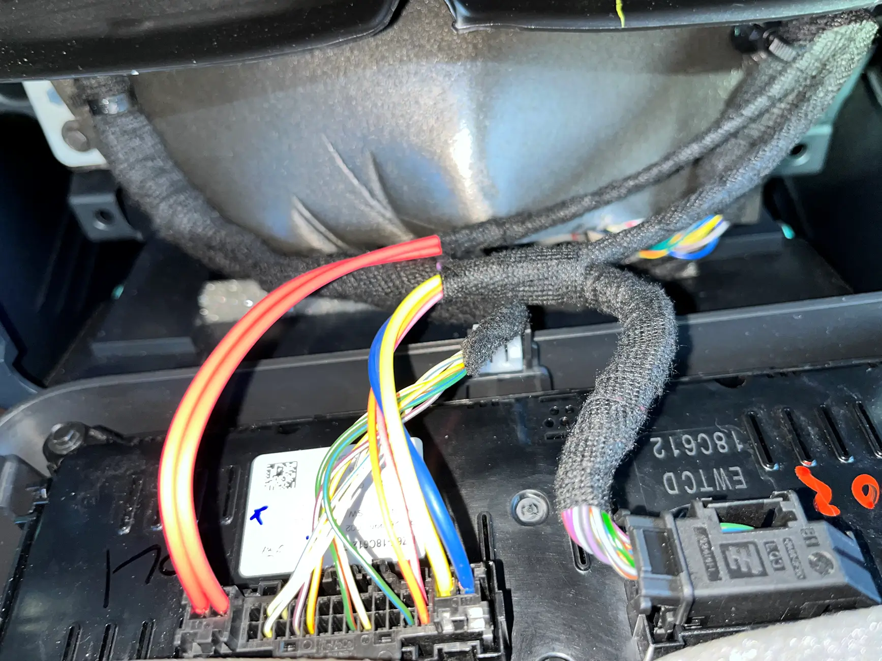

C228B with heated seats wires added:
Ford Maverick Heated Seats Install (OEM Factory) in 2023 XLT 1772208136662-pg

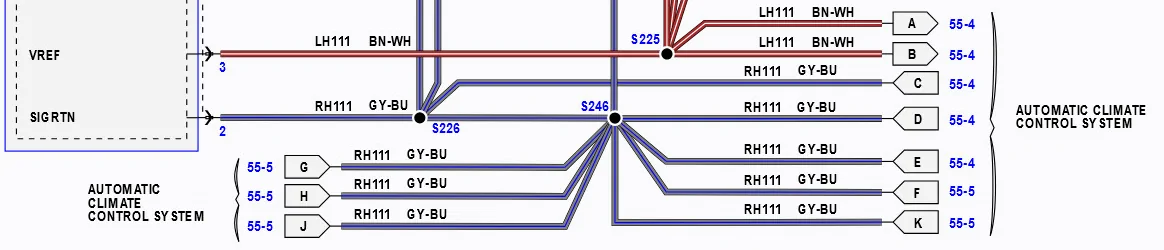

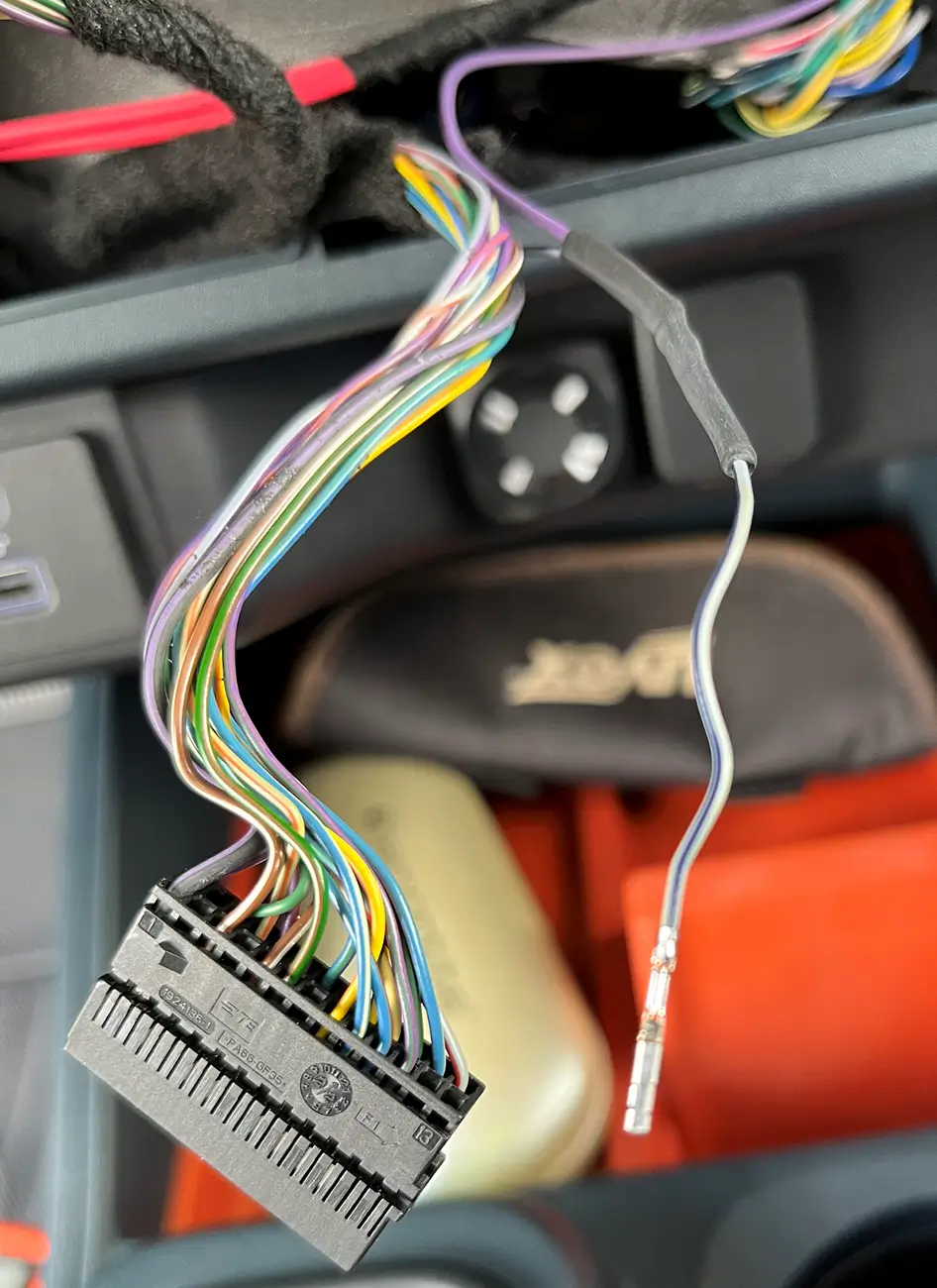

C228A - HVAC Module Connector pin 2 GY-BU Signal Return is for all the HVAC module's sensors.
22 Awg splice for Driver, Passenger NTC temperature sense signal return from the seats.
Added my splice to Ford's existing splices on Signal Return.
Ford Maverick Heated Seats Install (OEM Factory) in 2023 XLT 1772212177106-3h
Signal Return wire removed from C228A pin 2 with added splice for seat NTC sensors.
Ford Maverick Heated Seats Install (OEM Factory) in 2023 XLT 1772211967744-bz

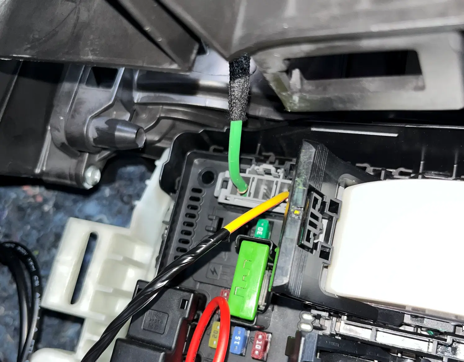

BCM Fuse 7 C2280C pin 1 to splice for (2) 16 Awg Red to HVAC C228B pin 1, pin 2
Used a pigtail with female terminal from WPT-1778 (BLACK) as it cost less than WPT-1777 (GRAY).
The female terminals in both pigtail kits are the same.
The Black, Gray connectors are keyed different.
BCM Fuses F7 30Amp on C2280C pin 1 and F14 30Amp on C2280C pin 2 are hot all time.
On a Lariat these Fuses would be for DDM/PDM that my XLT doesn't have.
I replaced the F7 30A fuse with a 20A Micro2 fuse since heat pads amp draw max is just over 13 Amps with both Drive & Passenger set to High at the same time.

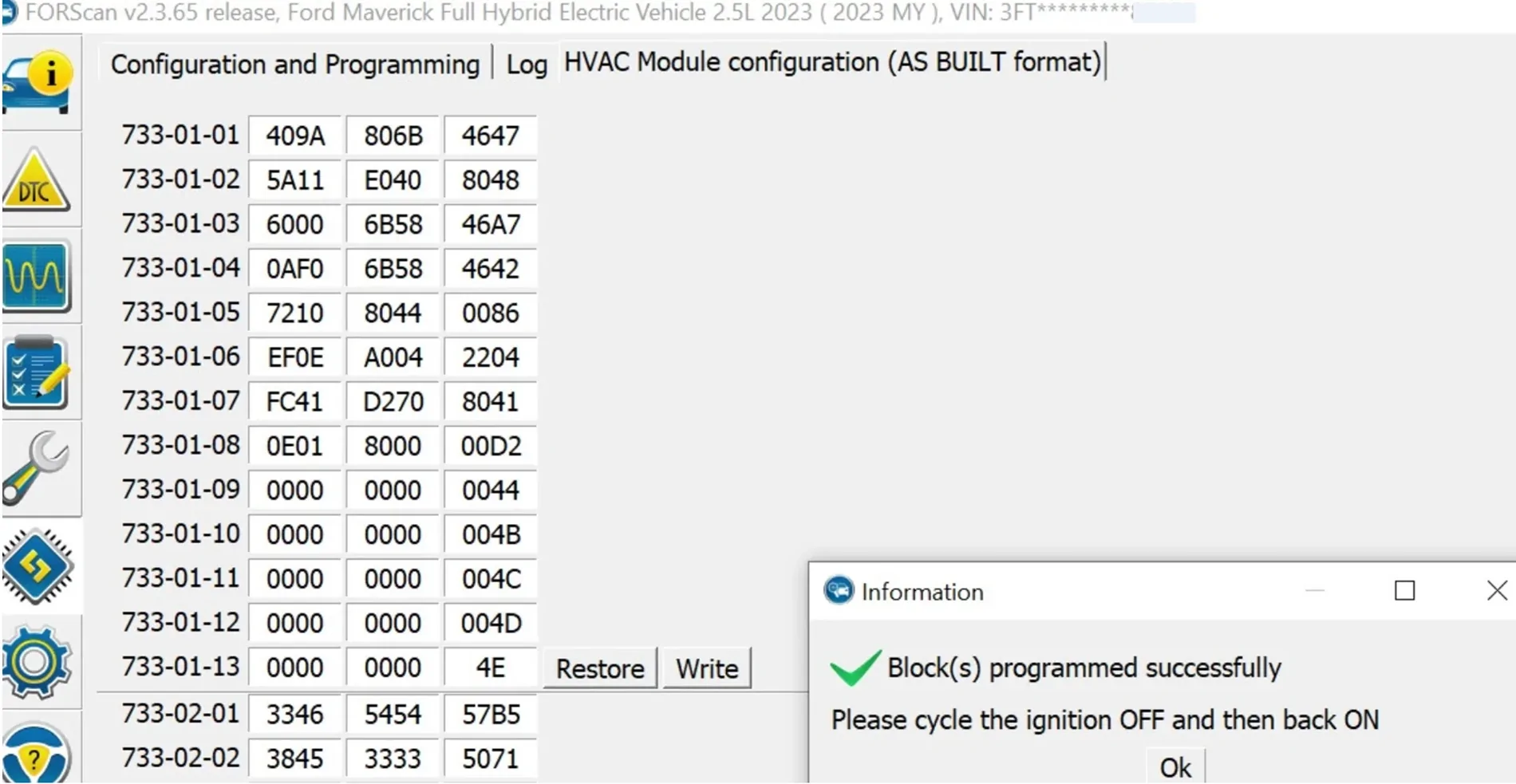

Forscan HVAC Module settings for Heat Seats
Saved original my XLT HVAC As Built. Removed the XLT HVAC module.
Installed the HVAC w Lux module. Saved the HVAC w Lux Package As Built.
Used the "As Built Compare utility" to compare HVAC As Built without Heated Seats to HVAC with Heated Seats As Built.
Used Livinitup 2023 Maverick Forscan sheet for HVAC config settings info.
Wrote my original HVAC's As Built into the HVAC with Lux module, then did the As Built edits needed to enable Heated Front Seats.
Forscan Changed 723-01-01 thru 723-01-07 for Heated Front Seats
Ford Maverick Heated Seats Install (OEM Factory) in 2023 XLT 1775618705334-m1
* Temperature Sensor near rearview mirror sets to 50°F after config change(s) written by forscan for a few start/stop cycles till it recalibrates and shows current temperature.
* Wasn't able to make this work in Forscan EZ Mode, so had to do edits in Forscan As Built.

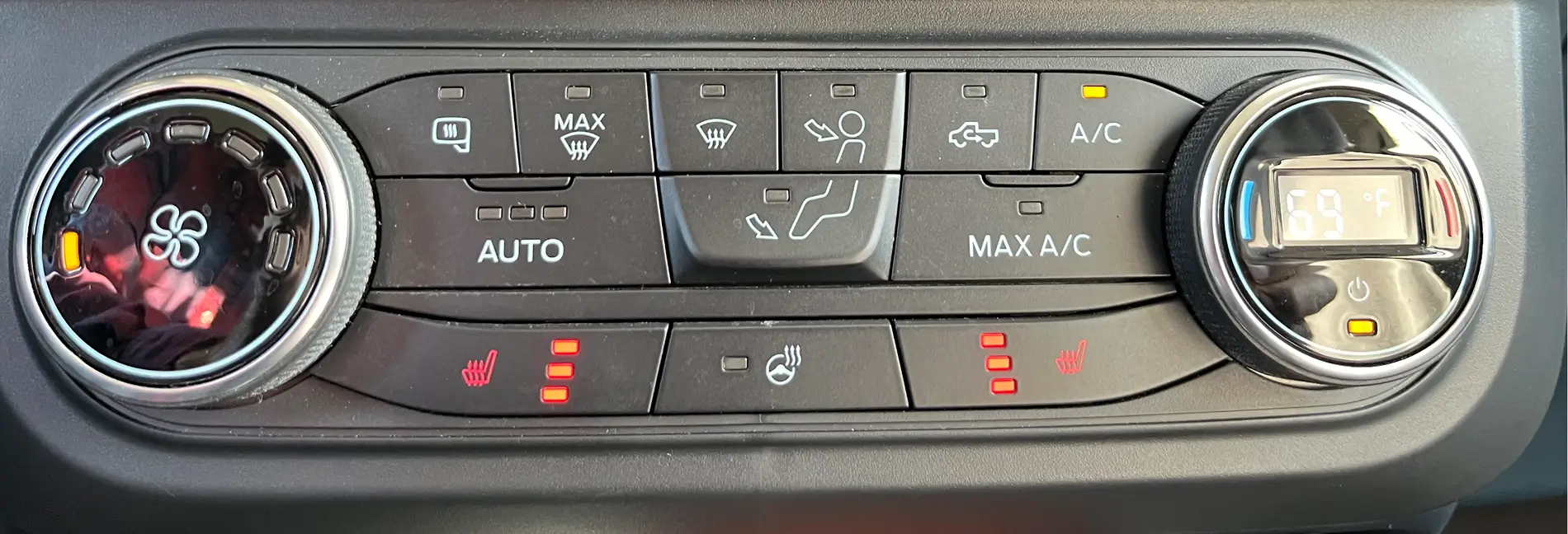

HVAC Module with Heated Seats.
Ford Maverick Heated Seats Install (OEM Factory) in 2023 XLT 1772209496706-xc
HVAC Module connectors: C228B and C228A
Ford Maverick Heated Seats Install (OEM Factory) in 2023 XLT 1772211228229-aq

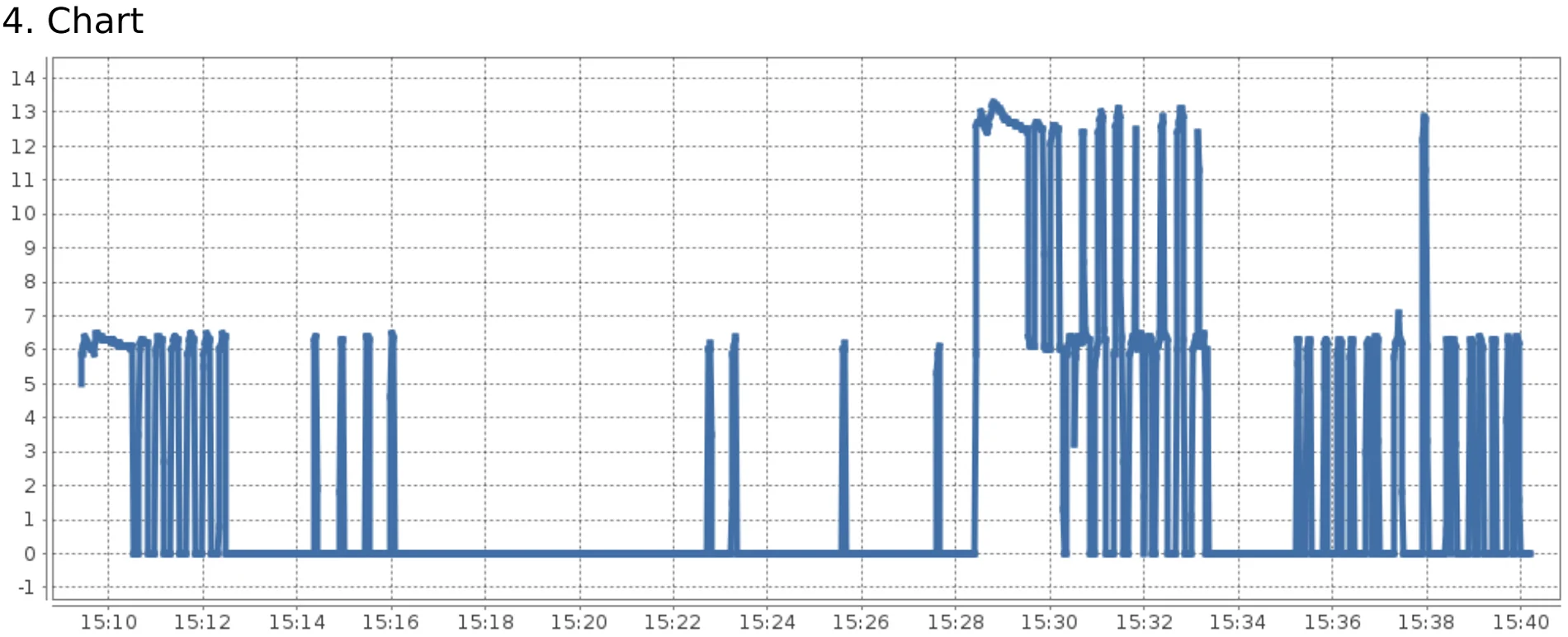

Heated Seats Amps measured with a clamp meter on F7 20A Fuse to HVAC C228B pins 1, 2 :
Driver seat on High, then switched to Medium, then to Low, and then both seats On.
12V is switched On/Off to the heat elements to maintain temperature set point.
On High the 12V is switch On/Off frequently, then less often on Medium, even less on Low setting.
6 Amp draw from one seat Series connected Seat Cushion pad and the Seat Back pad.
The seat cushion (bottom) pad contains the NTC temperature sensor.
Both Seats set to High at same time can see 13 Amps draw from F7 fuse.

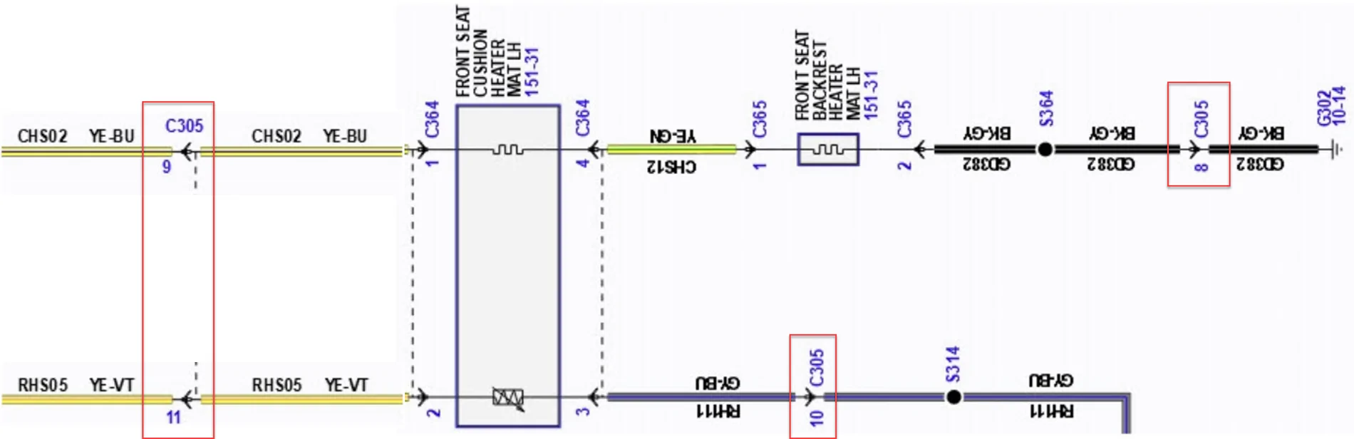

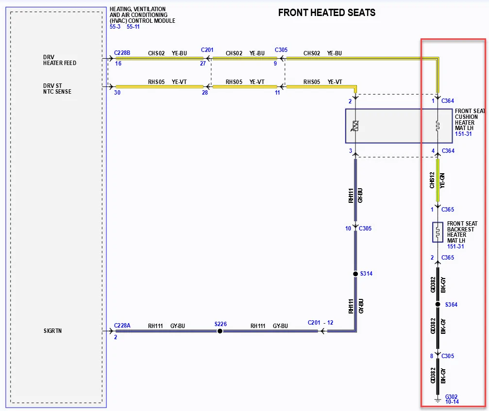

Both Driver C305 & Passenger C331 Molex MX150 Connectors use pins 9, 10, 11 for the heated seats along with existing Ground on the Body Harness side of the connectors on Pin 8.
Driver Seat Heat Wiring:
Heat Elements: 12V from HVAC Module to C305 pin 9 thru both elements to Ground C305 pin 8.
Temperature Sense: HVAC module to C305 pin 11 -> NTC sensor in seat bottom element to C305 pin 10 to HVAC common Signal Return C228A pin 2.
Ford Maverick Heated Seats Install (OEM Factory) in 2023 XLT 1775619719001-1q
Driver Heater Feed (CHS02, GD382) @ Seat:
C305(F)<<C305(M)p9--RD-->C364(M)p1>>C364(F)p1--RD--Cushion Element--BK--C364(F)p4<<C364(M)p4--BU->C365(M)p1>>C365(F)p1--BK--Back Element--BK--C365(F)p2--BK--C305(M)p8>>C305(F)p8--->G302 Ground
Driver NTC Sense (RHS05, RH111) @ Seat:
C305(F)<<C305(M)p11--VT-->C364(M)p2>>C364(F)p2-GY--NTC--GY--C364(F)p3<<C364(M)p3--OR-->C305(M)p10>>C305(F)p10-->SIG RTN (HVAC) Control Module

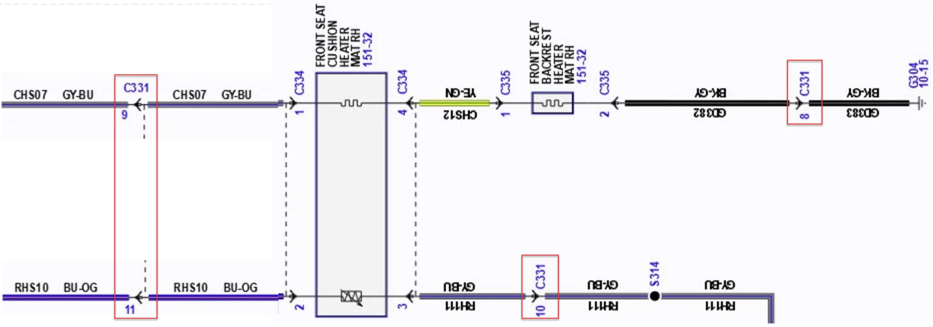

Passenger Seat Heat Wiring:
Heat Elements: 12V from HVAC Module to C331 pin 9 thru both elements to Ground C331 pin 8.
Temperature Sense: HVAC module to C331 pin 11 -> NTC sensor in seat bottom element to C331 pin 10 to HVAC common Signal Return C228A pin 2.
Ford Maverick Heated Seats Install (OEM Factory) in 2023 XLT 1775620274922-uv
Passenger Heater Feed @ Seat:
C331 Pin 9 = C334 Pin 1<-->Front Seat Cushion Heater Mat RH<-->C334 Pin 4<-->C335 Pin1---Front Seat Backrest Heater Mat LH--C335 Pin2<-->C331 Pin 10<-->G304 Ground
Passenger NTC Sense @ Seat:
C331 Pin 11<-->C334 Pin 2<-->NTC<-->C334 Pin 3<-->C331 Pin 10<-->SIG RTN (HVAC) Control Module
Run my harness along existing harness that goes up above and down toward RH side of floor console.
Then ran harness in the floor console. Y off to each seat just behind front mount bolts & up where existing body harness is for each seat.
Removed existing body harness heated wires and installed my wires from the HVAC module.
Seat Heat Pads:
Driver Seat Cushion
Driver Seat Back
Seat C305 Molex Connector w heat harness wires:
Seat Body Harness Molex connect with HVAC wires on left, replaced wires on right
C228B Terminals
C228A - HVAC Module Connector pin 2 GY-BU Signal Return for HVAC module's sensors.
22 Awg splice for Driver, Passenger NTC temperature sense signal return from seats.
Added my splice to Ford's existing splice on Signal Return
Used a pigtail with female terminal from WPT-1778 (BLACK) as it was less than WPT-1777 (GRAY). Bought with fordpass points.
30A F7 pin1, F14 pin2 hot all time on C2280C are for DDM/PDM that my XLT doesn't have.
Saved original HVAC As Built, Saved HVAC w Lux Package As Built
As Built Compare utility to compare HVAC As Built without Heated Seats to HVAC with Heated Seats As Built
Used Livinitup 2023 Maverick forscan sheet for HVAC config settings info.
Wrote original HVAC As Built into HVAC w Lux
Forscan Changed 723-01-01 thru 723-01-07 for Heated Seats
* Wasn't able to make this work in EZ Mode, so had to do As Built.
Heated Seats Amps on 12V F7 to HVAC pins 1, 2 :
Driver seat on High, then switch to Medium, then to Low, and both seats On.

8 GD382 (BK-GY) 12 97BG-14474-BFA Driver Heater Backrest <--> Ground
9 CHS02 (YE-BU) 22 97BG-14474-BDA Driver Heater Mat, Backrest Mat Feed <--> HVAC Control Module
10 RH111 (GY-BU) 22 BU5T-14474-UA Signal Return (NTC)
11 RHS05 (YE-VT) 22 BU5T-14474-UA Driver Seat NTC (Thermistor) Sense <--> HVAC Control Module
