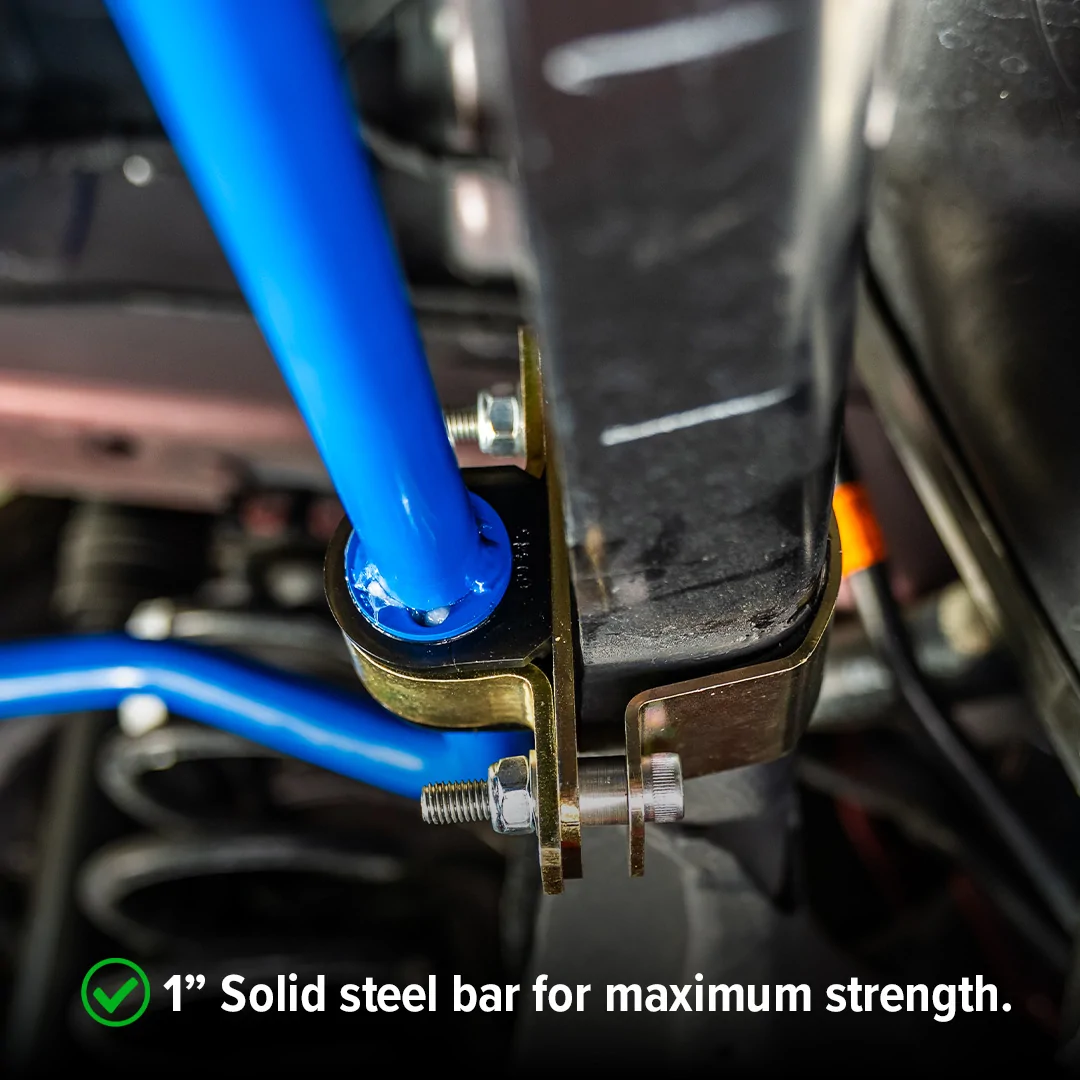

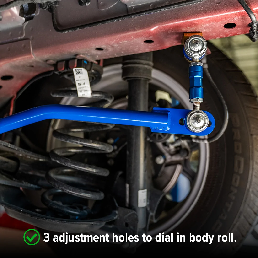

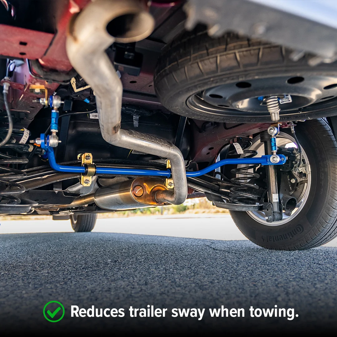

We’re excited to share that our Steeda 555-1046 Maverick FWD Rear Sway Bar (22-26) is officially here! This upgrade is built specifically for the FWD platform to deliver a serious improvement in stability, responsiveness, and overall driving confidence.
What It Does
This sway bar is engineered to reduce body roll and keep the rear of the Maverick planted, giving the truck a more neutral, predictable handling feel. It will help your Maverick stay composed during daily driving, carving backroads, towing, or carrying heavy loads.
Built to Handle Anything
Proudly designed, engineered, and manufactured in the USA from 1" solid steel, this bar is built to outlast your Maverick. CNC-machined billet steel ends deliver superior strength over stamped or coined alternatives, while the signature Steeda blue powder-coat fights corrosion.
Adjustability For Any Driving Style
Take control of your Maverick's handling with three-way adjustability that lets you dial in the perfect feel. Start in the middle hole for balanced daily driving, then stiffen for track days or soften for comfort. The result is a more sportier feel in a compact truck package, making every drive more engaging and enjoyable.
