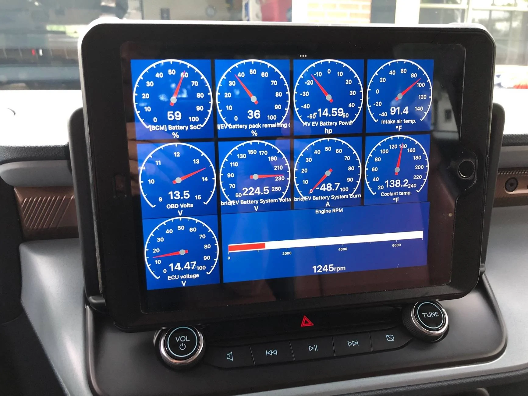

This will tell you about your Hybrid voltages. CarScanner app on old iPh6 & OBDII dongle.
Ford Maverick Extra Dashboard Instrument Gauge Installed IMG_1812
Wow - really puts the smaller screen in perspective when an old iPhone is that much bigger!
iph6 was a misstatement & has been corrected. It‘s an iPad.

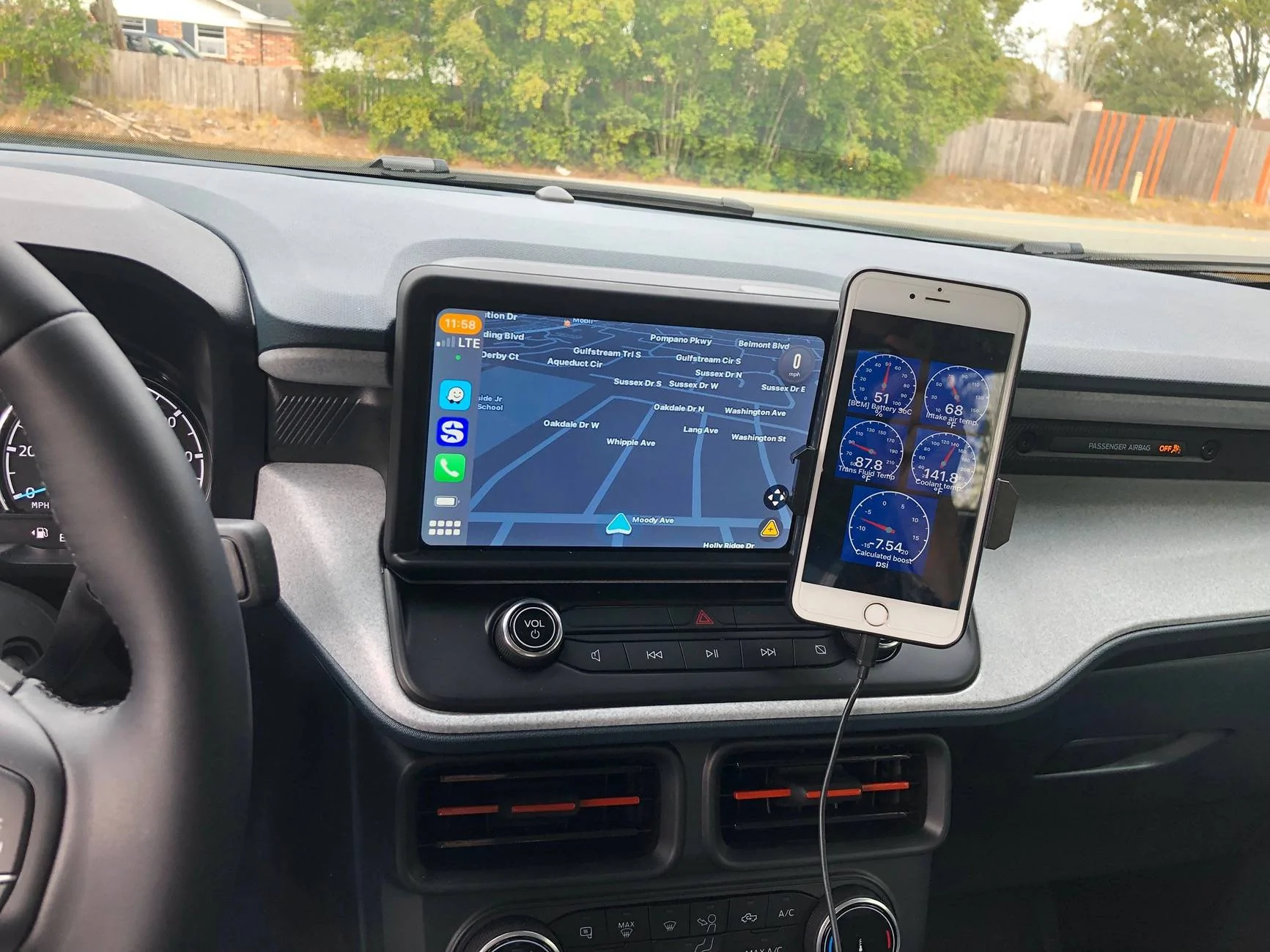

This one is the iPh6.
Ford Maverick Extra Dashboard Instrument Gauge Installed IMG_1920
