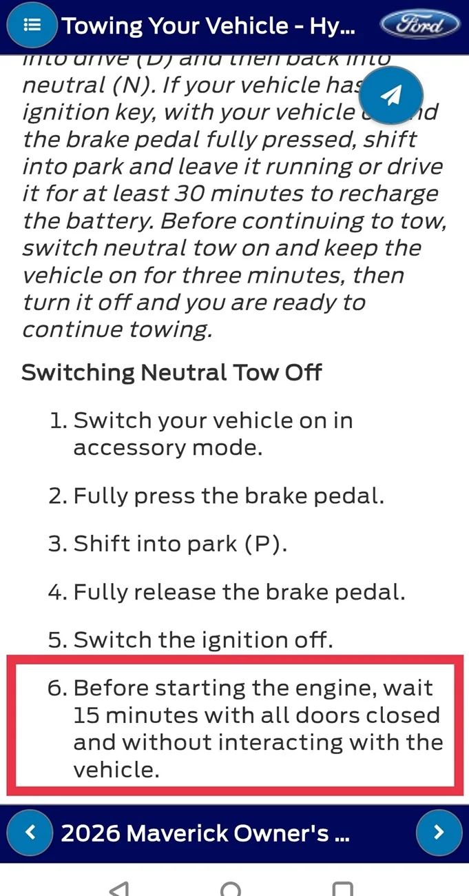

I follow the 6 hour rule with my 2025 AWD hybrid when planning on towing for longer than that time..
My question to 25 and 26 owners who flat tow: Is it necessary to follow the 15 minute rule when taking it out of neutral tow, BEFORE I start it and run it thru the gears? I have been, but it does add that 15 minutes to the process. Is it necessary? It clearly states wait 15 minutes before starting the engine without interacting with the vehicle before starting it. You can't cycle the gears without starting the engine if it is for lubrication. Has anyone gotten clarification for this from Ford? Do you wait the 15 minutes?

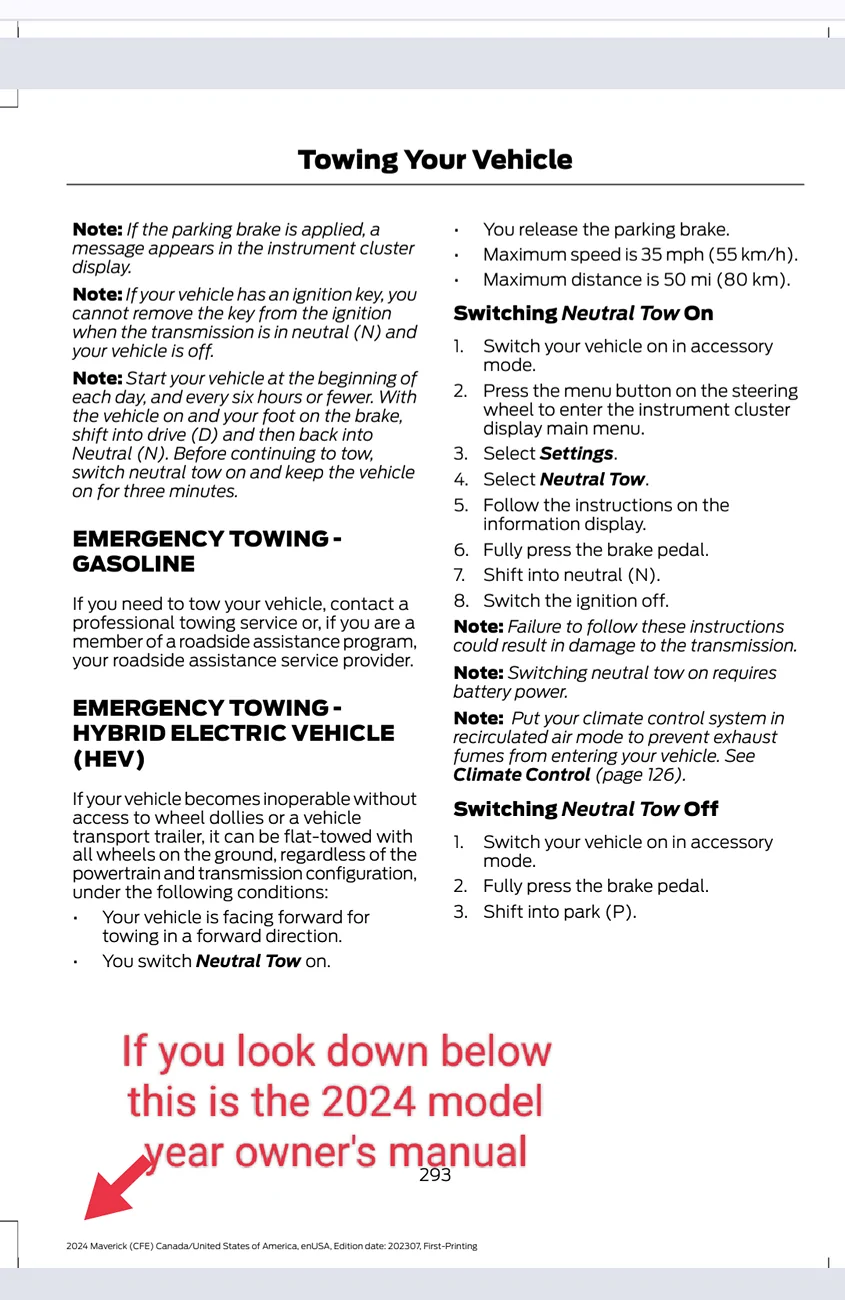

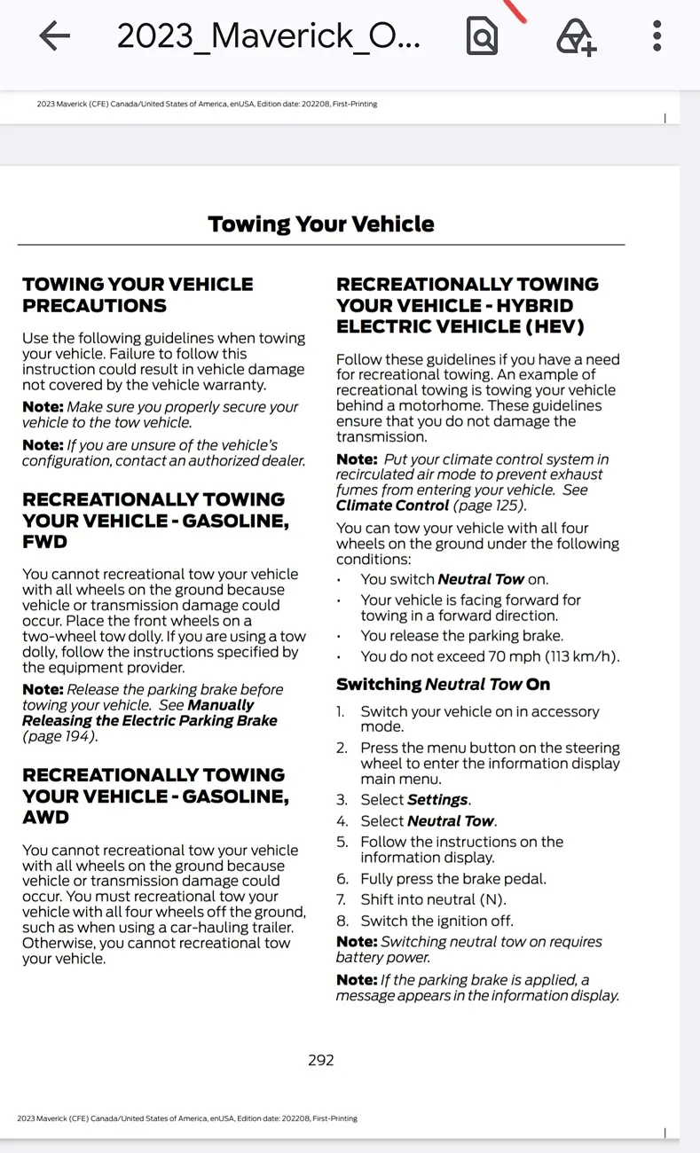

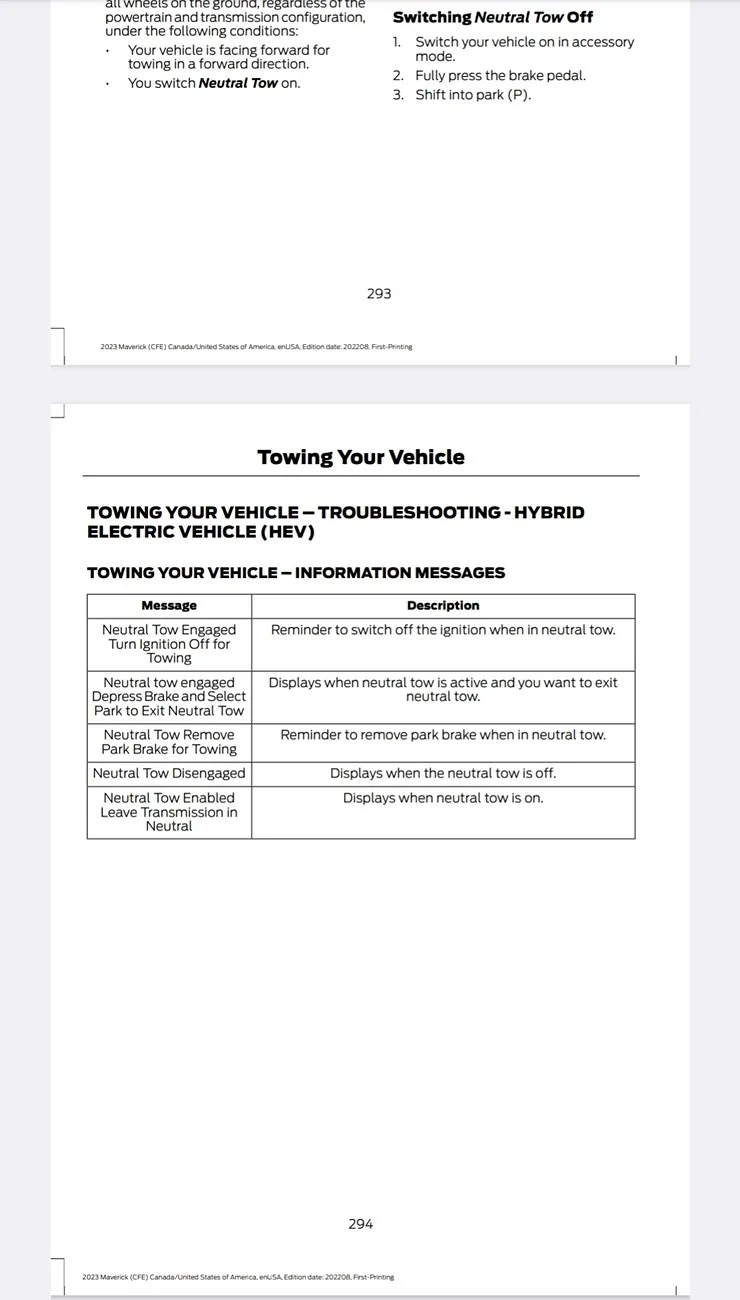

When I look through my 2023 owner's manual. I find no reference to the 15 minute wait.
As you can see the procedure is not carried over onto page 294 of the 23 manual.
Ford Maverick 6 hour rule when Flat towing for 2025-26 AWD Hybrids & 15 min. wait before starting the engine Screenshot_2026-07-08-08-48-52-36_e2d5b3f32b79de1d45acd1fad96fbb0f
Ford Maverick 6 hour rule when Flat towing for 2025-26 AWD Hybrids & 15 min. wait before starting the engine Screenshot_2026-07-08-08-49-15-59_e2d5b3f32b79de1d45acd1fad96fbb0f
Ford Maverick 6 hour rule when Flat towing for 2025-26 AWD Hybrids & 15 min. wait before starting the engine Screenshot_2026-07-08-09-04-18-73_e2d5b3f32b79de1d45acd1fad96fbb0f
But yet, it has been added to the 2025, 2026 owners manual's.🤔

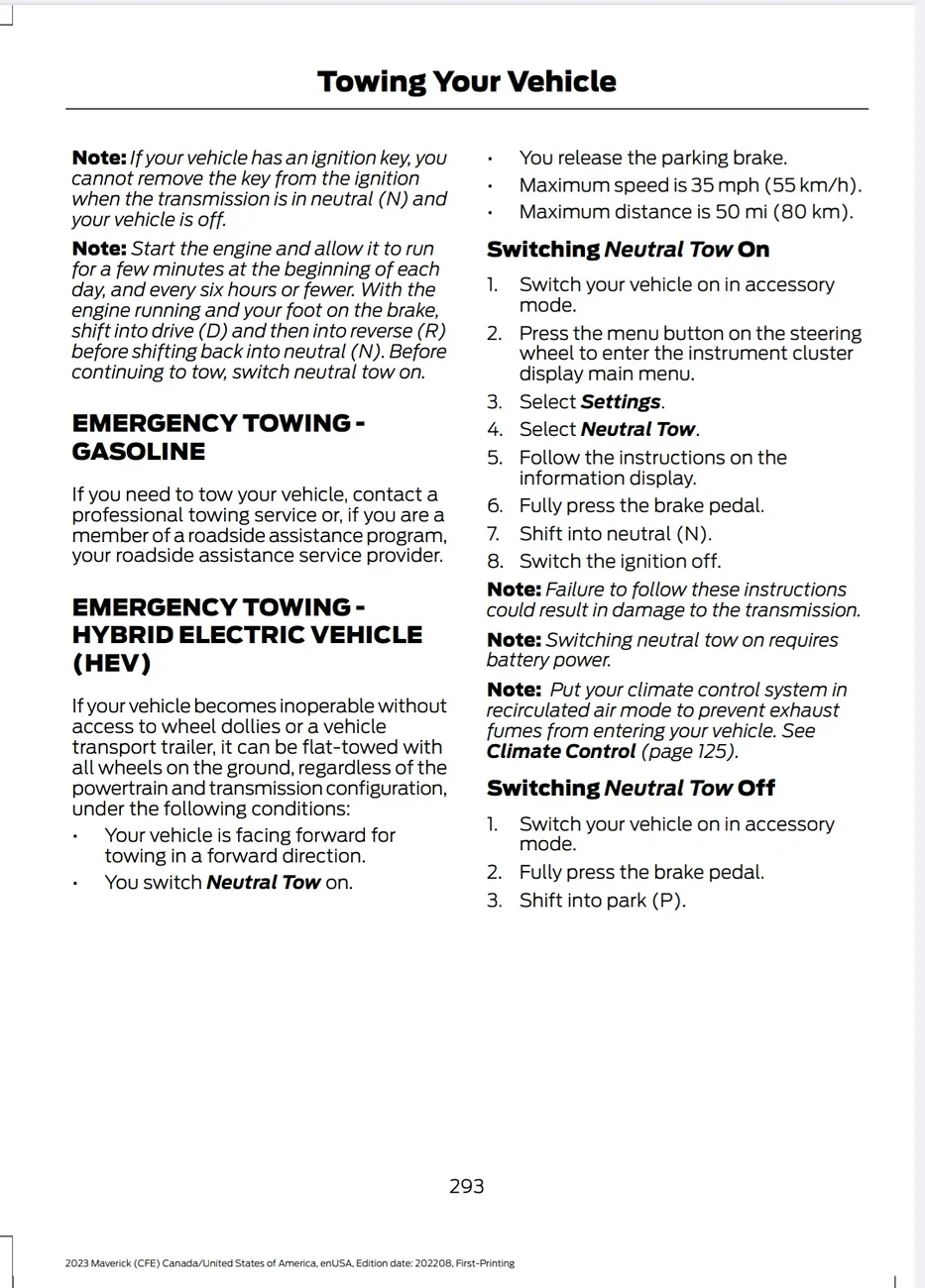

That procedure was not in the previous 22, 23, 24 manuals.
Update edit. I downloaded the PDF 2024 owners manual.
There must have been a reason they added the procedure starting in 25.
Out of an abundance of caution or they found a problem?
I have to ask the question. If it didn't make a difference, why add it now?

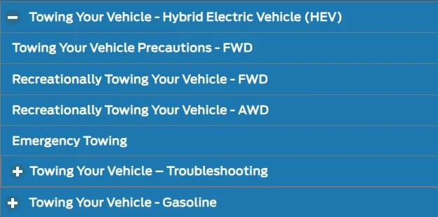

Well - the online 24MY manual is pretty stupid for layout - who'd have thunk it!
Ford Maverick 6 hour rule when Flat towing for 2025-26 AWD Hybrids & 15 min. wait before starting the engine 1783540447099-w2
There is no 24MY AWD Hybrid.
And when you click on that section - says it can't be done for gas engine.
Then why is it under HEV!!!
Also - the section on switching it Off - is ONLY under Emergency Towing, nothing under the Recreationally section with how to turn it On. So that's pretty lame.

I just got done downloading the pdf. 2024 owners manual. The instructions for recreational towing of the hybrid are exactly the same as they are for the 2023.
Ford Maverick 6 hour rule when Flat towing for 2025-26 AWD Hybrids & 15 min. wait before starting the engine IMG_20260708_133251
As @ZeroDay
Pointed out in post #5
Procedures to turn off the recreational tow for 2025-2026 were probably due to changes in the 2025-26 transmissions.
