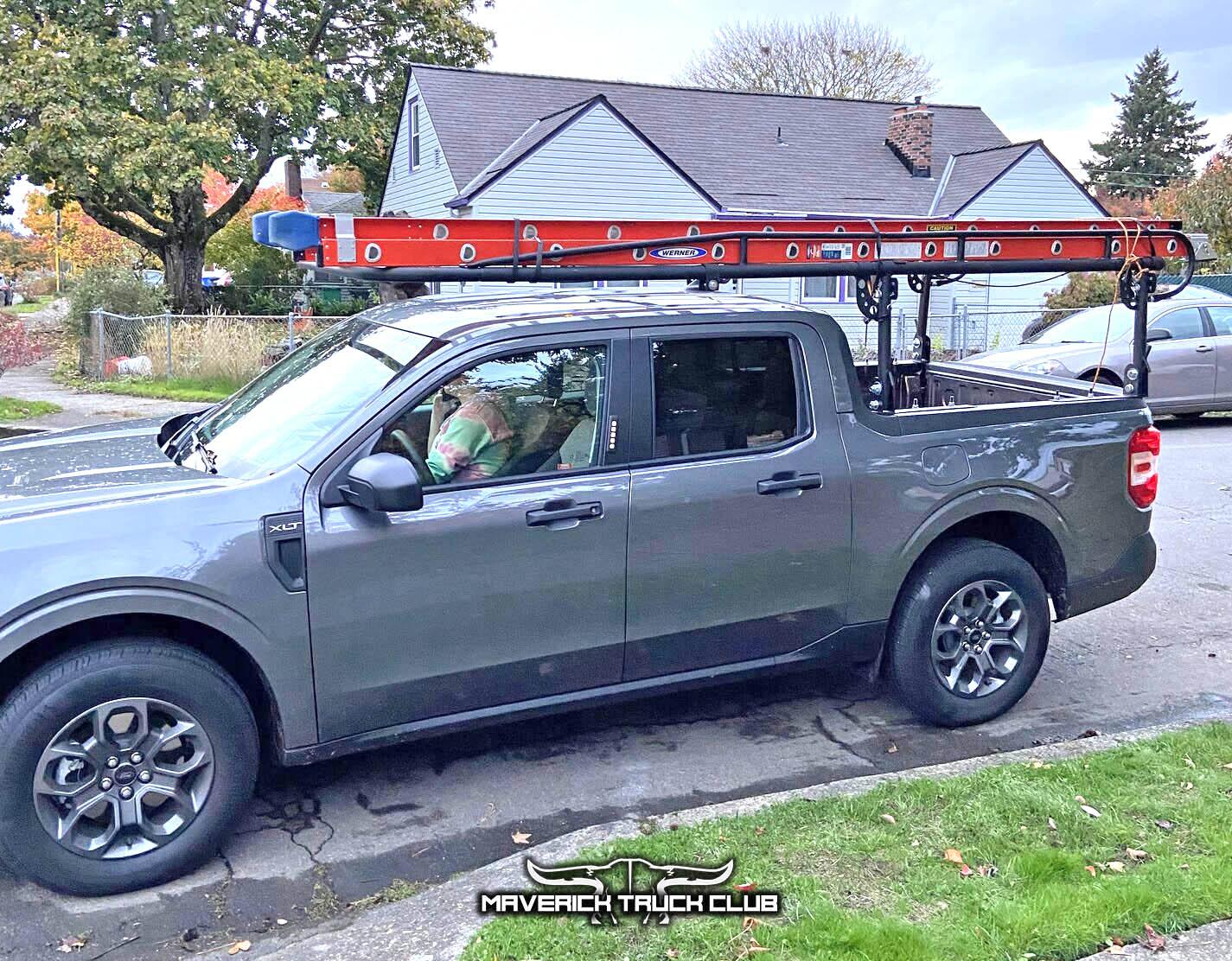

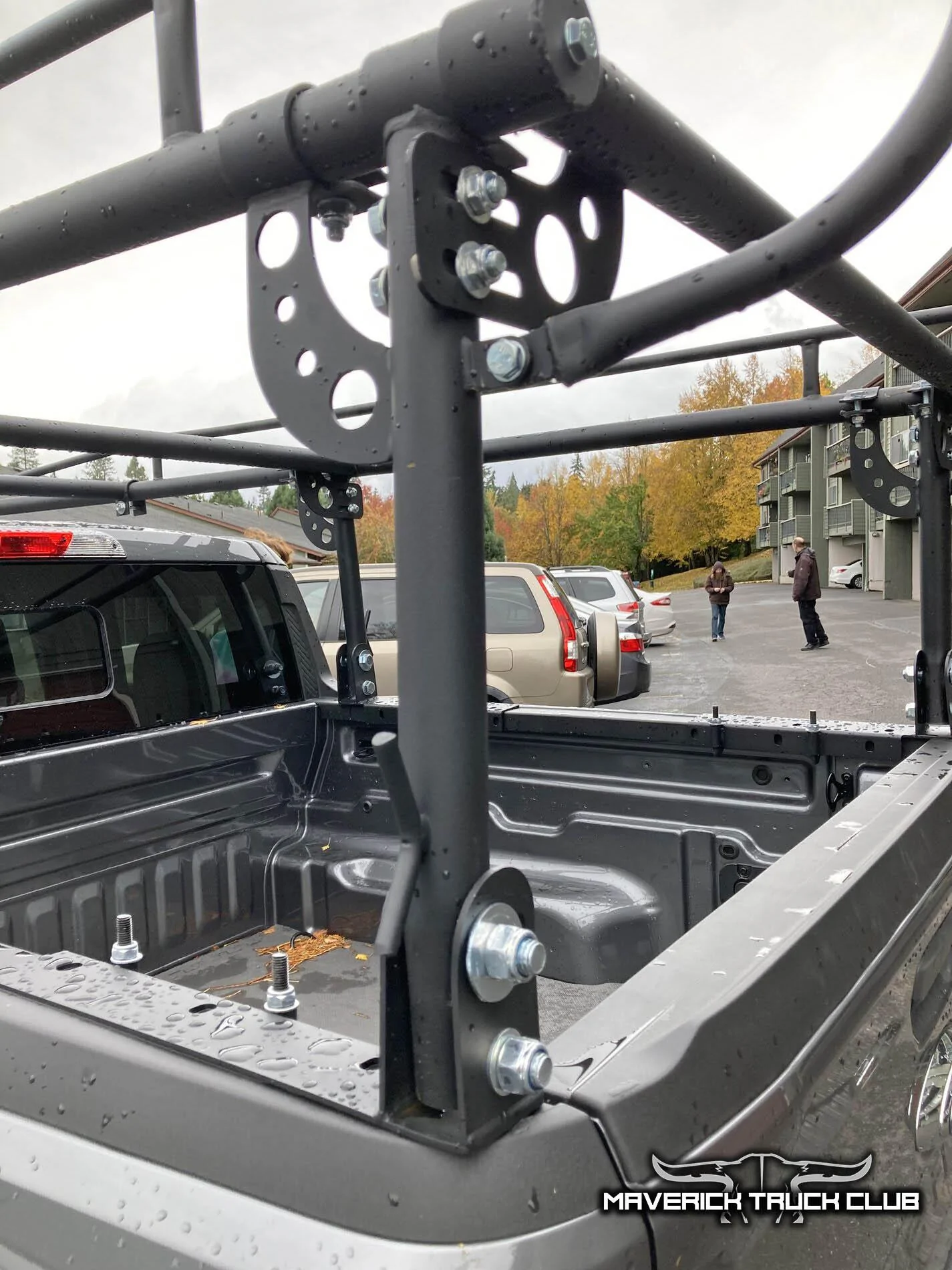

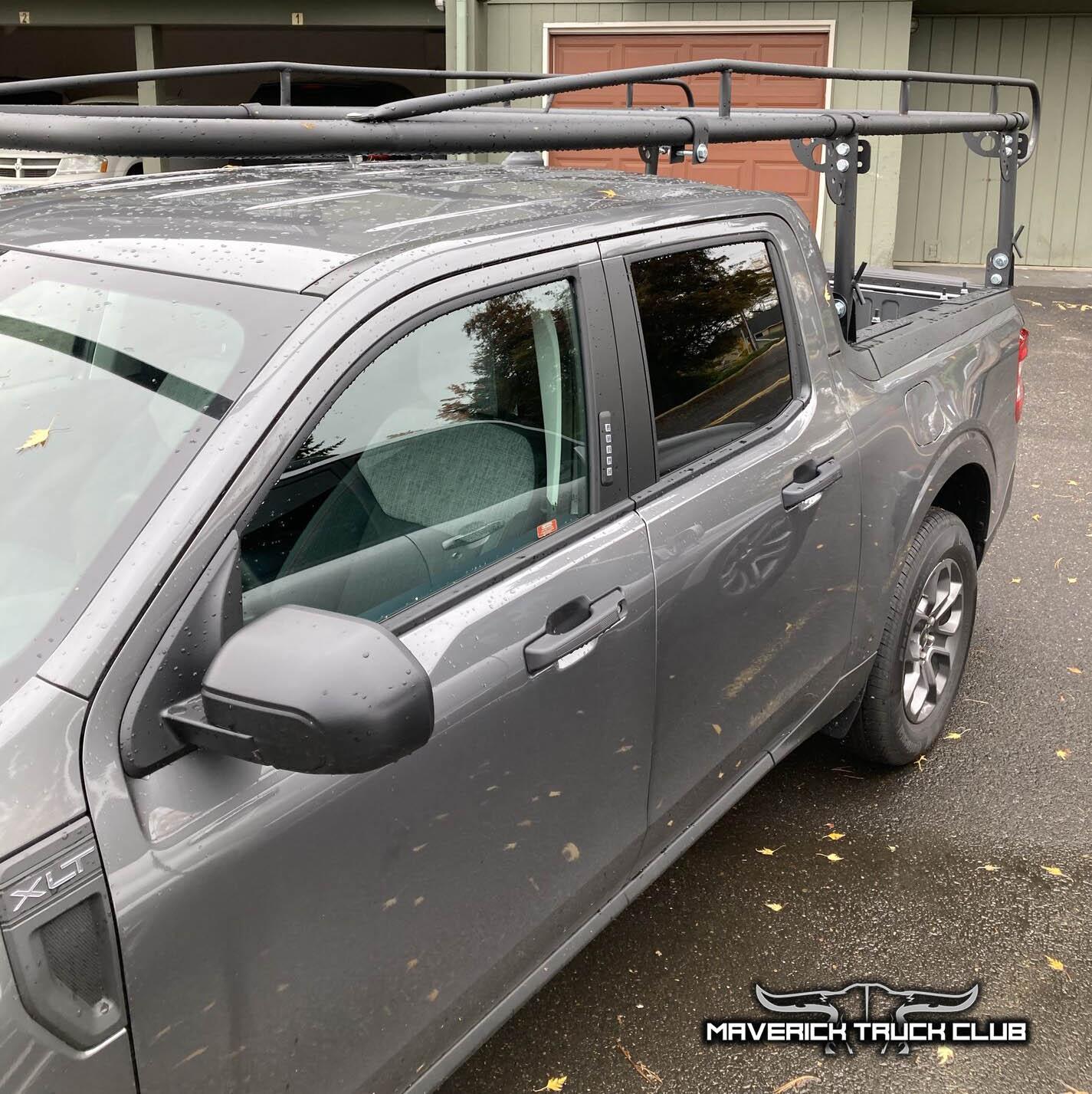

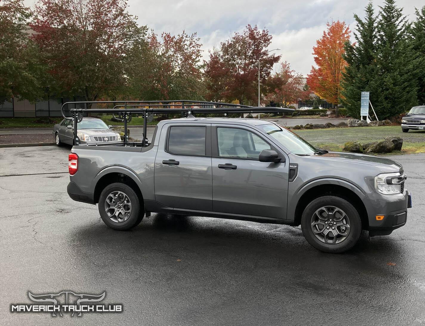

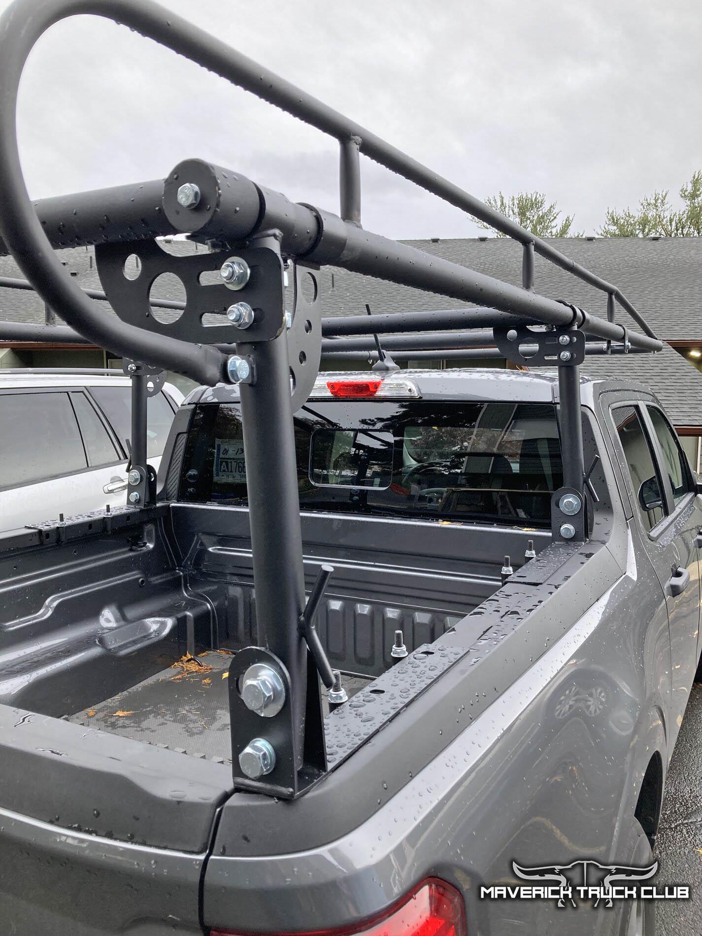

Just installed a ladder rack on my XLT now it’s a work truck! Lots of modification needed, welding cutting and grinding to get it to fit.
Ford I wish the bed rails were more friendly to truck bed accessories. Only the expensive Yakima racks fit out the box that I know of. Also wish rails on top of the cab were installed to make it easy to add too. It’s a truck and we want to use it to carry stuff otherwise we would be in a sedan! Also just wanna say I absolutely love my Maverick except for that.
Updated 10/26 with more photos and details:

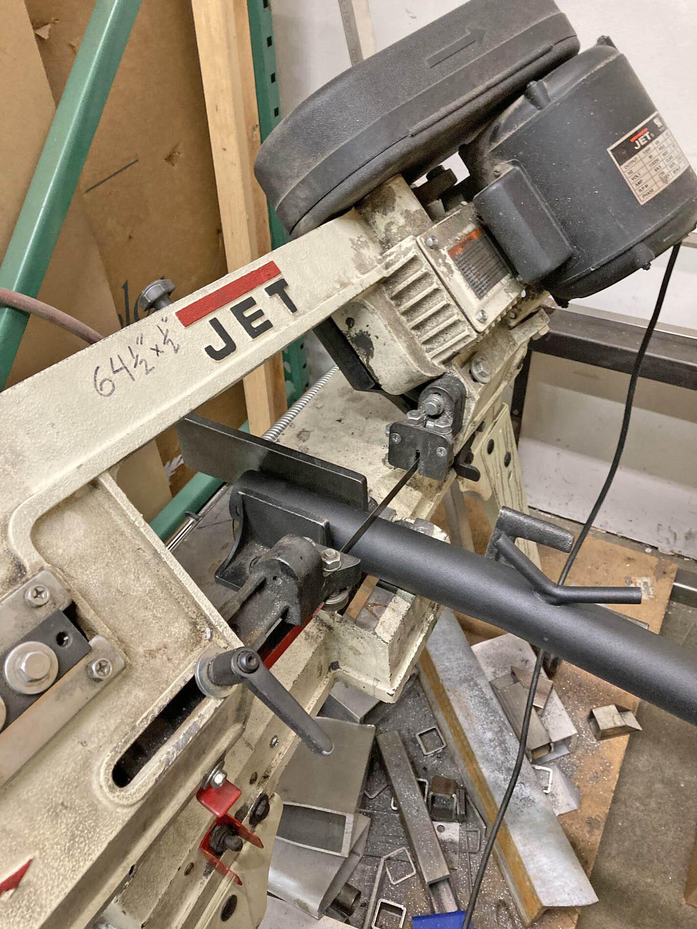

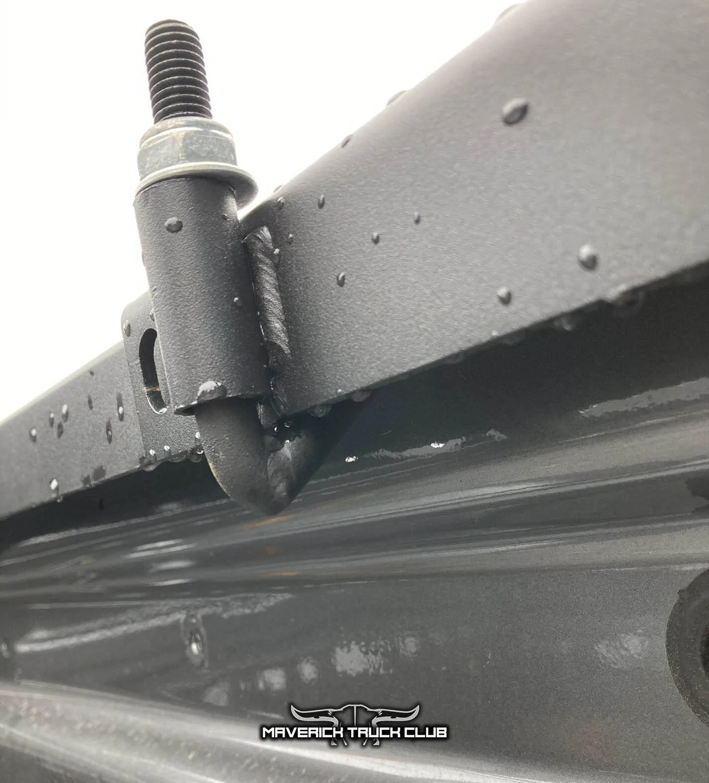

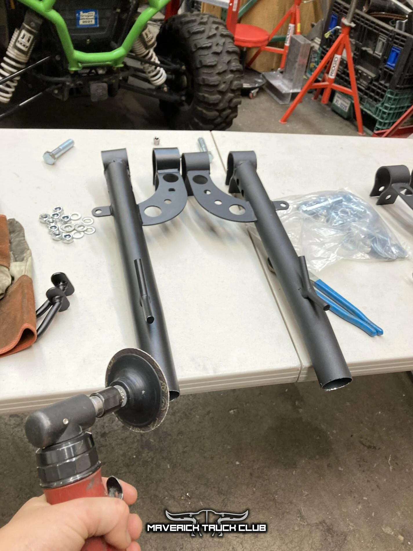

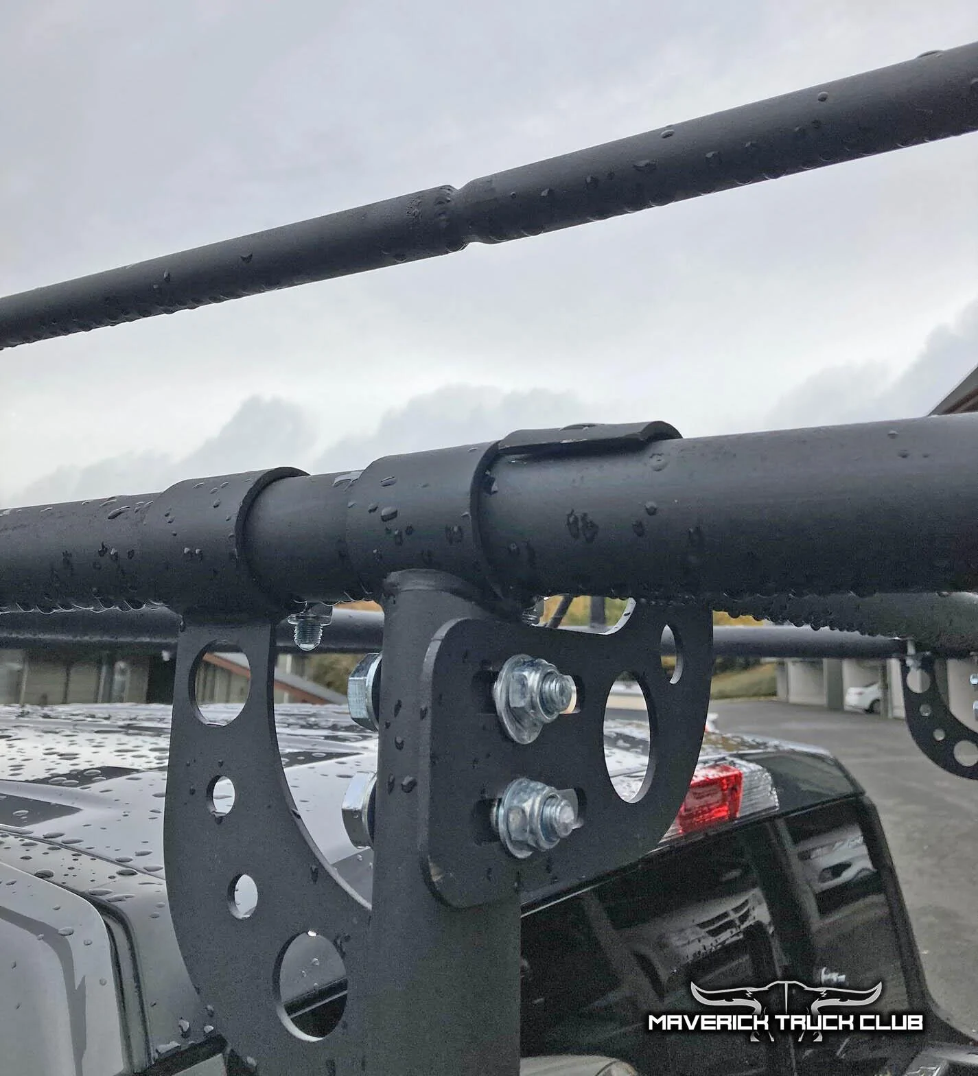

This is how we got it to fit!! -- I bought a universal rack for my truck rated to carry 1000lbs. We needed to cut and weld back together the clamps to make them fit. We had to shorten the height of the rack by sawing off about 6” from each of the vertical pieces then drilled new holes. This part was difficult as the parts are not straight for measuring or clamping in the drill press. We welded the top side pieces also as the verticals closest to the cab went right over the seem which were supposed to have a bolted clamp holding them together.
Then it was a case of bolting it all together. It took about 6 hours. Feels pretty solid.
The ladder pic is with a 24’ ladder. Getting my 28’ on it soon.

I think that really looks sharp and very professional. What rack did you start with to modify?
MakinDoForNow
Sep 24, 2021
8,478
6,044
Looks like my harbor freight 289.00 one (4 years ago), Chinese imports northern tool and others have them. Are made for universal fit and will require flex bedding workout. I have one on frontier. Was afraid of it's short bed but worked great only carry two ladders one 28'. I think I would cut front over hang little shorter but if you have 28'/32' fiberglass ladder = nope. Just watch weight on front closely. Dam, may have to go buy 3rd XLT.

Thanks for the Info, I sometimes need to haul 12 or 14 foot lumber and was looking for a solution. Do you think this rack can be used with a tonneau cover?

Nice. How does that work over the cab? does anything support it? What is the weight limit?

Updated with more photos and details:

Did you have to narrow the the width of the rack to mount on narrower bed? If so how much and how many places? If not, how come? The web says it’s 60” wide and I think the bed is less than that, right?

Don't forget to shoot some rustoleum to the bolt heads and connection points. Its going to rust, and it will rust.
