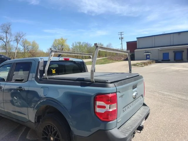

Hi everyone, I had my Maverick Hybrid for a while now and been using the bed for everything from wood to dirt and camping.
Last thing I needed is a way to haul some 2x10 longer than 8ft without having 6 feet hanging from the back and keep the backup cam.

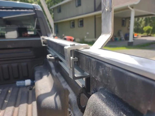

I also wanted not to be bolted and drill hole. I use the same clip that came with my tonneau cover from truxedo truxsport.
Ford Maverick Custom bed ladder/pipe rack Maverick-bed-rack
I had some spare aluminum flat bar from a old factory tear down and made myself a bed rack that can hold far more than what I would put in it.
On one bar I can 250lbs with the rack so I assume the rack could be good for at least 500lbs.
Mine still need to have a cross bar from the front to the back
The V2 is on the way as a neighbor asking for one to be build in the next week.
If I have enough demand, I could make more this summer.

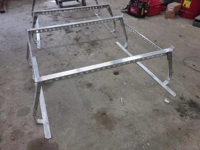

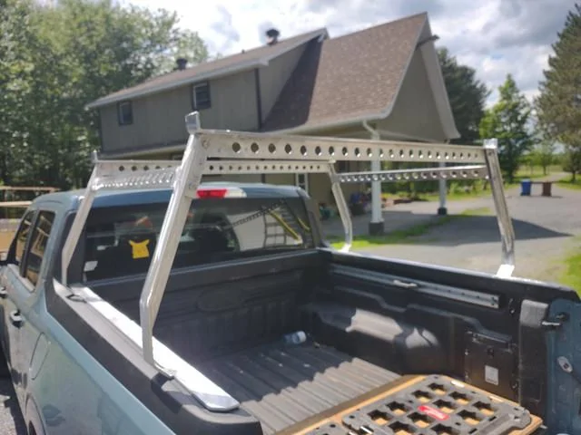

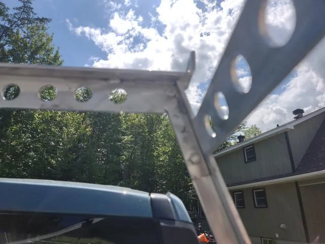

Hi back, here are more picture of the version 2. I met another maverick owner and ask me to replicate the rack.
As i did all the error on the first one, I make him a Version 2 of the same rack. I wanted the rack to be useful and keep my Truxedo tonneau cover.
Actually, it can hold at least 250lbs on one arch. So i could say for safety that the rack can hold 450lbs.
Here more picture before primer. The tie down need to be like the Truxedo but i could make some bracket that would bolt on the inside rail for one that don't have a tonneau cover.

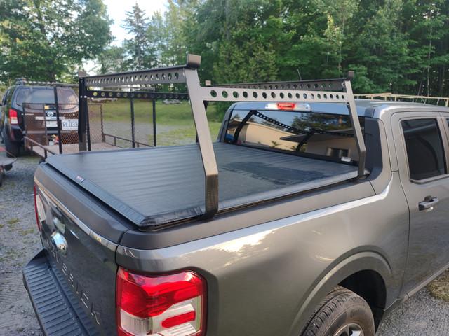

Ford Maverick Custom bed ladder/pipe rack IMG-20220612-143832562
Another One done for someone. Painted with thin bedliner as he will be using it with ladder every day for work.
I figured a way to make the rack with more bolt to have it ship inb a box like the bed tonneau cover.
Contact me for more information.
Location in Windsor Québec.

Ford Maverick Custom bed ladder/pipe rack IMG-20220620-191713120
