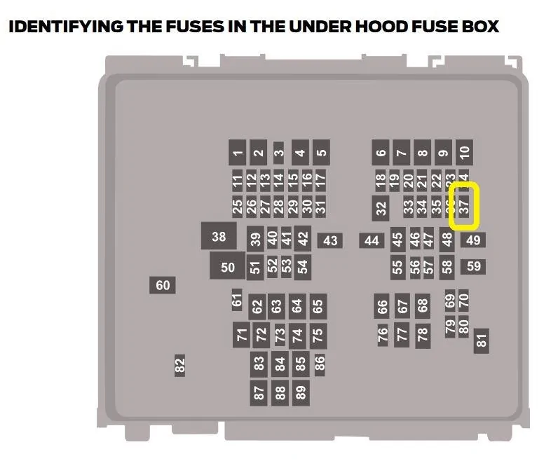

I would start with fuse #37 underhood, that is the trailer tow running lights circuit.

I checked with my Fluke, and I got really low voltage. I also looked under the hood, and the fuse box doesn't have any fuses... Just two large connectors.
Please refer to your Owners manual to see where the fuses are located,,,,

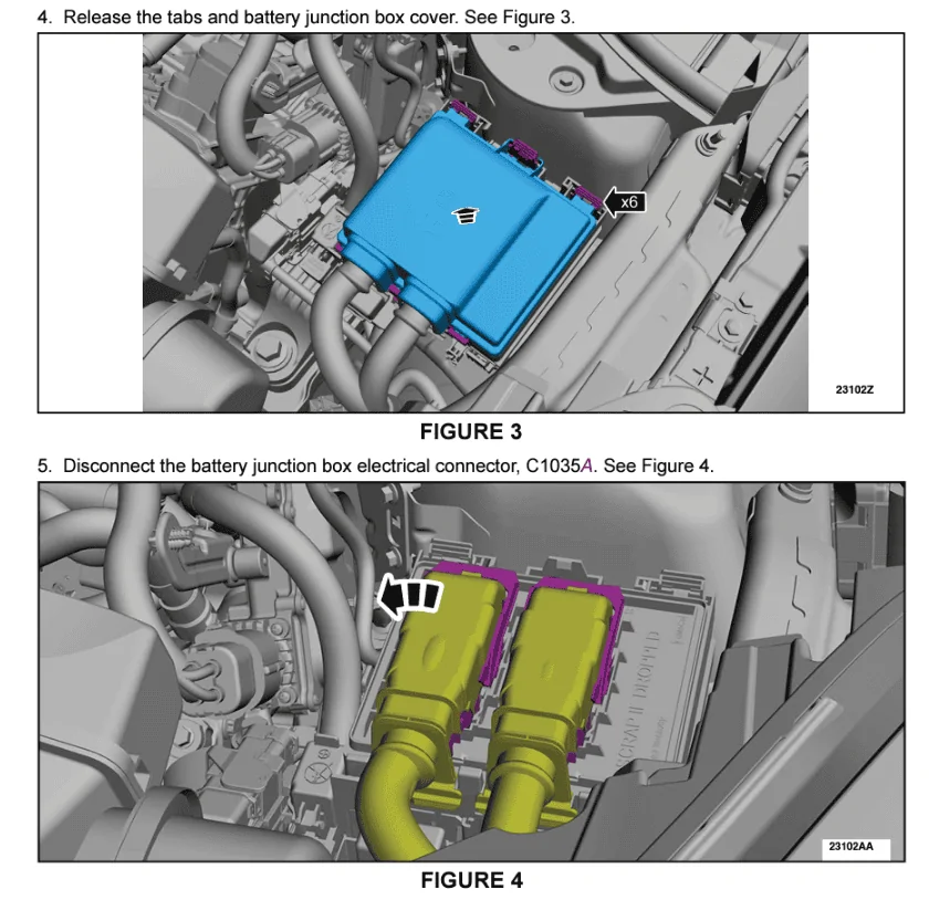

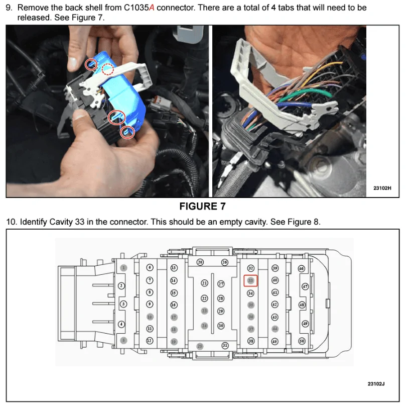

Once you remove the top cover (exposing the two large connectors) the underhood junction box flips open further; the fuses are on the underside beneath another cover.
But you could also remove the large connector closest to the engine and inspect to see if Cavity 33 is populated (Step 9 & 10). That is the wire that is missing on the recall-affected vehicles. You could also remove the cover (Step 9), reconnect the connector, and check to see if that circuit has power when the running lights are on.

Well, checked all of the fuses and verified the wire is present in location 33 of the connector. Still no running lights.
