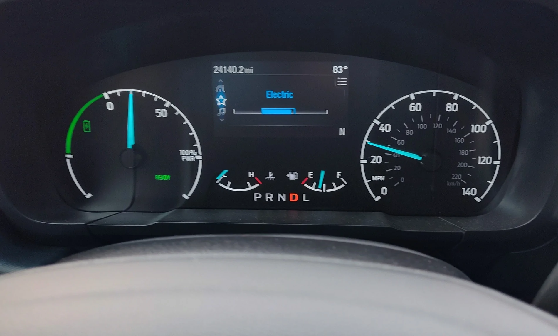

I find you can stay in electric just a tad above the first line, but in normal hit the line and that's it.
Never seen that. 24XLT.
You mean it can be at the top of 10% line, rather than below it?
The Go pedal being eased up may allow you to toe the limit line better, for sure.
But the log files show the same max amps/torque allowed before it enables the ice.
I do find it beneficial on bumpy roads for that effect. Where I could toe the line and make it to the next down section, if it's bumpy it'll cause me to accidentally press that pedal an extra 2% and bam ICE is on, when it was about to be not needed.
But with Eco 2% on Go pedal doesn't do as much.

I have the 24 XL, the gage is different. The difference is real and consistant.
I do believe the higher trims have a different display?
As long as these observations are not from initial start-up, which would then include the sometimes available extra power allowed if HVB is on high end - gotten up to 20% then, in Normal mode.
No, not on startup. And the XL definitely has a different gauge presentation with well delineated marks at 10, 20, 30 etc. percent. But no blue bar.
