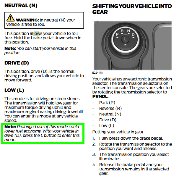

i think i read in the manual that remaining in 'L' for long periods can actually make MPG worse, if i see it again i will post.

I played around with putting mine in low. But then I found when I have it in Eco mode that it pretty much does the same job as putting it in low. I can feel it braking more in Eco mode vs other modes. I would think driving around in low all the time would impact MPG. The Eco Mode enhances the regen braking, but pushing it to run in electric mode as much as possible. Just using Low isn't going to do this.
