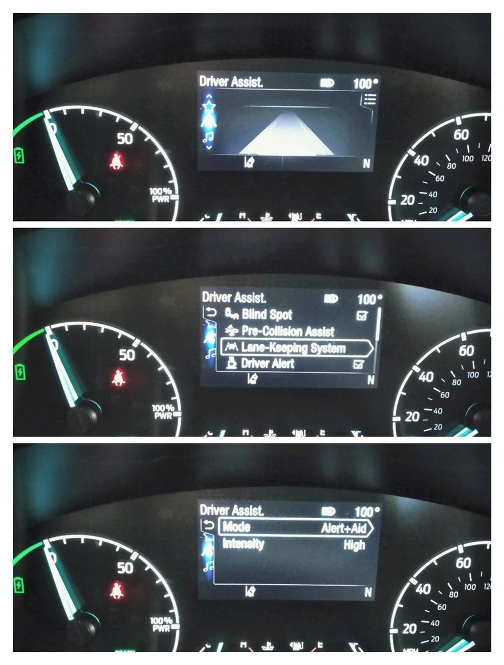

The on/off switch is on the end of my turn signal lever but I am looking for the Mode settings.

No LKA settings in the infotainment center screen in Driver Assistance?

My 2025 Lariat has all the settings in the Infoscreen you can pick and choose and adjust the individual settings

No Driver Assistance listed
