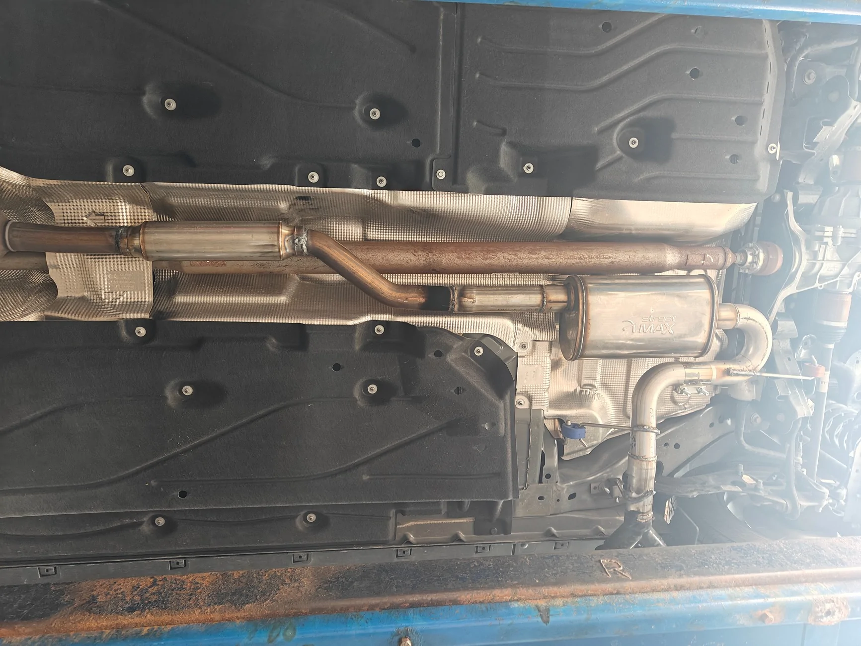

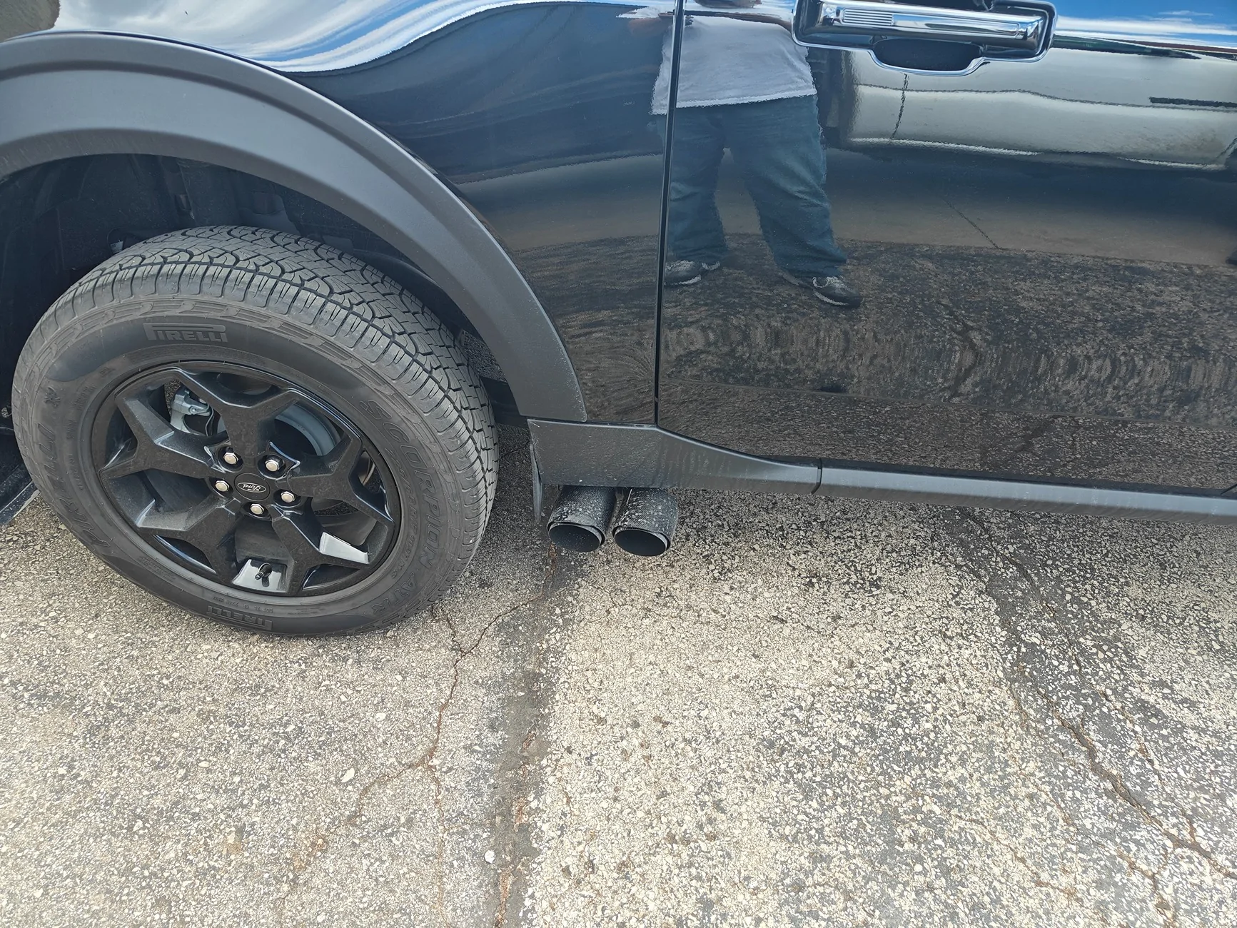

I'm amazed that ppl are willing to spend that kind of money on box kits. The exhaust on the Maverick isn't that complicated. I'm on my second exhaust and have spent less than the borla kit. I went side exit. Any competent exhaust shop should be able to fabricate this in an hour or two plus parts. Any 14" offset/center 2.5" muffler, 2.5" 90° mandrel, 2.5" 180° mandrel, two 3/8" hangers, tip of your choice and a couple feet of 2.5" pipe. The midbody resonator was from the first exhaust I put on but isn't really needed with the current set up.

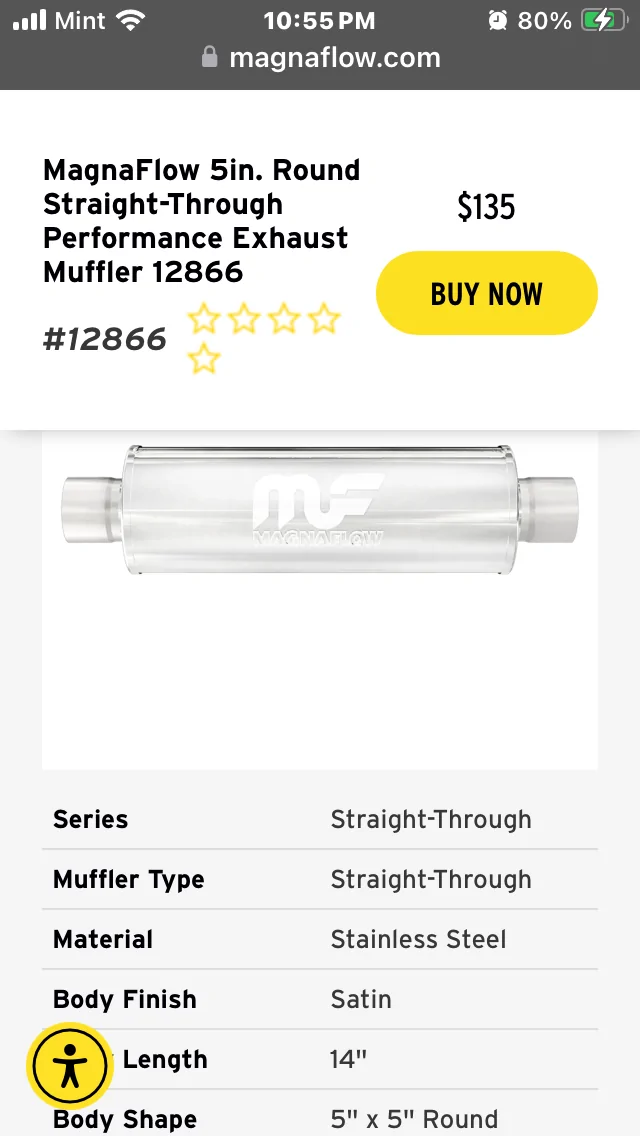

I thinking of having a muffler shop install this $135 Magnaflow muffler. With tax & labor about $250 or so.
Magnaflow is top tier quality and known not to be too loud or droney.
