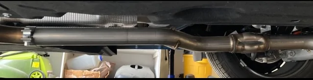

I'm amazed that ppl are willing to spend that kind of money on box kits. The exhaust on the Maverick isn't that complicated. I'm on my second exhaust and have spent less than the borla kit. I went side exit. Any competent exhaust shop should be able to fabricate this in an hour or two plus parts. Any 14" offset/center 2.5" muffler, 2.5" 90° mandrel, 2.5" 180° mandrel, two 3/8" hangers, tip of your choice and a couple feet of 2.5" pipe. The midbody resonator was from the first exhaust I put on but isn't really needed with the current set up.

Bumping an old thread, I went Thermal R&D and the fit is anything but good. Sound is good, but not loud enough. The wind noise when the windows are down shouldn't drown out the sound...
Right now mulling over hacking up the R&D for better fit, or going Borla or MBRP (had both on my F150 and was happy with both). I'm willing to trade if anyone was willing
*edit MBRP is a cut install, so that's out, might as well hack up the Thermal
