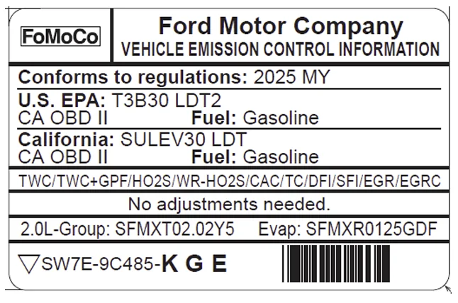

If you live in a CARB state (California + other Section 177 States that have adopted California emission standards), the easiest way to know if that 2026MY (or 2025MY) Ford you’re eyeballing has a GPF unfortunately is - go to the dealer, pop the hood, check the VECI sticker, see if it has the magic term “GPF” anywhere. If you see that - you've got a GPF on your 2.0L EB Mav. For 2026MY, here's the CARB exec. order (approval) for a MAV with GPF: Executive Order: A-010-2615-1
For 2025MY Mav with GPF, here's the VECI (same engine Test Group number as the 2026):
Ford Maverick 2025 Ecoboost with a GPF 25mavveci

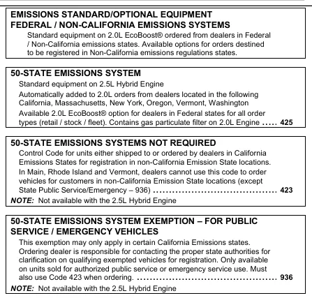

The '26 Order Guide 'sort of' addresses this:
Ford Maverick 2025 Ecoboost with a GPF mav26order

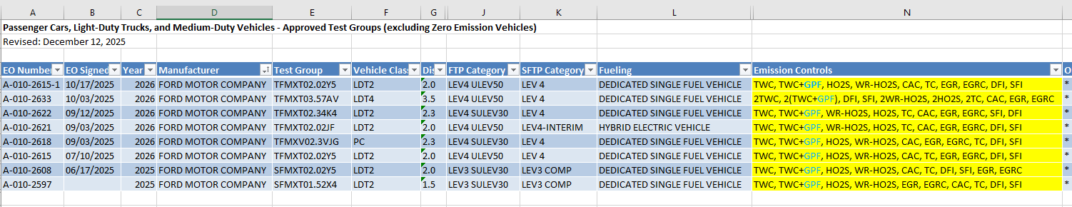

Just for grins - a quick-and-dirty method I used for finding CARB-certified vehicles that have GPF’s – went to the CARB website New Vehicle and Engine Certification: Executive Orders for Light-Duty Vehicles | California Air Resources Board , clicked on EO Summary for PC/LDT/MDV LDV_EO_Summary.xlsx , downloaded the file, search for the term GPF. You’ll get around 89 “models” (from 2020MY to 2026MY) - mainly BMW’s, Porsche, Ferrari, Jag Land Rover, Lotus, Maserati, Mercedes, and VW. And 1 x 2026 Hyundai.
What’s left is – 6 x 2026MY Ford ‘models’, and 2 x 2025MY Ford ‘models’. One thing in common – they’re all forced induction.
Ford Maverick 2025 Ecoboost with a GPF pic2
Compliance certification (both EPA Federal and CARB) hinges on the Test Group number – without that can’t compare apples to apples – you can have the same MY, same model, same displacement engine, but different test group numbers.
Even some 2026 F-150's with 3.5L EB will have them - CARB certification (Executive Order) Executive Order: A-010-2633 which notes GPF’s. Then again, some 2026 CARB F-150's with 3.5L might not have GPF’s – why? – because of this CARB certification A-010-2647 which notes no GPF’s. So both are CARB-certified – but only 1 has GPF’s. Caveat Emptor.....
Of interest – no 2026MY General Motors, FCA, Toyota, Honda, Nissan, Mazda, Subaru, Kia, Hyundai (all but the 1 mentioned above) with GPF’s. Why did Ford decide to meet/get certified to the 1 mg/mile particulate matter (PM) standard? Who knows, kind of like asking why is Ford’s BMS designed the way it is. Way too many things going on with Ford in the world of regulatory compliance and sales numbers to know all the “whys” – LEV3/LEV4 standards, are they interim or not, what federal test procedures (FTP) or supplemental test procedures (SFTP) used, is it on a phase-in (or alternate phase-in) schedule, is it part of fleet requirements, any offset credits, what % compliance are they at, ad infinitum. That's a rabbit hole that's almost bottomless.
