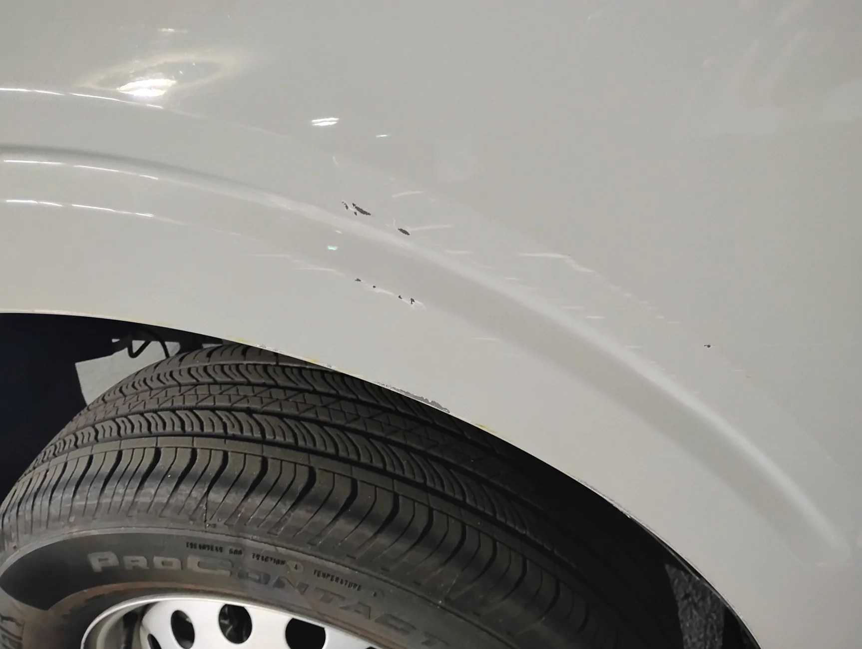

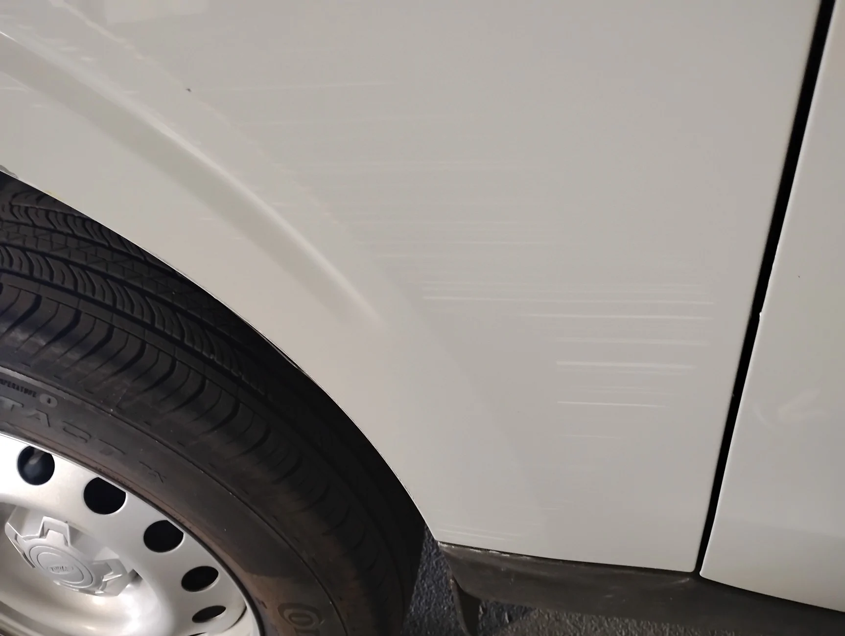

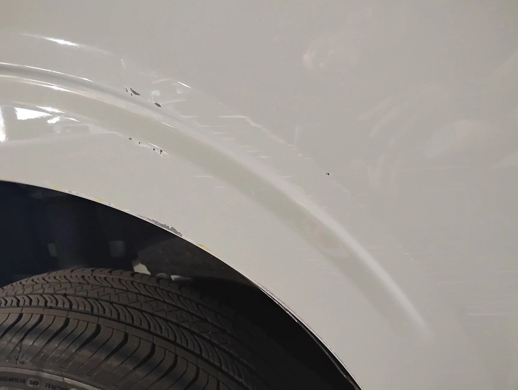

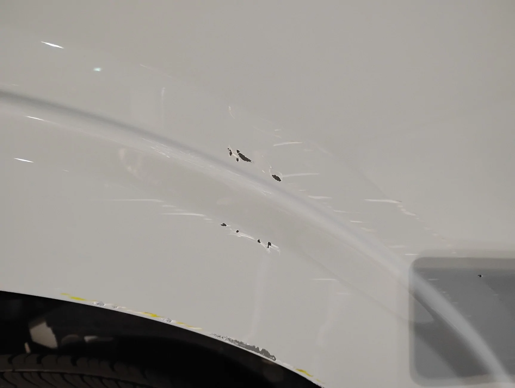

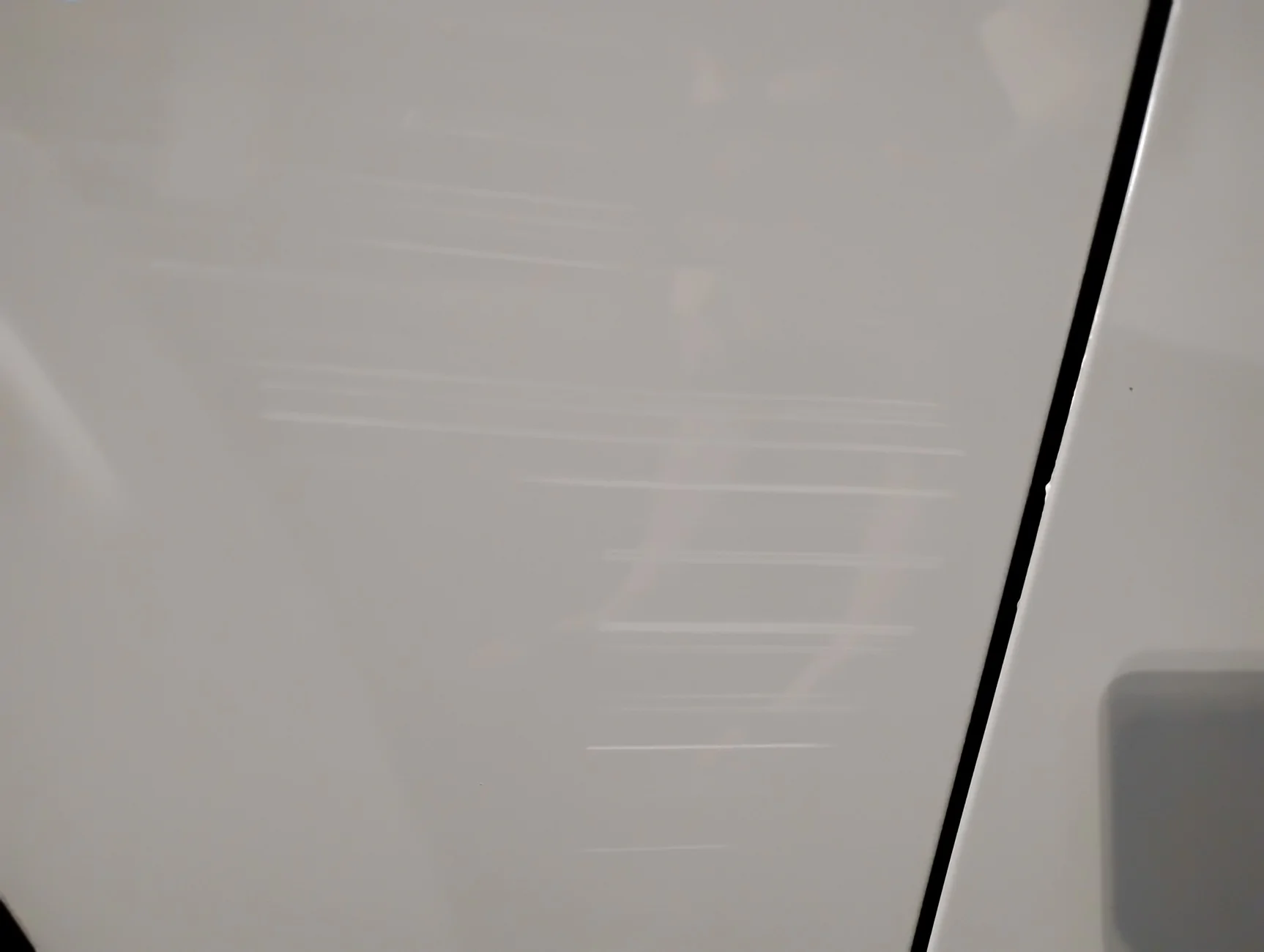

Made a sharp turn by the concrete pillar and got the rear passenger side right above the back tires a bit scratched up. Most is white streaks, just by the bottom I see the metal dots. I dont know if its wise to go to the deal to have them fix it up. Saw the cactus grey paint spray on Amazon, dont know if that would make it obvious that the truck was scratched. I will be posting the pics soon, open to suggestions or ideas. Thanks!
I don't think that's bare metal; looks more like chipped color coat with primer showing.
Personally I'd just use some touchup paint to fill in the chips and then hit it with a dual action polisher (or call a detailer). The light scratches could likely be 90%+ removed. Even doing a basic touchup job (just dabbing the paint in the chips and letting it dry) would be hard to see from 20 feet away, but I suppose it depends how perfect of a repair you're aiming for.
With a little more time, you could fill in the chips with touch up paint, wet sand the area, then buff it to a shine again and even a pro would have a hard time spotting the repair.

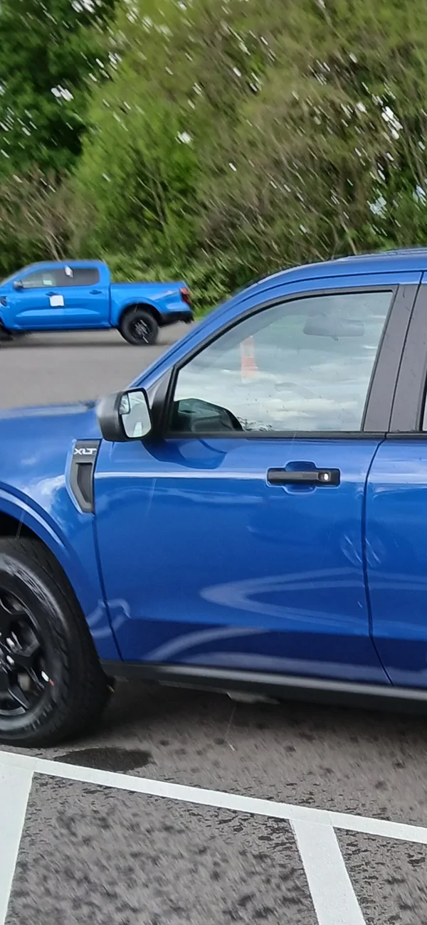

My '24 XLT has the magnifying mirrors in the corners from the factory. Tough to see, but I blew up a pic of the truck when I spotted it on the lot last year.
