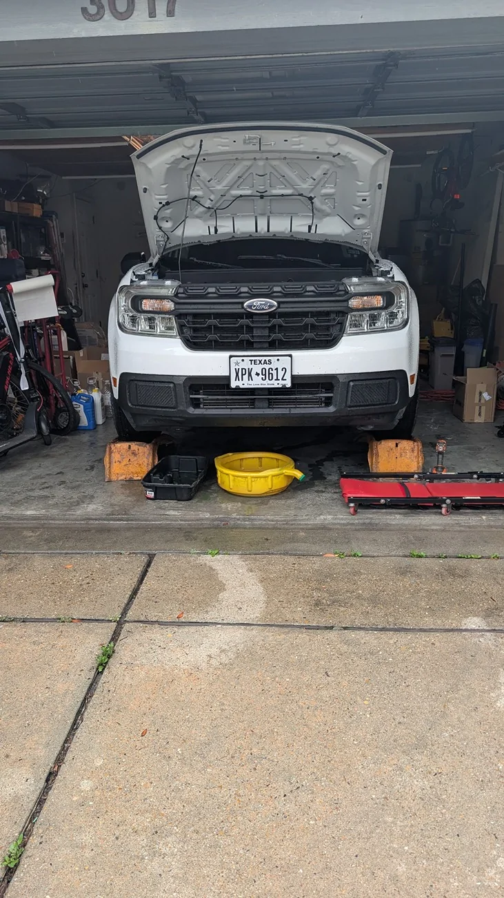

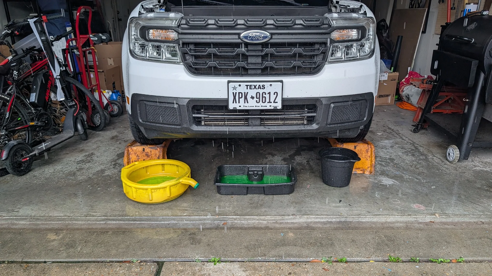

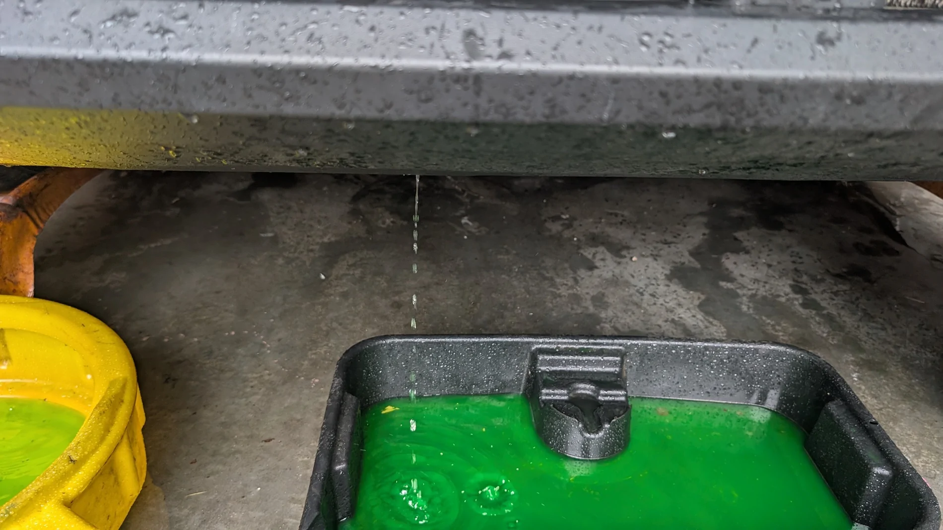

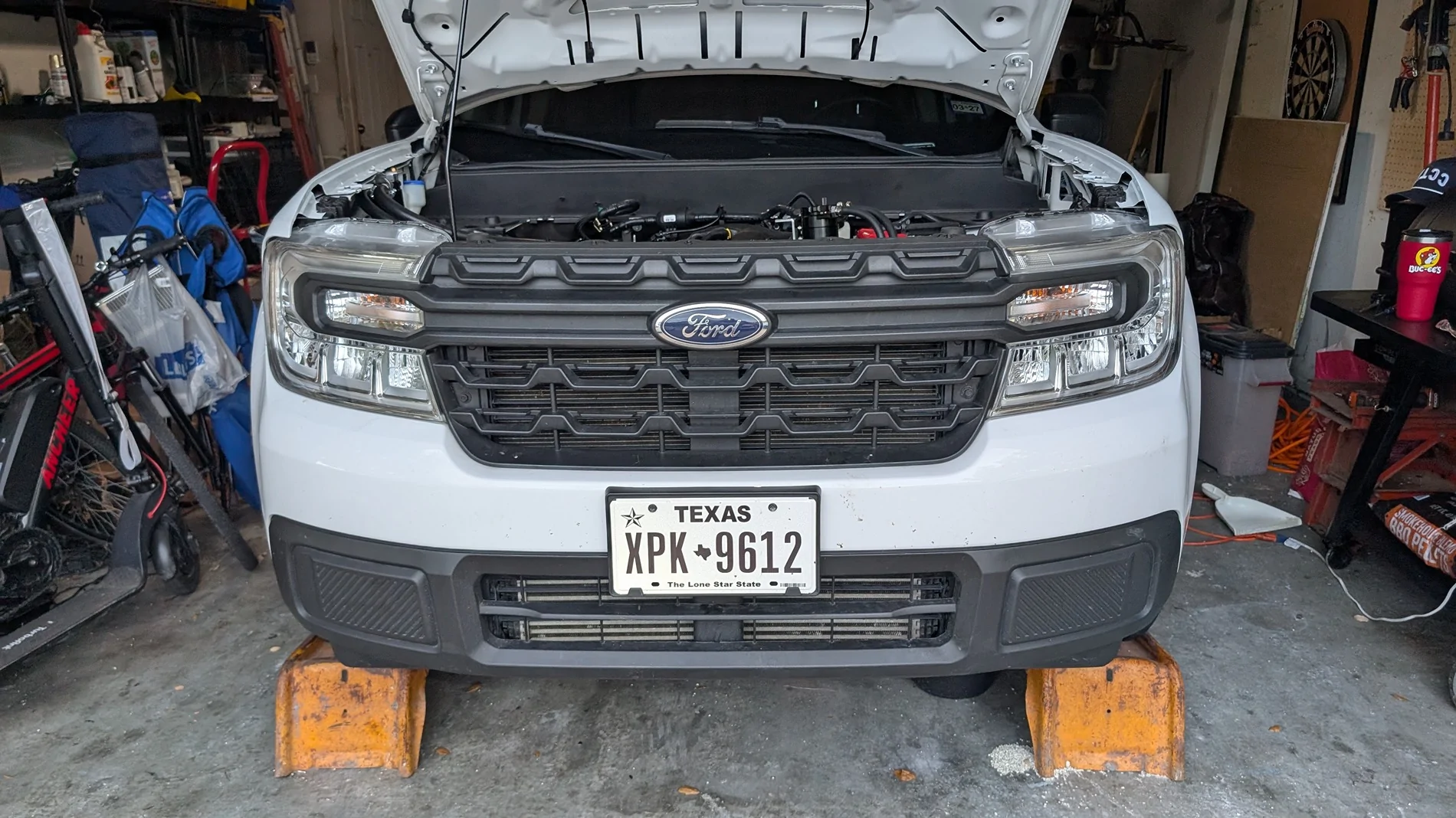

Has anyone replaced the radiator on their Ecoboost yet? If so how bad is it to do? Son's 2022 is leaking and I need to replace.

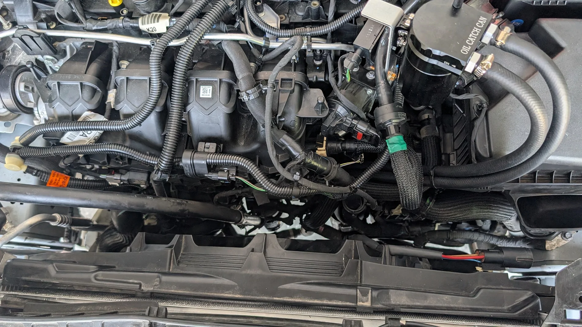

2.Clear upper engine trim:20 mins.
Remove the plastic push-pins securing the upper radiator air shield cover. Disconnect the air intake duct work to give yourself physical clearance above the cooling fan shroud assembly.

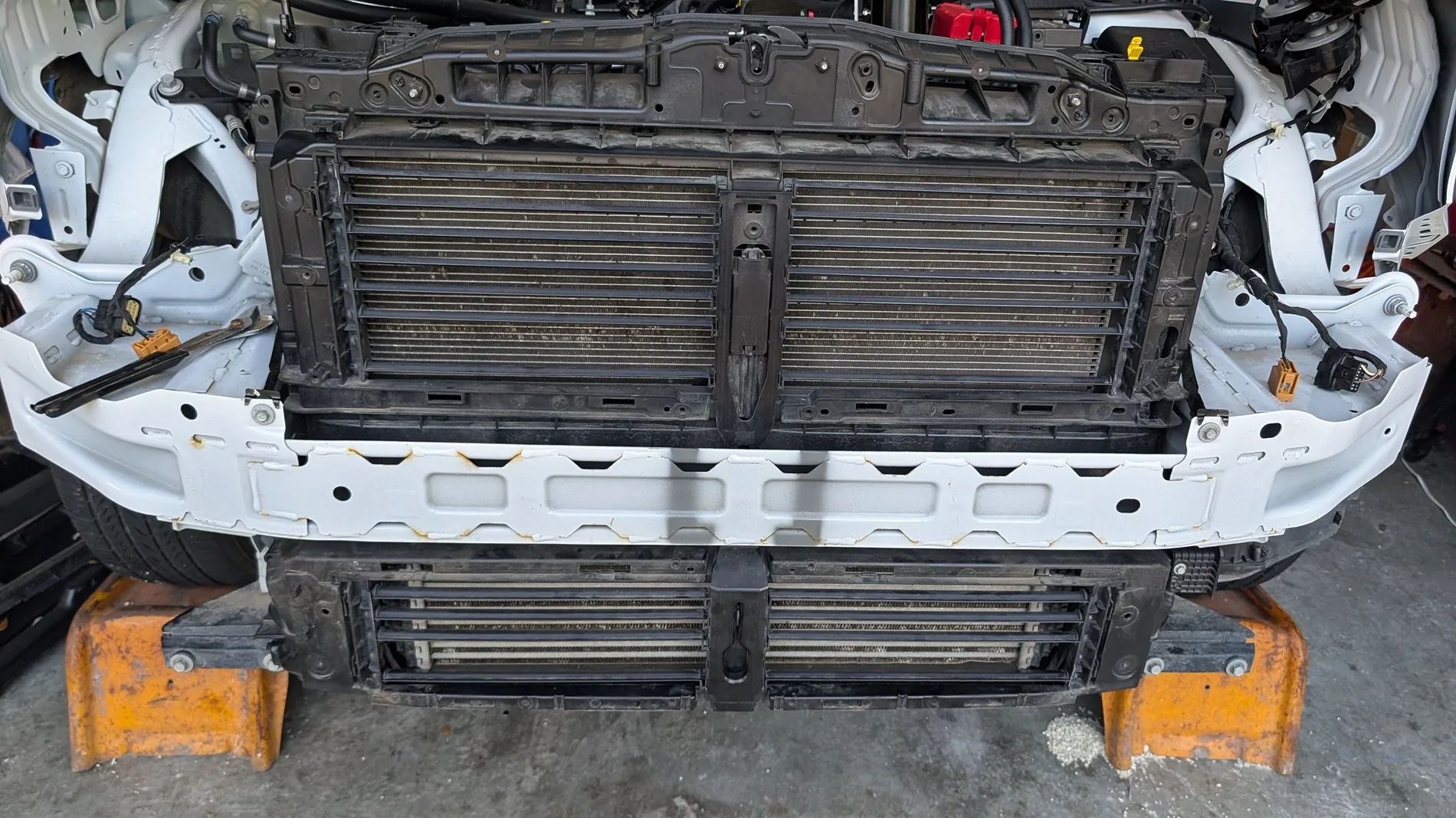

4.Isolate the A/C condenser and intercooler:25 mins.
Locate the mounting tabs locking the A/C condenser and the turbocharger intercooler unit to the radiator core frame. Carefully unbolt and slide them off the radiator tabs. Use a bungee cord to suspend the condenser securely so it does not stress the rigid refrigerant lines.

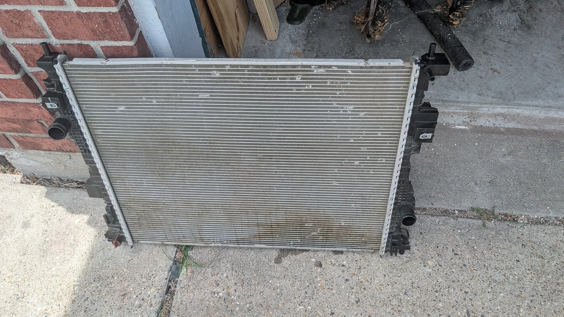

5.Extract the old radiator and swap the fan:15 mins.
Unbolt the upper radiator mounting brackets holding it to the core support. Carefully lift the radiator and attached cooling fan shroud straight up and out of the engine bay. Transfer the electric fan shroud assembly over to your new radiator core.
