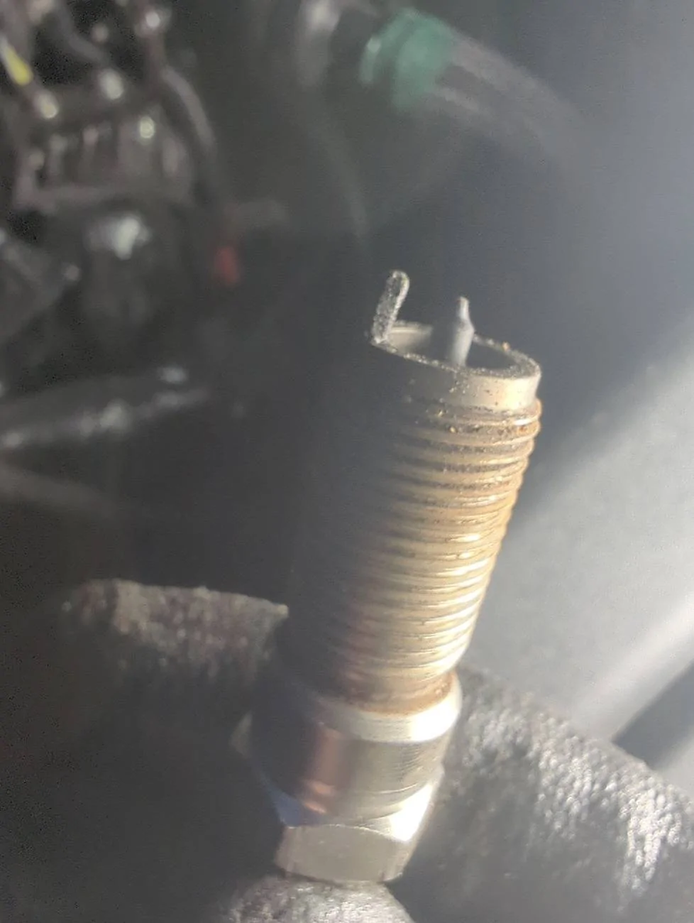

on the way home after 30 minutes into my drive it started missing and running on 3 cylinders. I pulled over and let it sit. Checked the codes and it another out babies it back home and 10 minutes away it would barely run over 60 in eco mode babying it
that's when you made a mistake and destroyed the engine, or at least that cylinder. you didn't say when it first set a code. when that happened you pull over, tow it, and maybe the engine is already gone or maybe you can save it. I'm saying this more for everyone else's benefit and yours next time. do not reset a misfire code and keep driving. do not replace a melted or otherwise damaged plug and keep driving.
spark plugs at this power level are never the issue in my experience unless you have the heat range wrong which causes detonation.
possible other causes:
bad fuel. not enough fuel, especially if running high ethanol on a standard 93 e10 map.
dirty or failed injector.
aggressive map with too much timing and/or lean afr.
.. and a lot of other possible causes you have to tear down to check out.

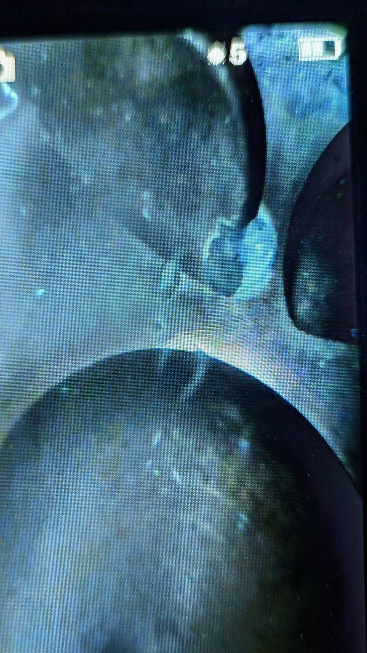

When I say it had a miss to begin with. It was a miss that was so slight and barely notice I could barely feel. But no codes or anything. During this. I just kept it on eco mode for the 100 mile drive and it was gone.. it didn't return till 10 miles away from home and that's when the light came on. And I kept babying it. At 1 am I doubt I could have got it towed in my area. I'm putting a note scope down it this weekend. It does have compression. I removed the plug and it's definitely working. But still a slight missing. Thinking maybe the hook Got jammed in a valve. Cheapest case scenario as it feels. Maybe a $600 head from ford. Worst case a $2200 Corsair engine.
It didn't have any aggressive tune or crazy heat range spark plug like some of y'all mentioned. Plugs was the original ones at 56k or 58k miles. Run 91 octane in the gas tank and 87 octane tune.

So, I just read the whole thread, and am still confused. Is the motor toast or is it running? If compression is good across all cylinders, you don't have anything stuck in a valve, because you wouldn't have good compression on that cylinder.

I would take it to the dealership, and explain what happened to the spark plug, and have them look into it. Especially if you are under 60k miles!

Here is update pics car is 100% stock aside from coilovers and wheels.
