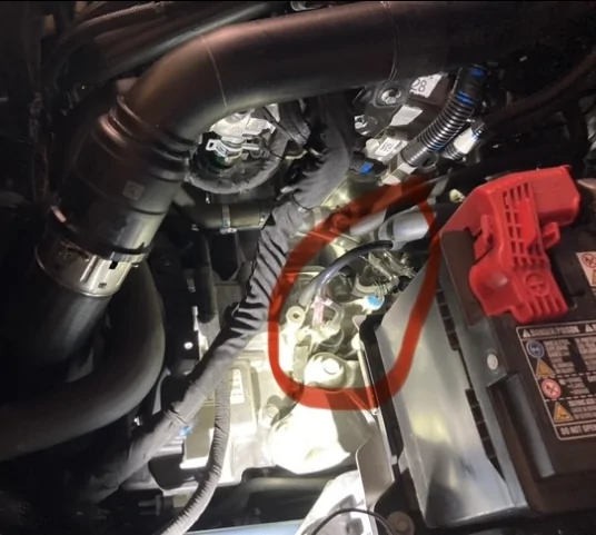

This is a top down look at the new EB (my lobo). Not sure where the fill hole is. There is a weird “plug” with a venting hose protruding. I’ll read directions before I start yanking on things!
Hey Chops,
Yes that plug with the line coming out of the top is the vent/fill hole for the transmission. Just take a pair of pliers to release tension from the spring clamp on the rubber grommet and pull up. Should be good to go!

22-24 models can also fill through the leveling plug if you choose to do so if you don’t want to take the air box apart
