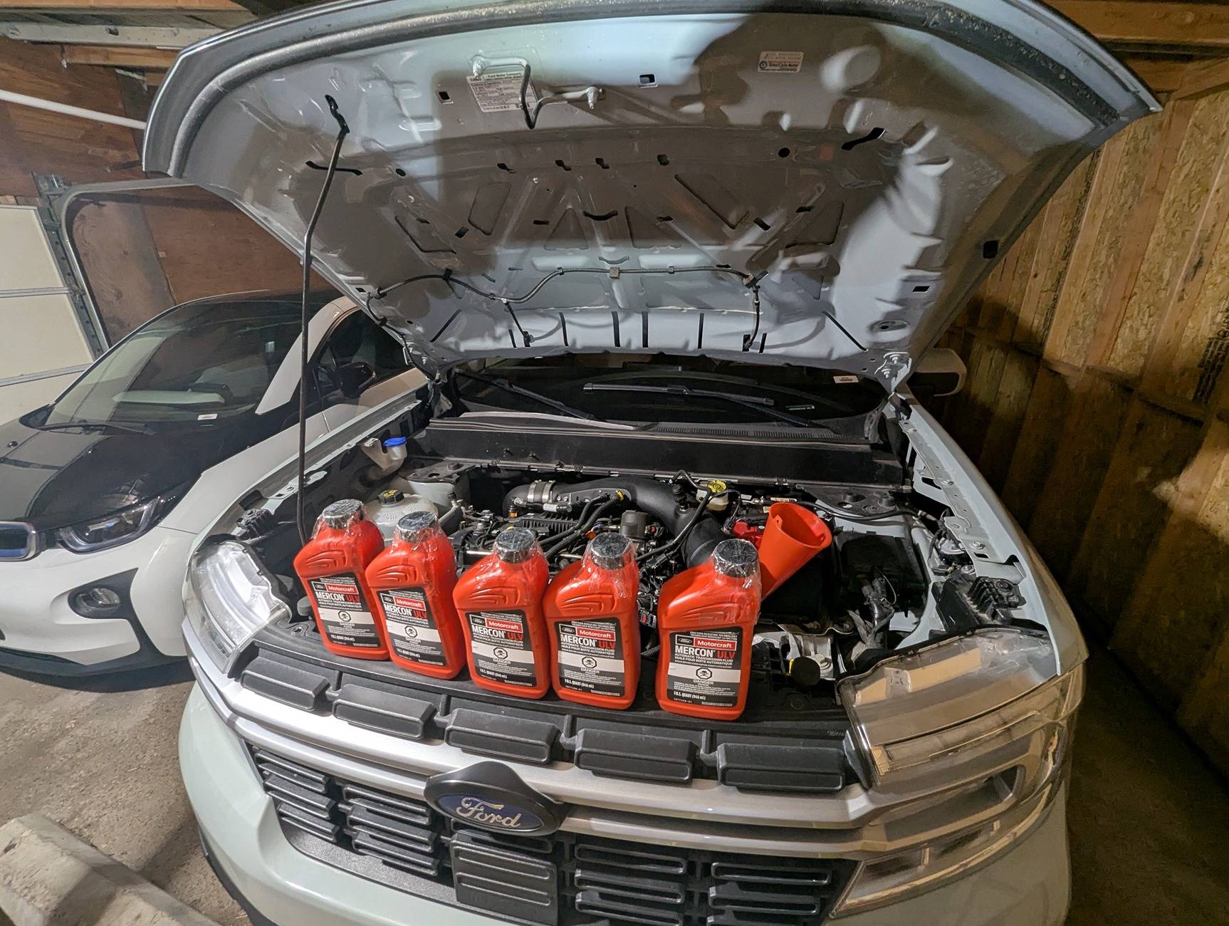

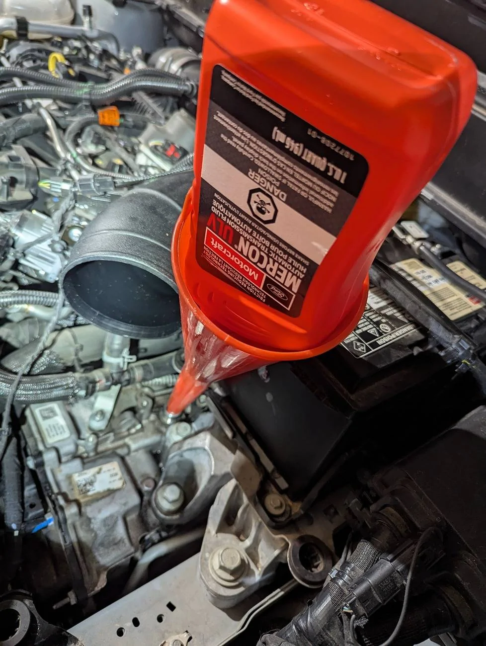

I'm a bit concerned, and so confused;
2024 2.0 EB AWD 4K; 20k Miles, I decided to do the trans fluid as commonly recommended.
Consensus seems to be 4.5Qts but i had a different experience I wonder if this is a problem;
Drained the fluid and out with the fluid came a small triangular scrap of metal, about the size of half of a pea. absolutely impossible to determine what it was as it was clearly sheared off in every angle, almost looked like a grinder was used on it or it was cutoff scrap from someone cutting something with a grinder. fluid like red chocolate milk.
Filled to 5Qts, then drove around the block a bit to reheat temps as recommended.
Made sure the truck was level, and Removed the leveling plug and out spilled a good amount into the pan that still had the old fluid in it. when i went to drain all of the fluid from the pan into the now empty bottles, it overfilled all of them so i wound up with probably about 5.25-5.5Qts of dirty fluid. Im very confused on this, i guess this means the factory had this overfilled by about 0.25-0.5 qts?
i wasnt exactly super careful on the transmission temp while doing this but i cant imagine the fluid expands/contracts that much to mess me up? but i did the fill plug so i figure the right amount should be in there...
and that scrap metal is a bit worrying... but i have never had any transmission or shift issues or weird sounds..
any thoughts?
