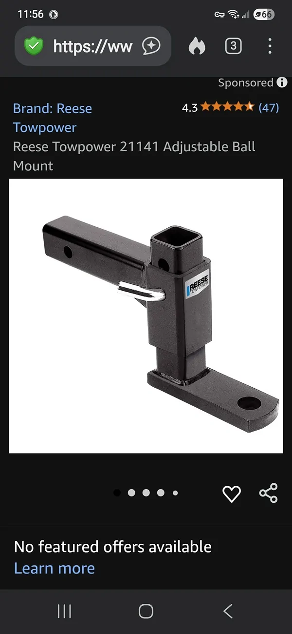

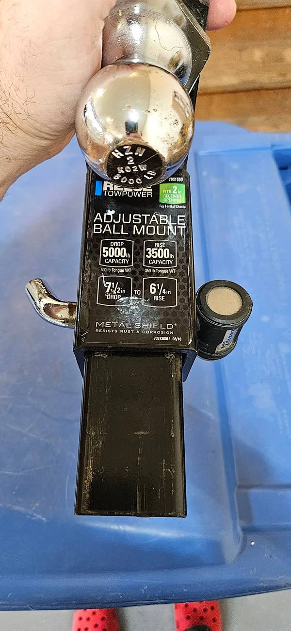

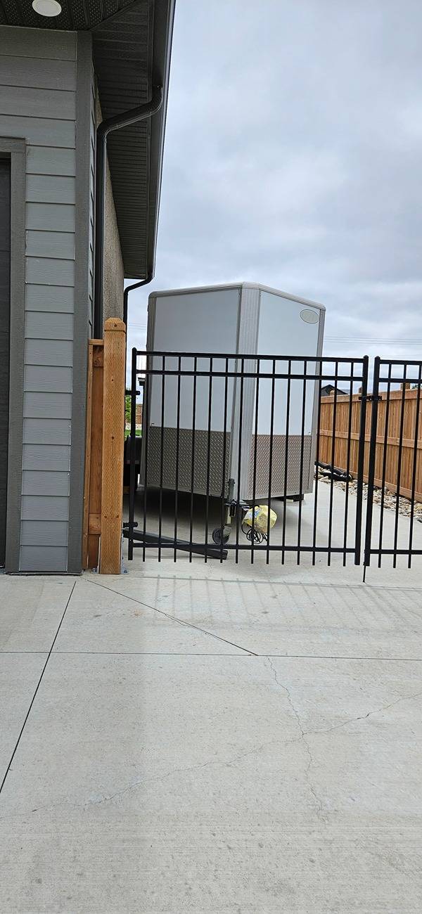

My current trailer and favourite Hitch and lock.
Adjustable means flexibility
as to trailers Hitch height, as mentioned above...a good idea.

What's the brand of that hitch? I see some that are reasonably priced but I wonder if they are junk. Then I see some that look amazing but they are rated for way higher than the truck can tow, and are stupidly expensive because of it.
Hunters Edge

I don't know but I use it the opposite to raise the hitch height for towing trailers. I was in Menards years ago and thought that will work in my situation, so I picked it up. The Rangers hitch height is to low for many of my trailers, utility, snowmobile and more importantly my log splitter. The log splitter needs to be relatively level to use it. Just makes sense to leave it hooked up until done using it and moving as I go less steps. It also works on the garden variety trailers with a lower height. Anyway for what I use it for it's been a good fit.
On my Maverick I use a 6 inch drop for landscape, dump, utility trailer, and a straight receiver for the boat trailer. I almost picked up a aluminum adjustable hitch at Family Farm and Home when the had it for $159. I didn't though I already have several height receivers that I have acquired over the years. It looked nice, it was hard to say no, but I decided I had 159 other uses for the money. I have not used the one like you have except on the Polaris Ranger. Then again I don't know what the weight rating for it either.

Usually a Reese or Curt hitch will do.
It seems there are many different types available, depending on how much you want to spend. Go for quality!
The spec's for my hitch are in the first photo.
Make sure you have a big enough wrench or adjustable wrench to attach the appropriate sized hitch ball onto the hitch itself...use your truck to insert the hitch so you can really make sure that nut holding the ball in place (with a split spring washer) doesn't come off...ever.
I hope this helps!
