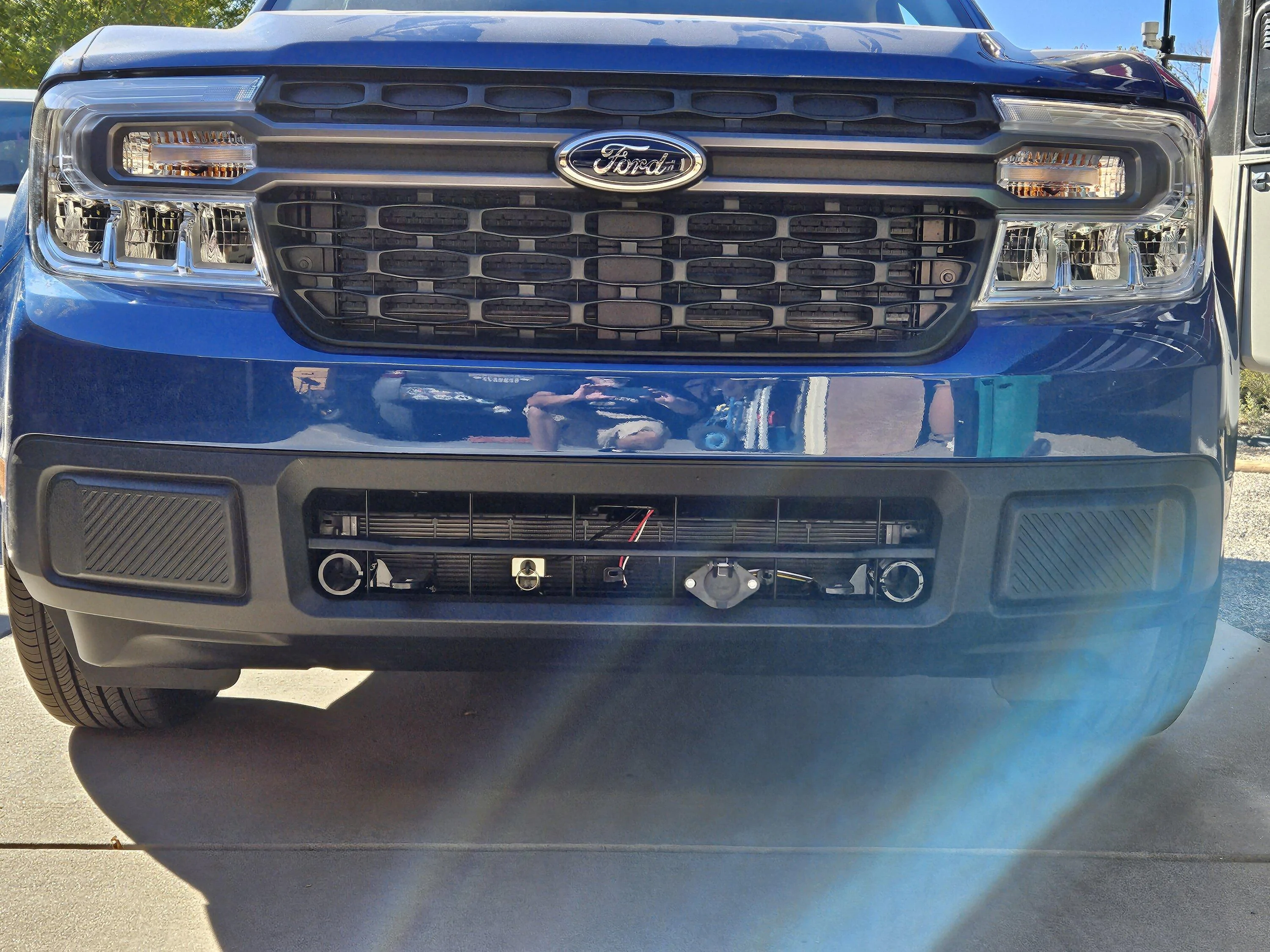

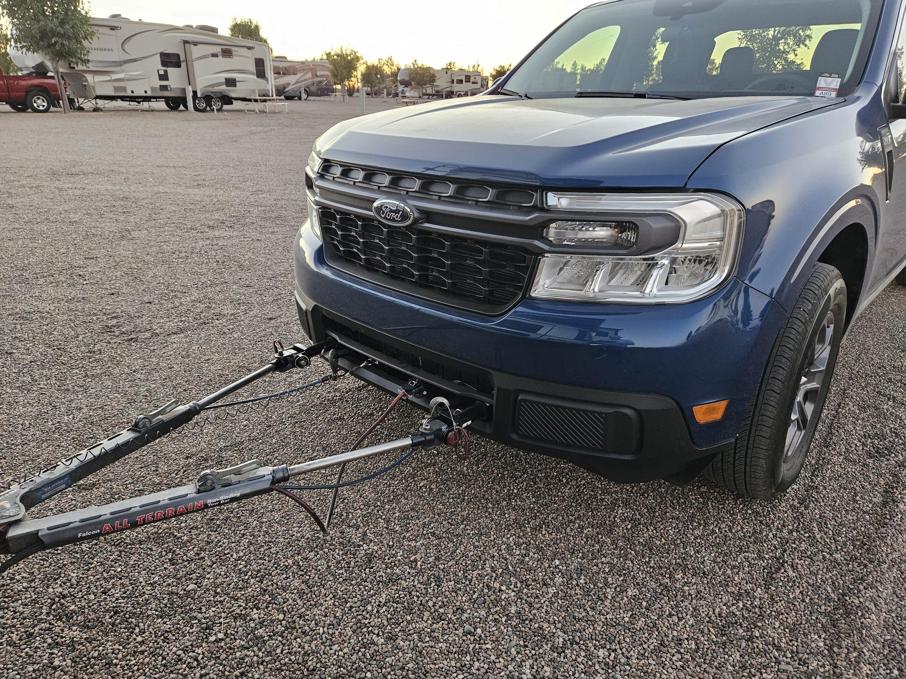

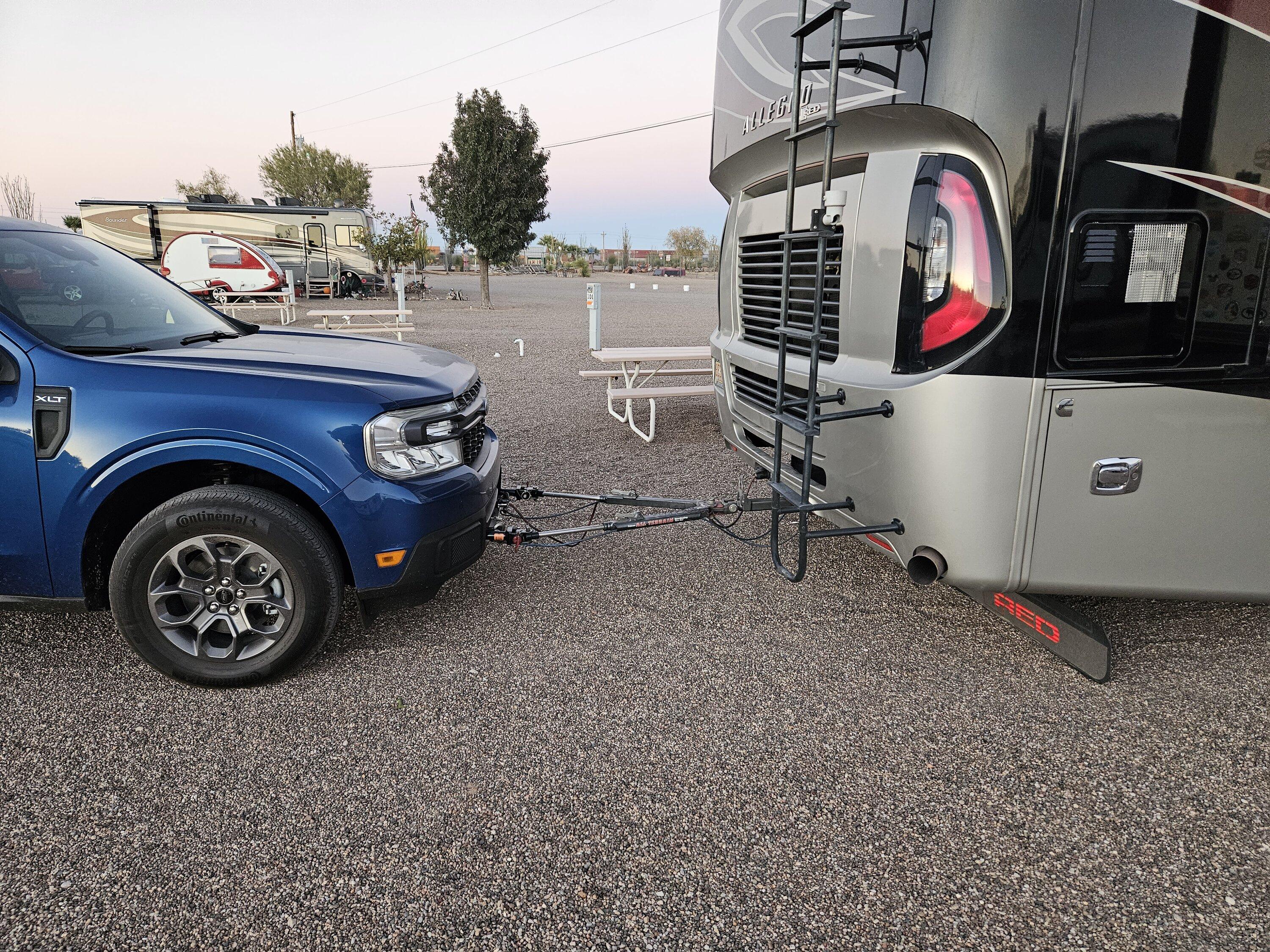

We've completed our 1st trip towing the Maverick. It was great, no issues and no problems. 1100 miles round trip from Albuquerque to Phoenix by way of Sedona and Deming, NM. 4 legs of around 300 miles each less than 6 hrs. I now have a couple of questions: the manual states not to exceed 70 MPH, my driving speed is 65MPH (sweet spot for MH) but sometimes going down hill I do exceed 70 MPH. I'm thinking the manual is referring to sustained speed not to exceed 70 so a couple of miles over 70 shouldn't be a concern - thoughts. I wired a dedicated 12 V outlet to plug my RVI Brake into, but it's not ideal. I believe I have seen the steps to use ForScan to remove the timeout for the console 12 V outlet but I can't find it now. Does anyone have that procedure?
My setup:
Roadmaster baseplate - self install
Roadmaster Falcon All Terrain tow bar
BlueOx bulb & wire kit
Charge wire kit with fuse & diode
RVI Brake supplemental braking device - I have 2 toads so the portable is best for me
I'm attaching some pics

It's just a personal thing with the 12 V outlet location. I didn't permanently mount it, just used extra strength double sided tape in case I didn't like the location. I did run a hot wire to the battery jump post and a ground to one of the grounding points on the fender. My RVI Brake draws a max of 8 amps so I put in a 10 amp fuse. After only towing the Maverick 1 time this is the extent of my issues, all in all it went very well. A few more trips will help me get it all optimized.

Let us know how the Demco install goes. I see that Roadmaster may have a newly designed baseplate that is similar to Demco and does not require removal of the lower Air Shutter assembly. I ran the charge wire from the MH and the 12 V accessory wire to the jump post under the hood. Below the jump post there are a couple of ground connections attached the the fender that I used for lighting ground and accessory plug ground. The break away switch cable and 12 V hot & ground were run into the footwell area by way of openings in the hood & door pillar area. I bought the charge wire kit from eTrailer, it has a fuse holder and diode installed. In my case the diode is probably not needed because there is 12 V present on the 12 V pin from the MH only when the MH is running so reverse connection of the Maverick battery to the MH battery is not possible.
