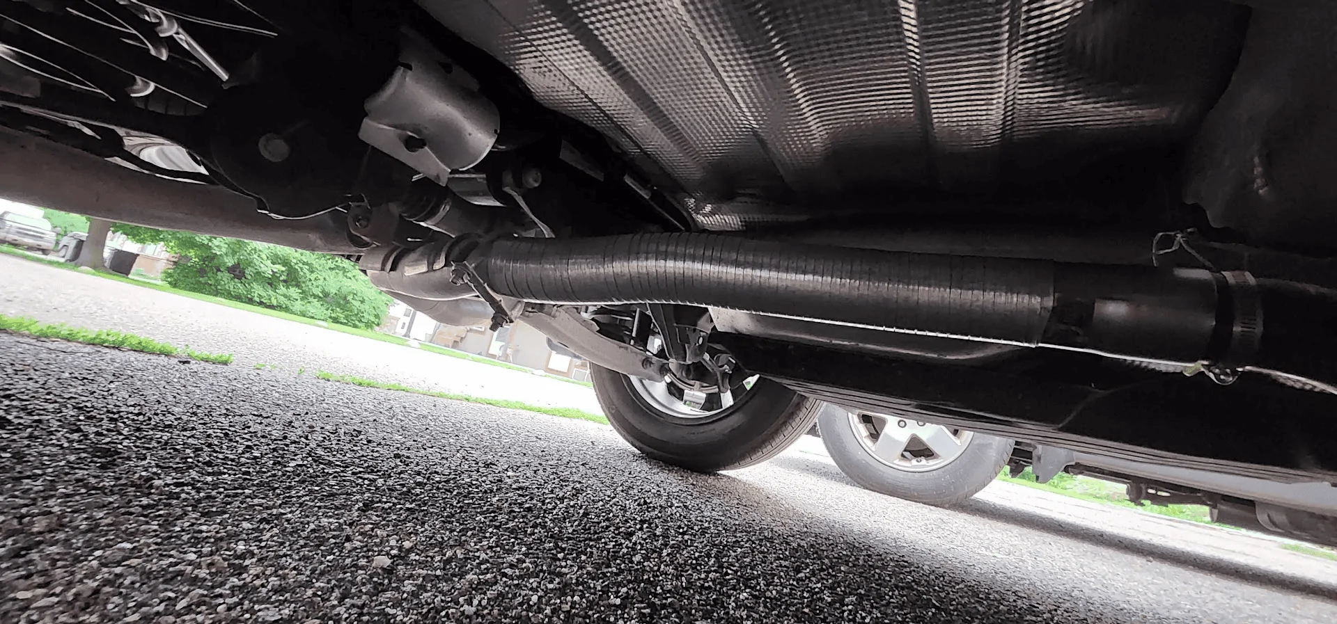

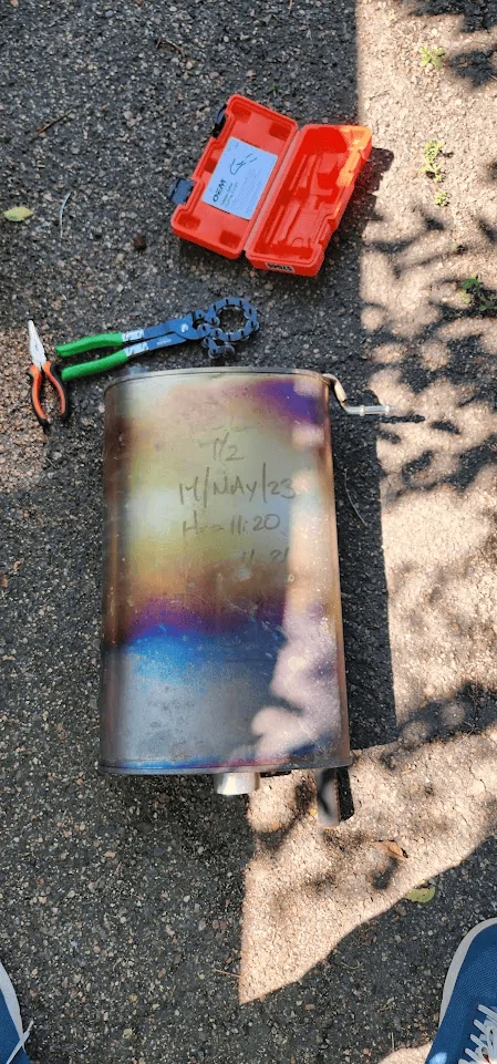

For those that have a tough time reading:
*This is to find out if you like the sound of your exhaust with a muffler delete*
So after not finding anyone with sound clips of just a muffler delete and not wanting to use a shop in case I didnt like the sound and just bought an exhaust anyways, I took it upon myself to do a DIY muffler delete and in my opinion it turned out great.
Things you need:
$50 tail pipe cutter rental from autozone (you get your money back when you return it )
$10 2 3/8in Flex Exhaust Repair
$5 2 1/2in I.D. x 2 1/4in O.D. Adapter
Step 1:
Use the cutters to remove the muffler, I suggest going as close to the muffler as the cutter will allow. The flex pipe you get is only 18 inches long annd the cut I made was about 20 inches hence the need for the coupler to extend it. took about 110-15 minutes with the hardest part actually being removing the muffler from the dang hanger lol
Step 2:
insert the 2 1/4 end of the coupler into the 2 3/8 flex pipe, this was a little tight of a squeeze so a few taps of the 2lb sled hammer got it in
Step 3:
Slide the coupler side over one end of the cut pipes (I choose the engine side) and the flex pipe over the other end and use the clamp to secure. Make the distance between the two end s of the cut pipes as short as possible to avoid any sagging. Just to help I used steel braided wire I had laying around from an old frame to adjust the the height of the pipe to best match the stock set up.
Here's a video of some various sound clips post muffler delete
In the end im very glad I did this just to make sure I would like the sound, and I love it, and now that I know I like the sound Ill head on down to my local shop and have them weld in a pipe so I dont have to worry about anything coming apart during a bumpy trip.
Hope this helps people decide on muffler deletes, whether its for or against I dont care!
