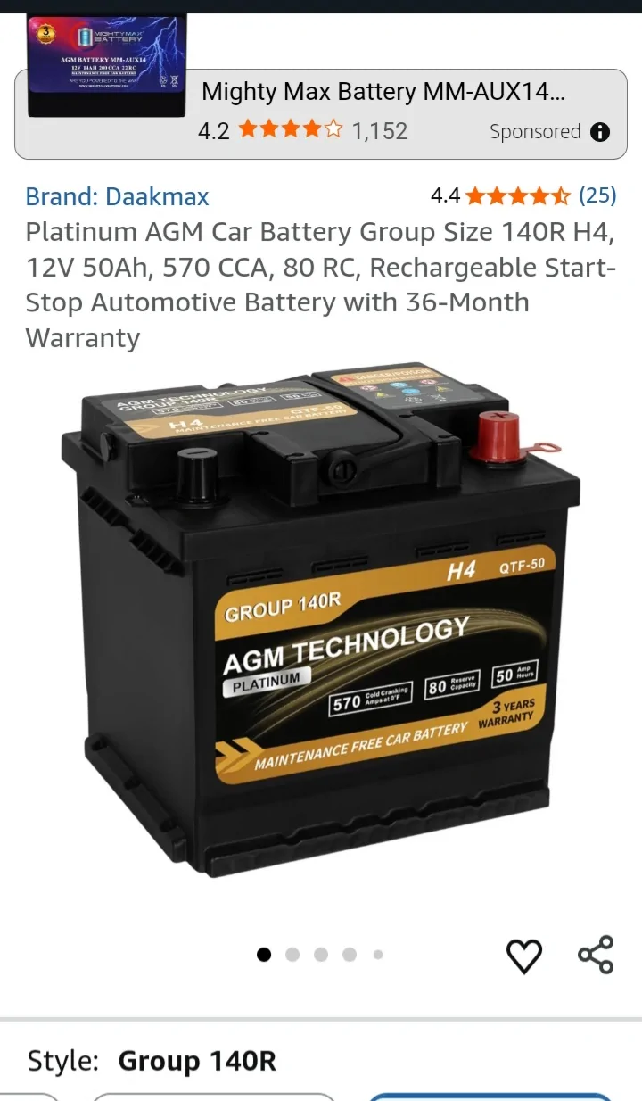

H4 group 140R AGM or Flooded your choice.
The correct size is H4 unless you want to do modifications including, bending some metal and removing the plastic surround allowing you to install the larger H5 battery.

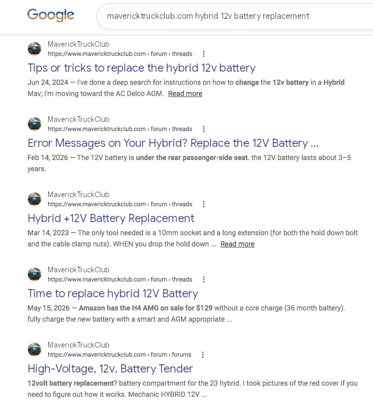

Replace with the AGM battery, choosing a flooded battery is nonsense. There must be over 100 threads on replacing a battery and/or choosing a battery- read some of them and learn why AGM is the wise choice.
