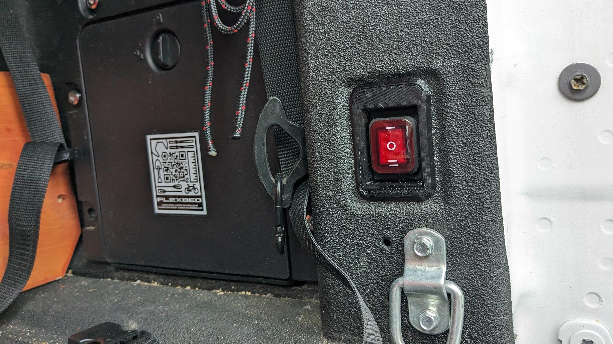

That's what we were told. However, in opening up the fuse box AND looking at the electrical diagram, it appears that both sides are on the same circuit connected to a 20A fuse. On the plus side, the 20A fuse seems to be a newer style that's a fast-blow so there's little damage to the system in a short (I've done it accidentally and verified that's true). Unfortunately, the wires Ford used is smaller than the usual automotive standard for 20A. So try not to go beyond 10A on each side for extended periods.
As a side note, I am planning on selling both additional pigtails AND corresponding drop-in switches to match. It's been delayed since I ordered the wrong terminal pins for the 12v connector. That being said, new pins are on the way and I have to say this mod is one of the best things I've done to the truck. My switch is setup so on #1, it pulls power from an auxiliary power port I wired in (which I have a power bank hooke
Ford Maverick 12V Power Bed Connector - What Type? PXL_20240402_015336530
