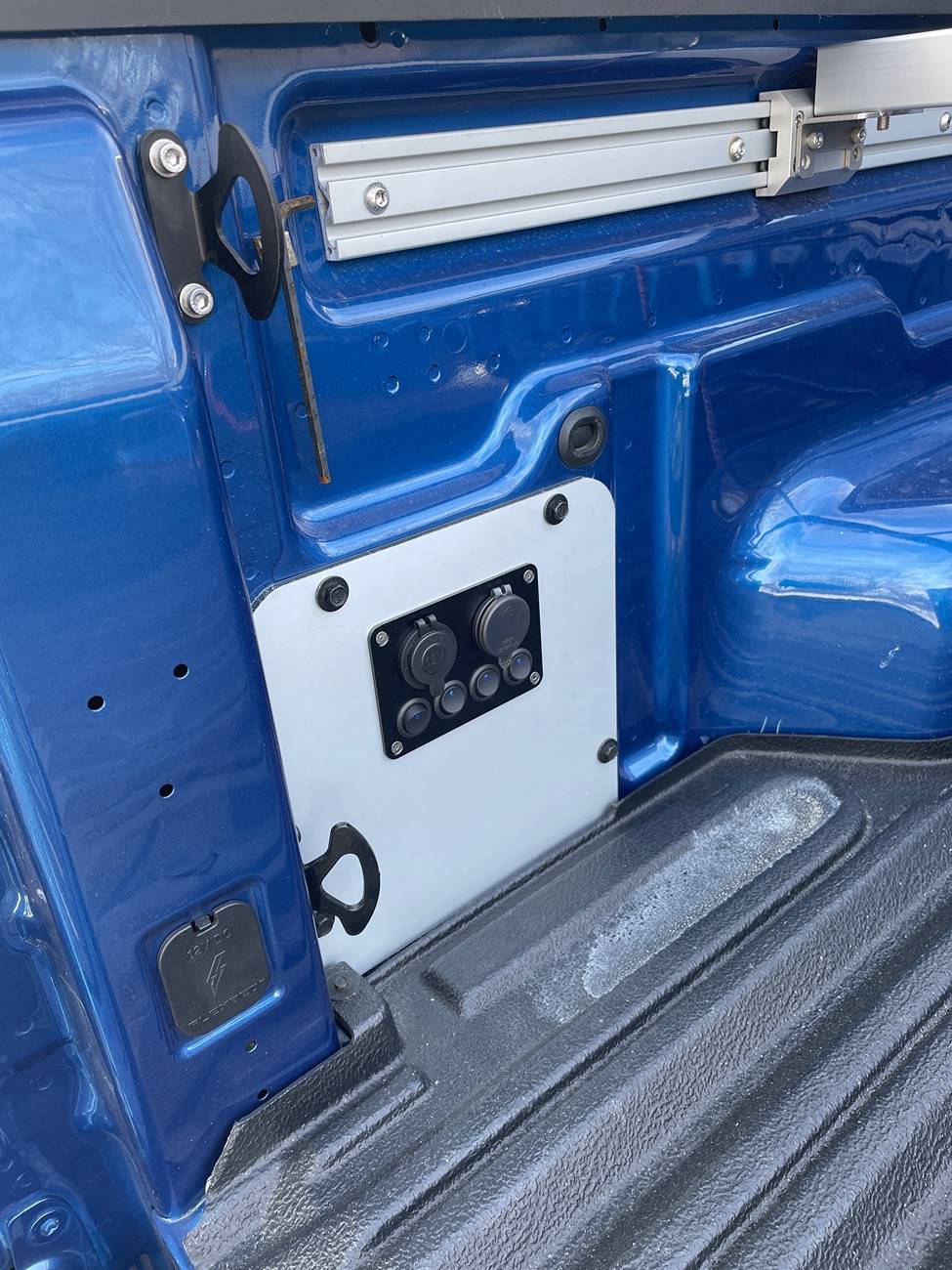

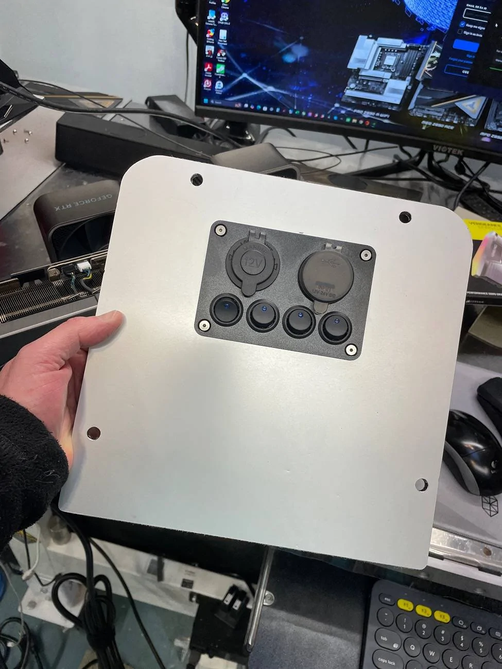

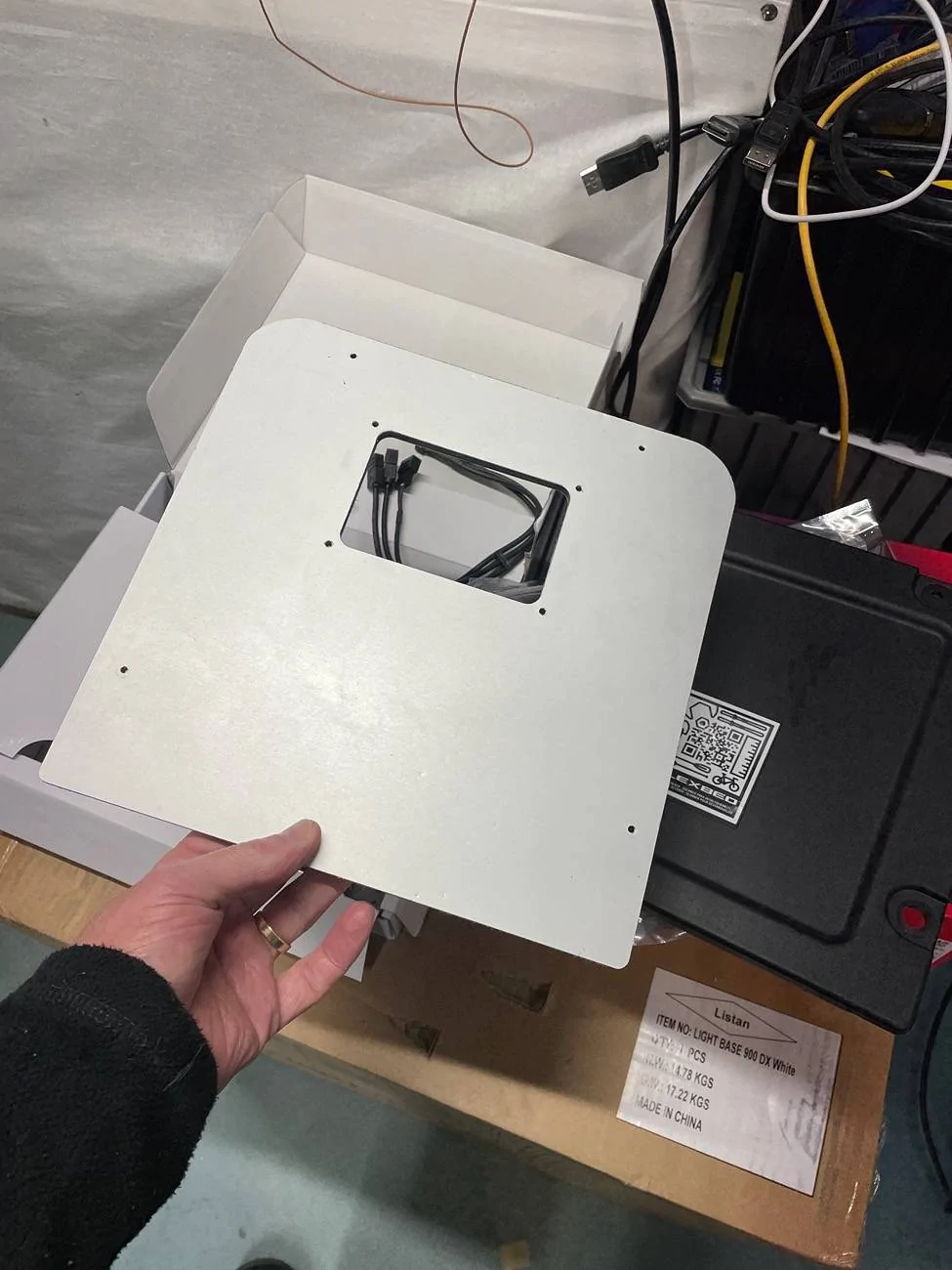

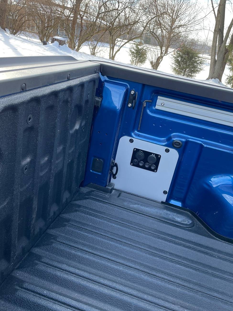

I wanted to add one of those little charging blocks that have the 12 V cigarette lighter plug as well as a couple of USB charging ports. I didn’t want to cut up the factory panel so I used a piece of material that is used for machine guarding. It is thin aluminum on two sides with a plastic core sandwich in between. Very easy to machine.
