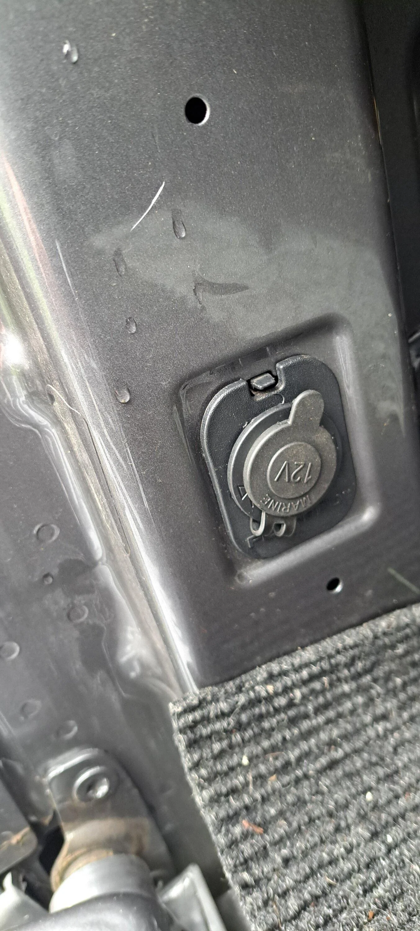

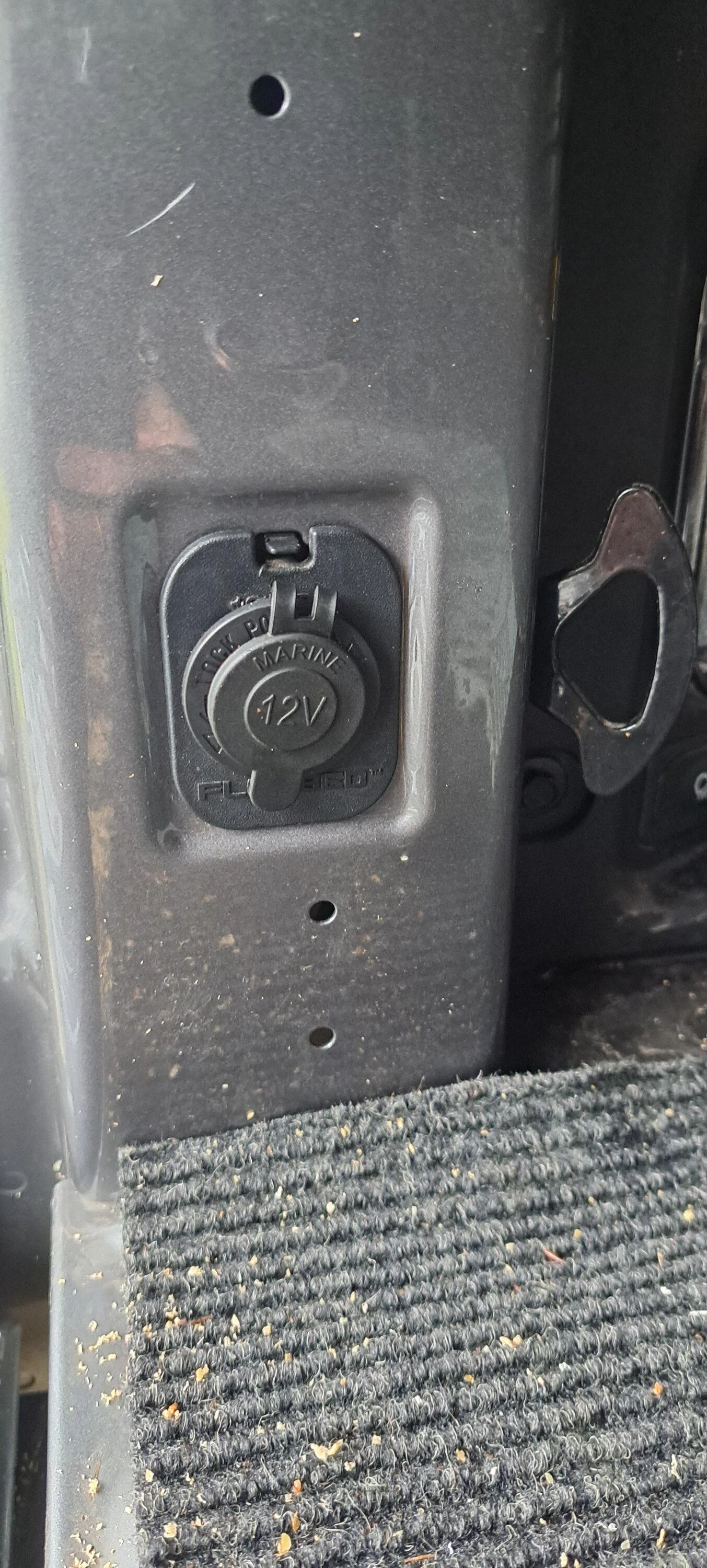

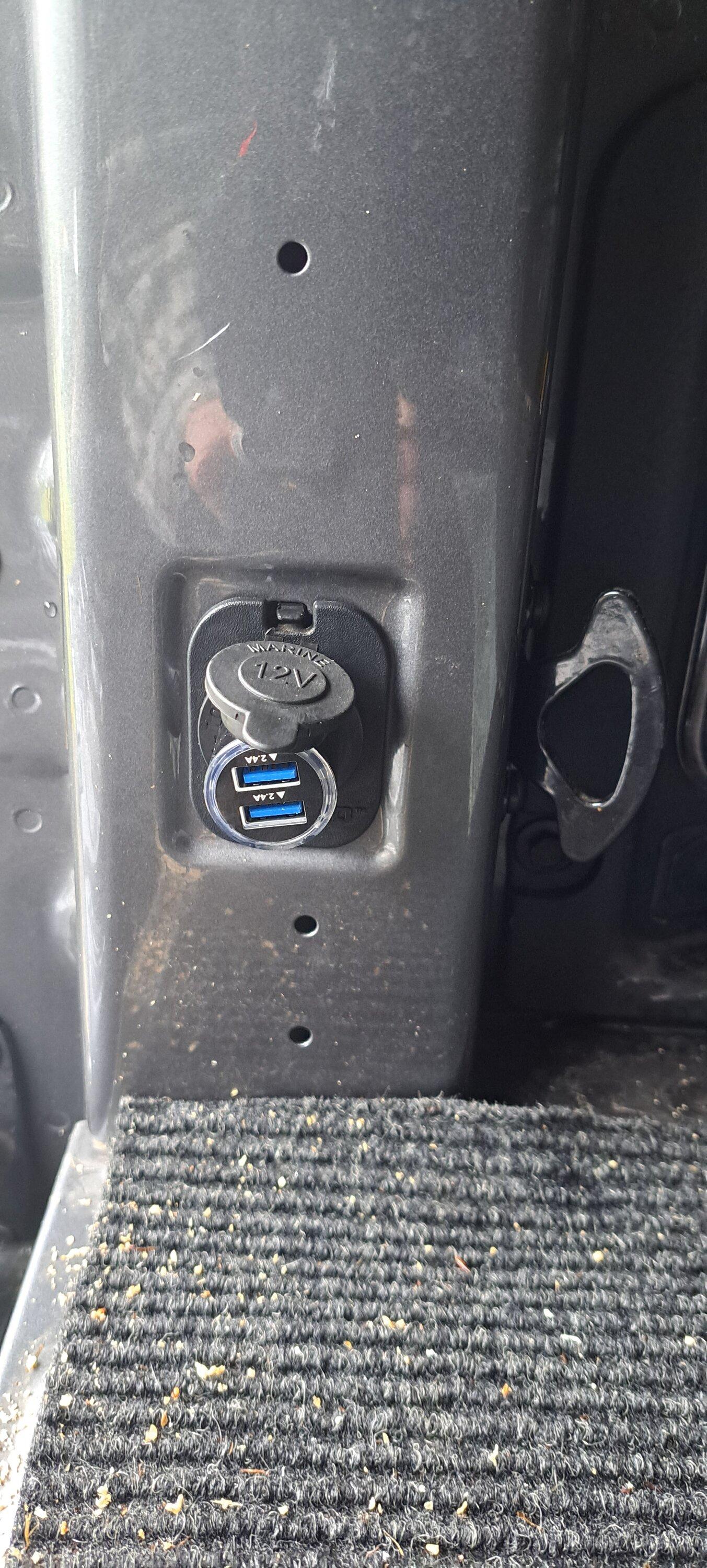

I saw on another post someone suggest using the 12v cover as a mounting spot. I went for it today and am super happy with the results.

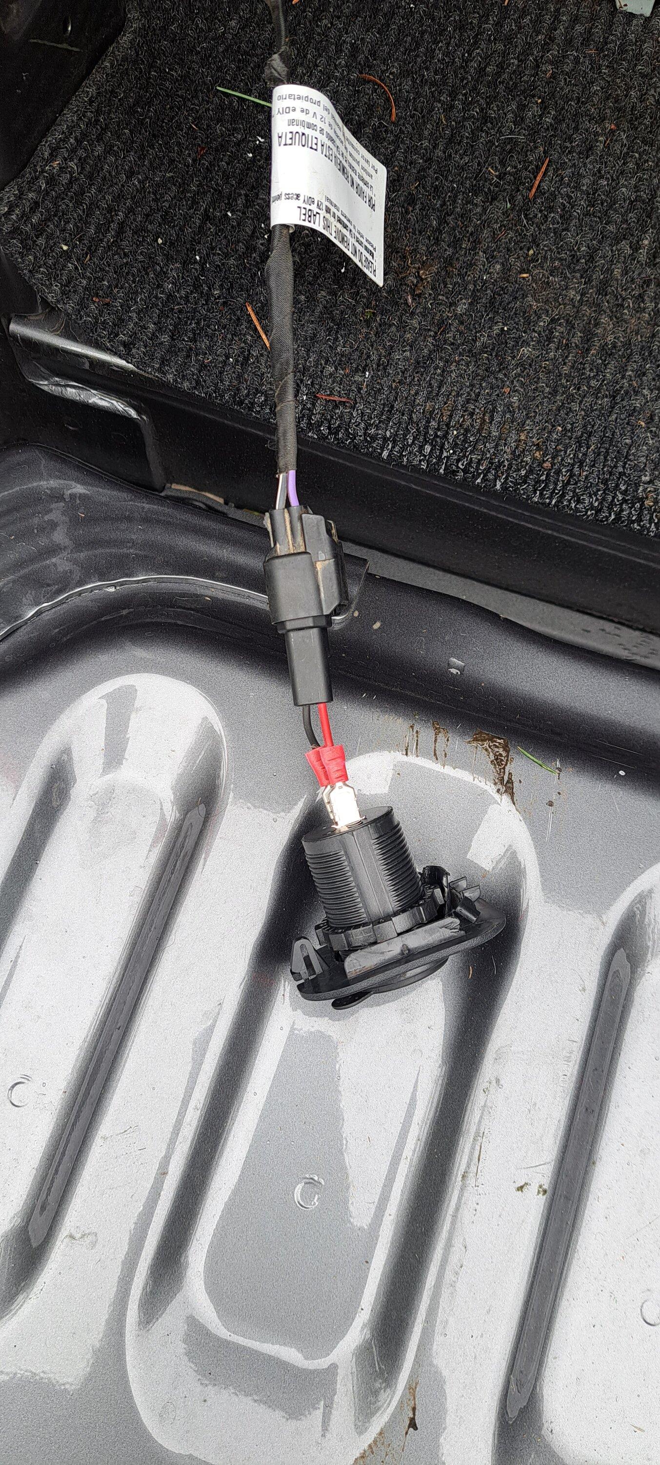

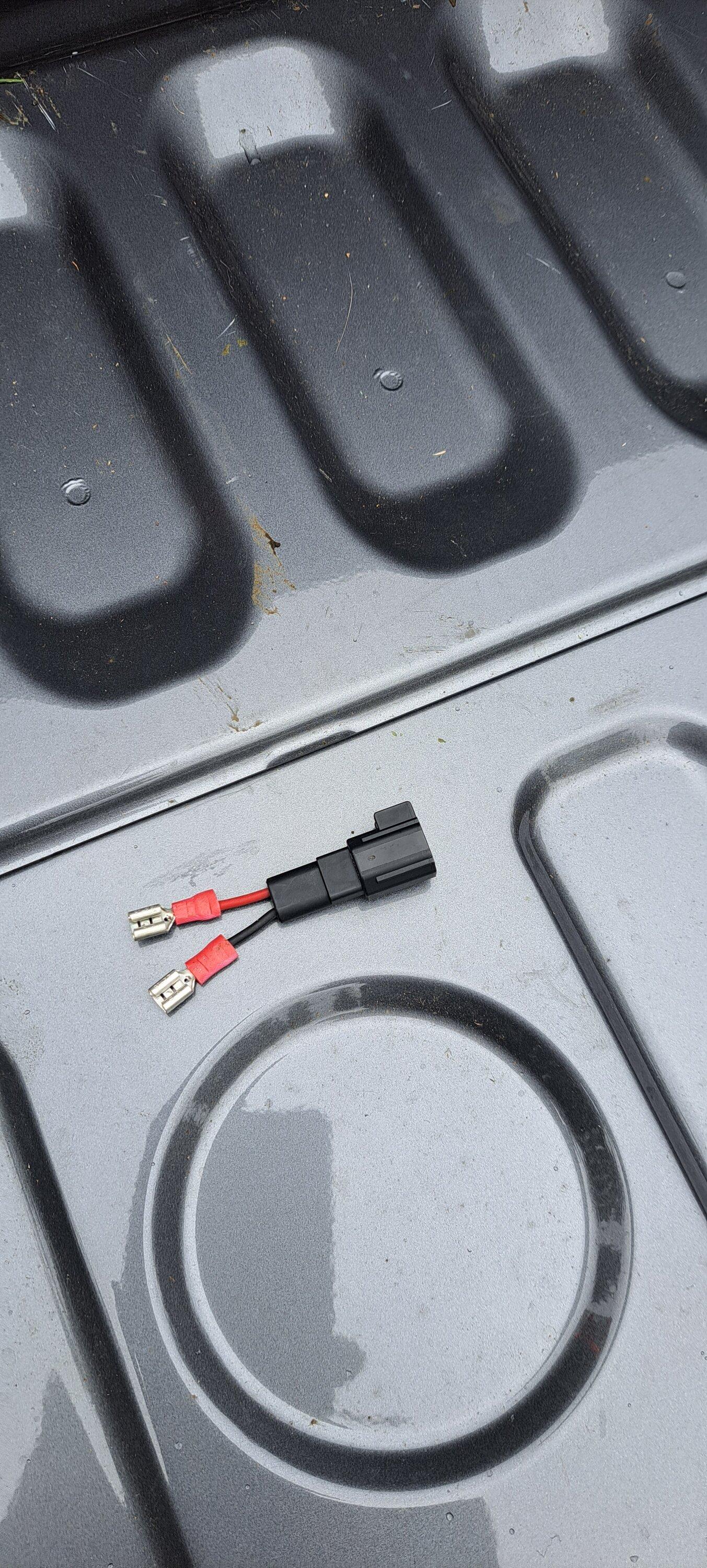

I shortened the provided pigtail, attached it to the 12v plug and connected to the car. Easy, gave up no cubby use.
