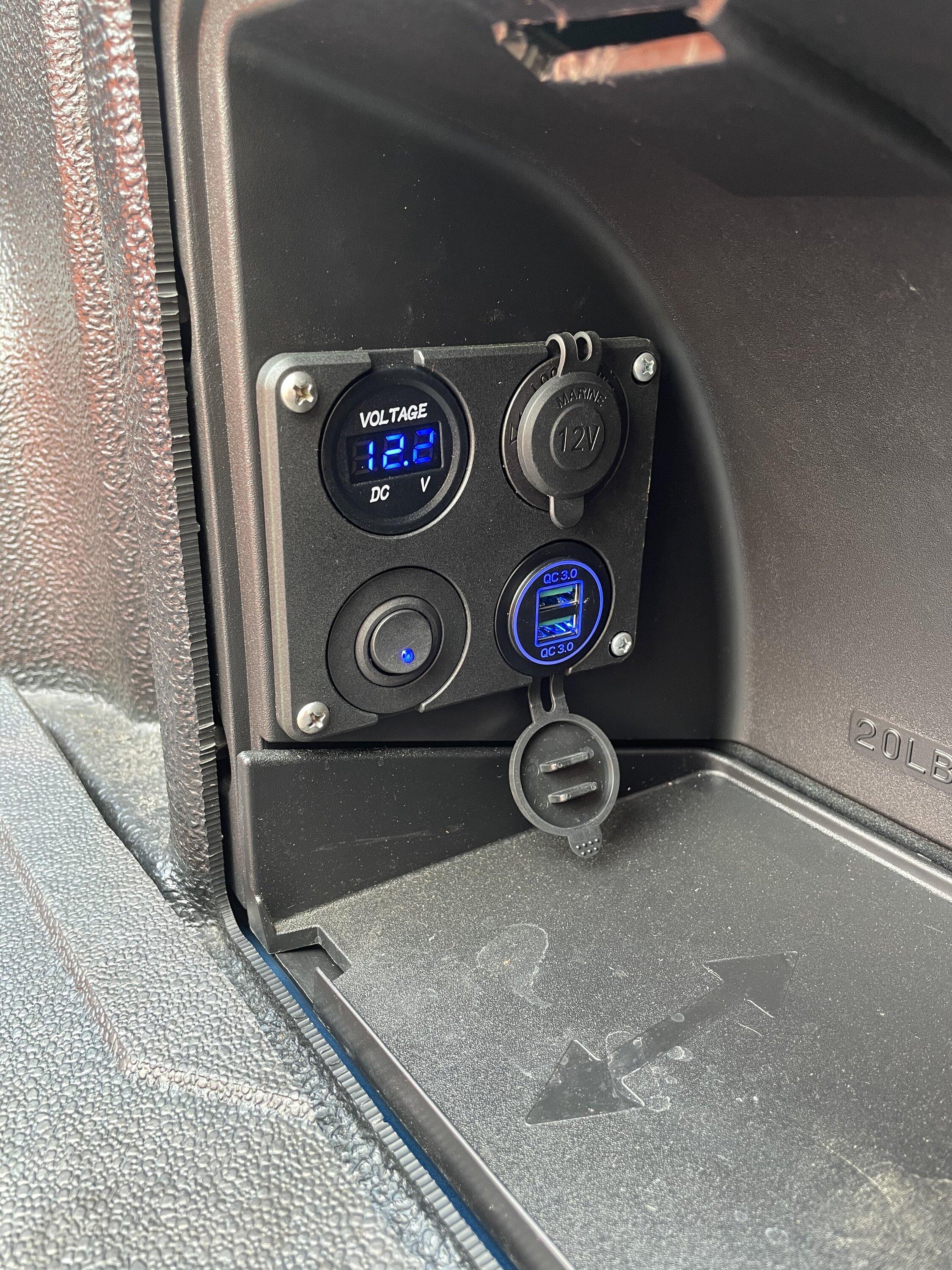

I have seen other posts of only being able to install this cubby accessories 12volt on the right side of the cubby.
I was able to do it where you can see it and use it from the tailgate.
The cubby has to be removed, all the accessories hooked up. I pushed hard on the cubby to allow it to drop in. Under the truck I removed the black cover box. Pretty much the 2 long usb and cigarette light plug you have to loosen all the way and push in towards the inside of the cubby.
Then unloosen the fender liner and tighten from the inside.
I had it all wired before I pushed it in.
Hope this helps someone.
