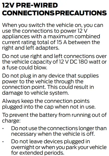

It's in the owners manual... 180 watts (15 amps) **edit: COMBINED TOTAL for BOTH**. Likewise is the 120v power outlet (if equipped) which is limited to 400 watts (3.3 amps) **edit: COMBINED TOTAL for BOTH inside and bed location**.

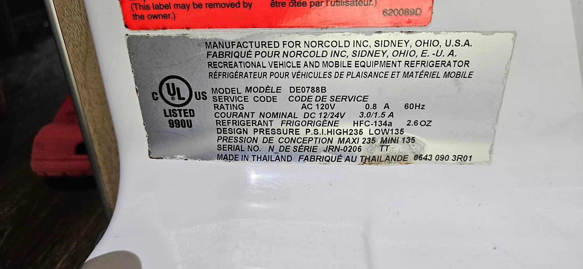

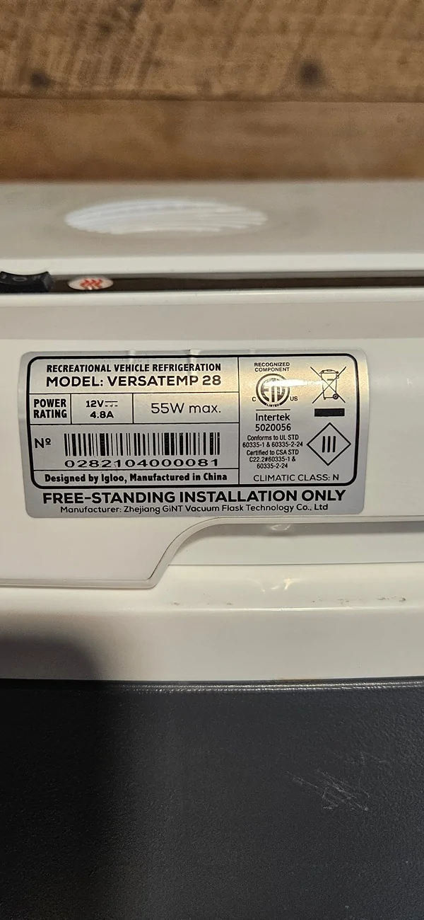

Here are a couple examples of what we use...in our Maverick it is a DC cooler, requirements in photo, and our RV Fridge/Freezer, 3.2 cubic feet I believe and pick your power source.
Both would work amperage-wise, keep in mind motors take up to 2 or 3 times momentary voltage when starting so must allow for that when sizing your device.
I ordered my rear 12 volt plugs through @Maverick_Innovation_Designs (through Etsy) and highly recommend his products.
12 volt Igloo cooler
Ford Maverick 12 Volt bed outlet 20260621_123055
Ford Maverick 12 Volt bed outlet 20260628_145404
This is the rv fridge info.
Ford Maverick 12 Volt bed outlet 20260628_152854
Ford Maverick 12 Volt bed outlet 20260628_152523
Ford Maverick 12 Volt bed outlet 20260628_152518
Have a great day, and I hope this helps you in your search.

I believe you are right, or at least the ignition needs to be on to get power to the bed plugs in my 25 XL - No ignition on = no power to the rear bed plugs - I just tested that hypothesis.
Power is already off by the time I exit the vehicle to check the voltmeter.
It does make me wonder why the manual would state to not drain the battery by leaving devices plugged in overnight or when parked when there is no power to the plugs unless there are model trim/year differences...
