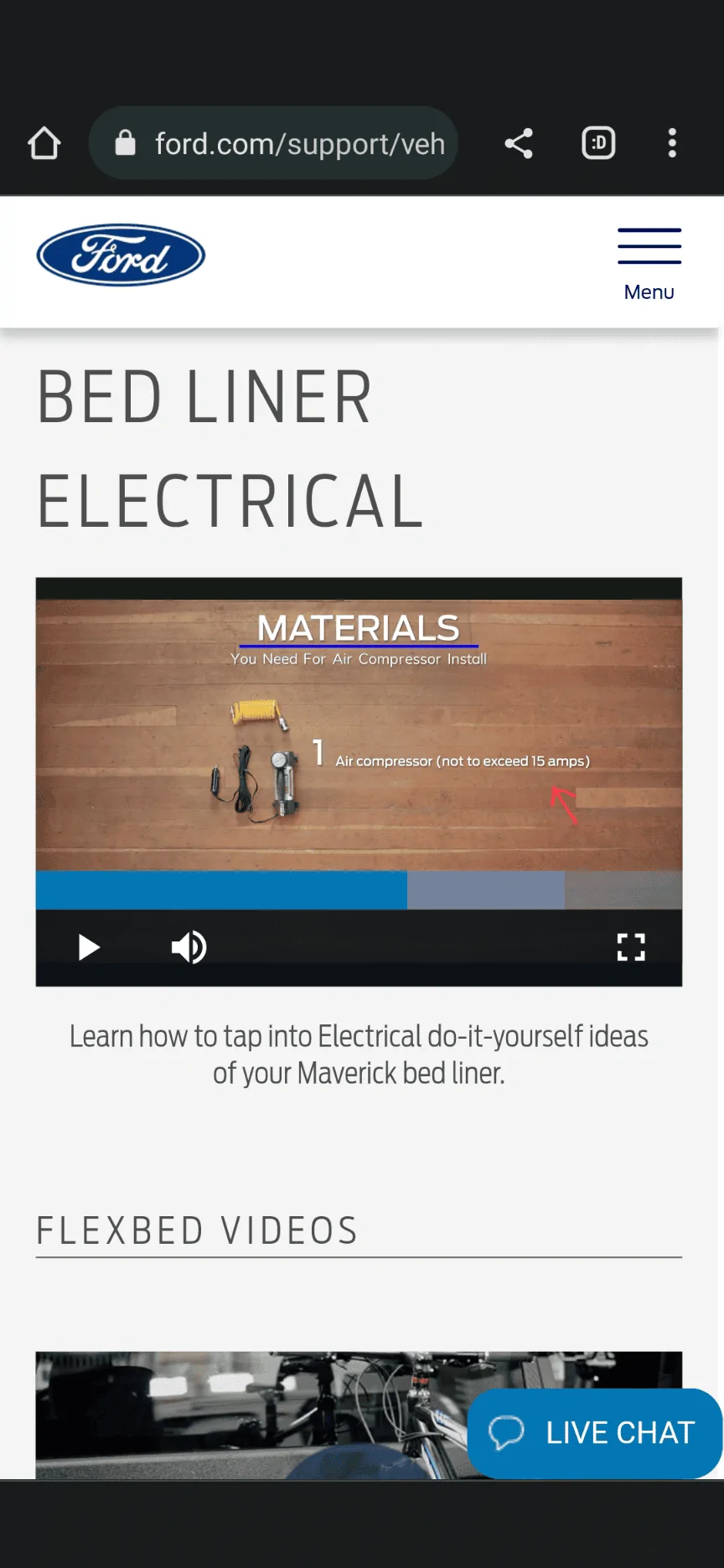

Ford recommends no more than 15 amps so there's not much you can run off it.
After watching this video I'm using the same setup. I have a hybrid, I don't know how it would work for EB.

Sorry, my bad. 😔 I was thinking of this video, but it's referring to the 12v connection.
Ford Maverick 110 volt bed outlet Screenshot_20220825-000038~2
