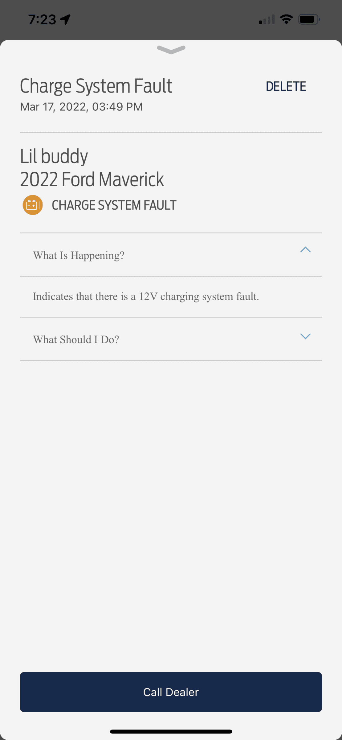

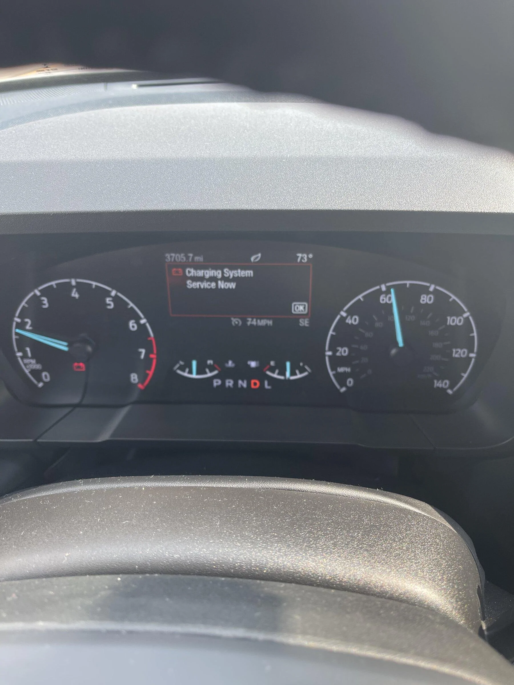

Agreed!! Got scared to crap on the way home from work today! Here is the picture of the message and alarm. It did it several times like five or six times! It would alert, click ok, battery light stays on, then would disappear, then out of the blue again it would alert, over and over for an hour and fifteen drive!
Ya that is the exact same thing as what mine was and right around the same milage. I think my record was 32 messages in a day. But in my case it was part of the harness that goes to the alternator. I have driven around 8k miles since with no issues
