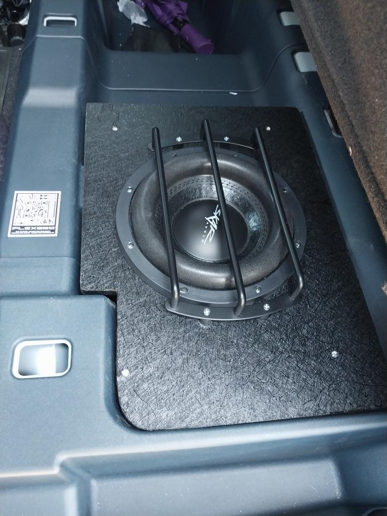

Here is mine, fits clean. This is a Hybrid.
Nice, what woofer is that?
And it's hard to tell for sure but is your box very.. not box shaped? I think it would need to be tapered on top and if it's as far center as the pic seems to show it would have to have a very interesting shape on the bottom. Is it fiberglass?
10” sub and your box is shaped like a trapezoid? How much volume did you need?

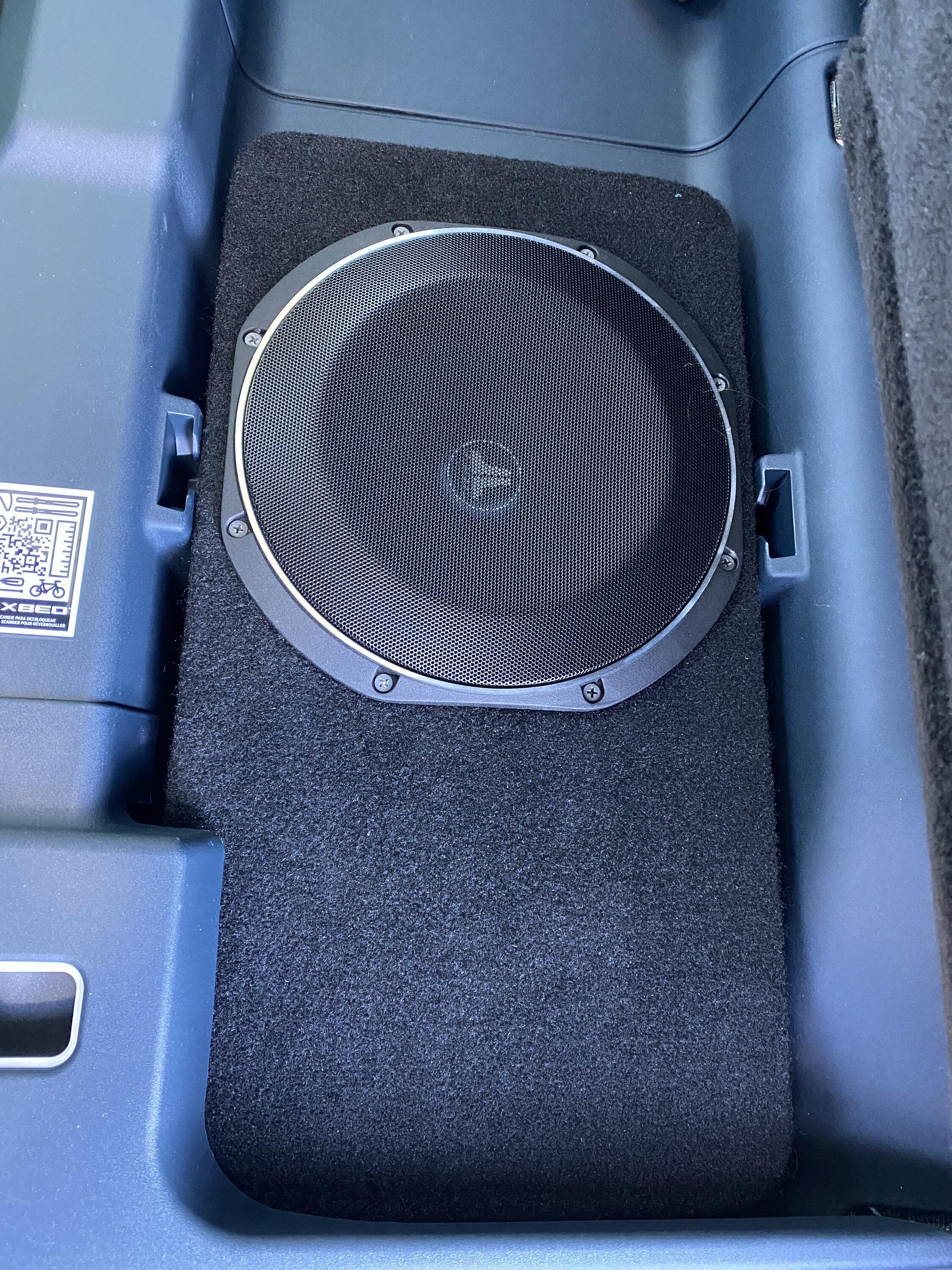

It’s a JL audio shallow mount sub, but it still hits hard. It is not a fiberglass box.

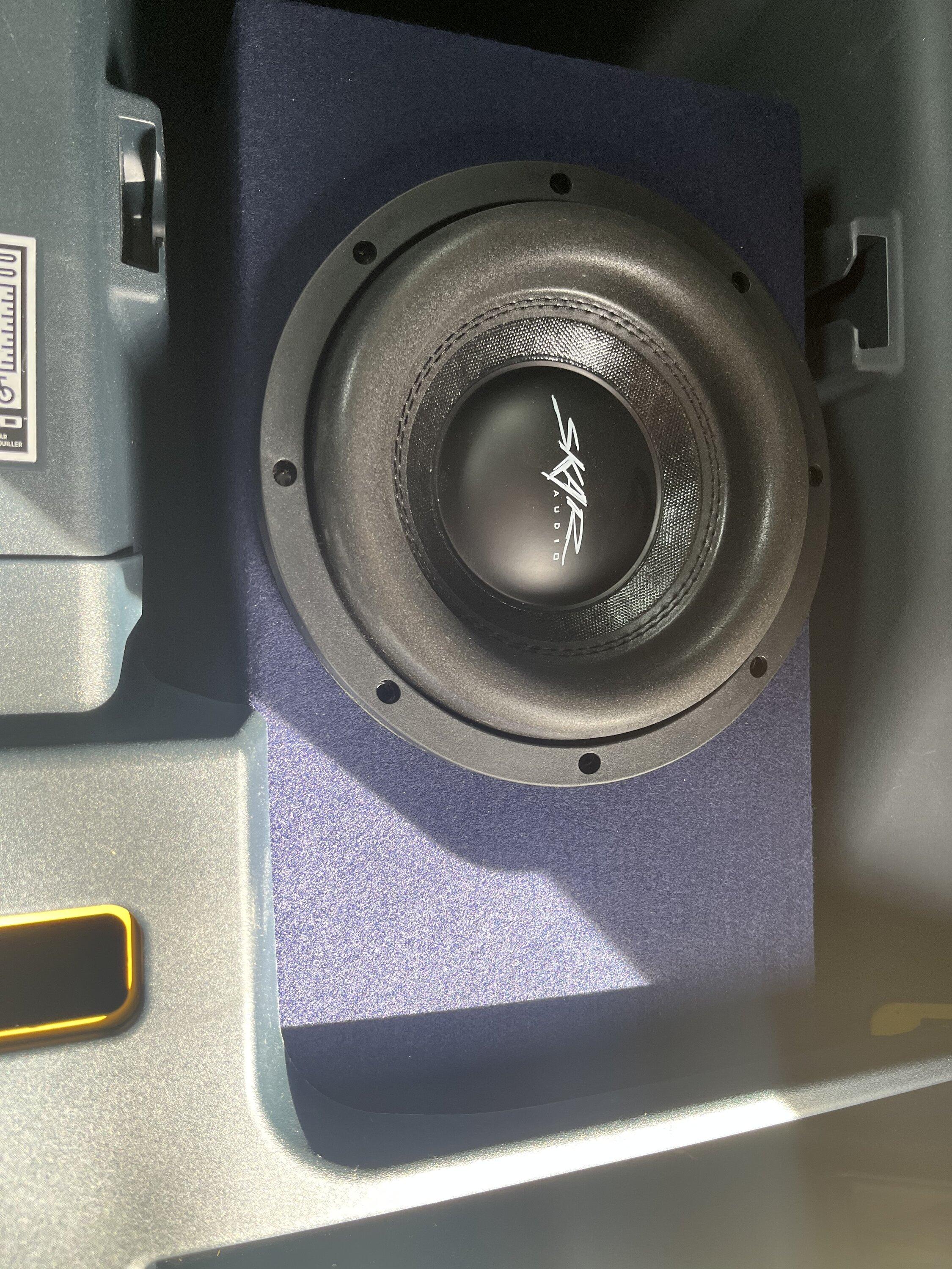

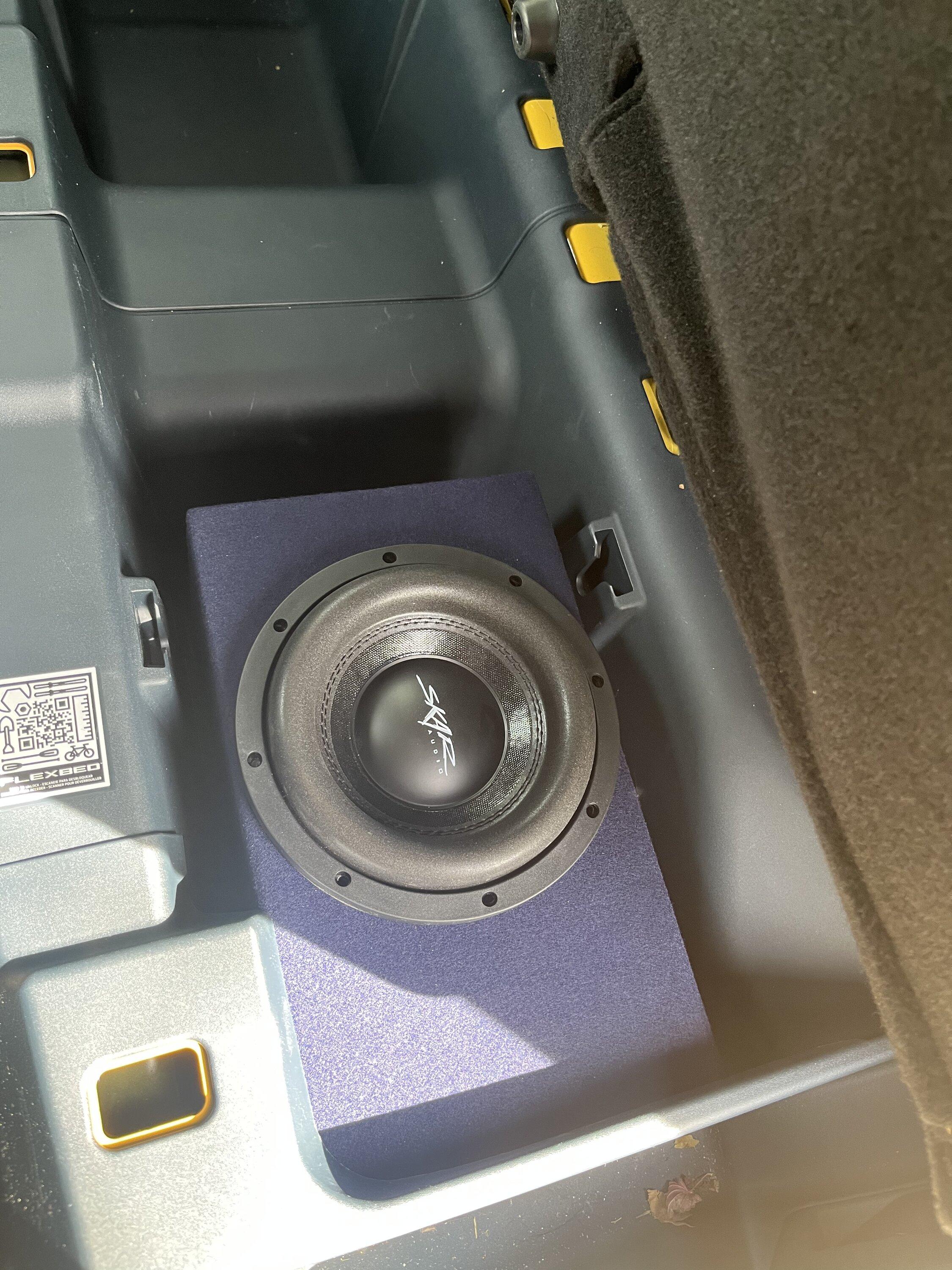

I did the same thing, here is my first box, but im now building a lower box and actually going to add a 2nd 8" sub to other side. the shallow mount sub does sit high- this box was i believe 8.5 high, with my grill when i place seat down it just click on its own. lol I tapped into rear speakers with a recoil LOC off amazon for $25 but might switch on the the JL audio one.. Love the skar sub

2024 Maverick, 2017 Focus ST
I based my box exactly off what you did here. However I get very little bass running my kicker cxa400 amp which is 1ohm stable and I have the same speaker wired for 1ohm which should push 400+ rms. What could I be missing?
