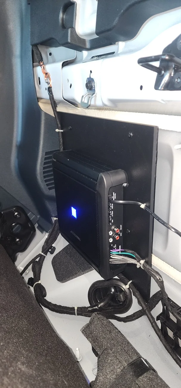

Just get the Kicker aio powered10" micro sub. Comes in a small box with built in amp, small enough to mount on the rear wall where the B & O amp mounts.

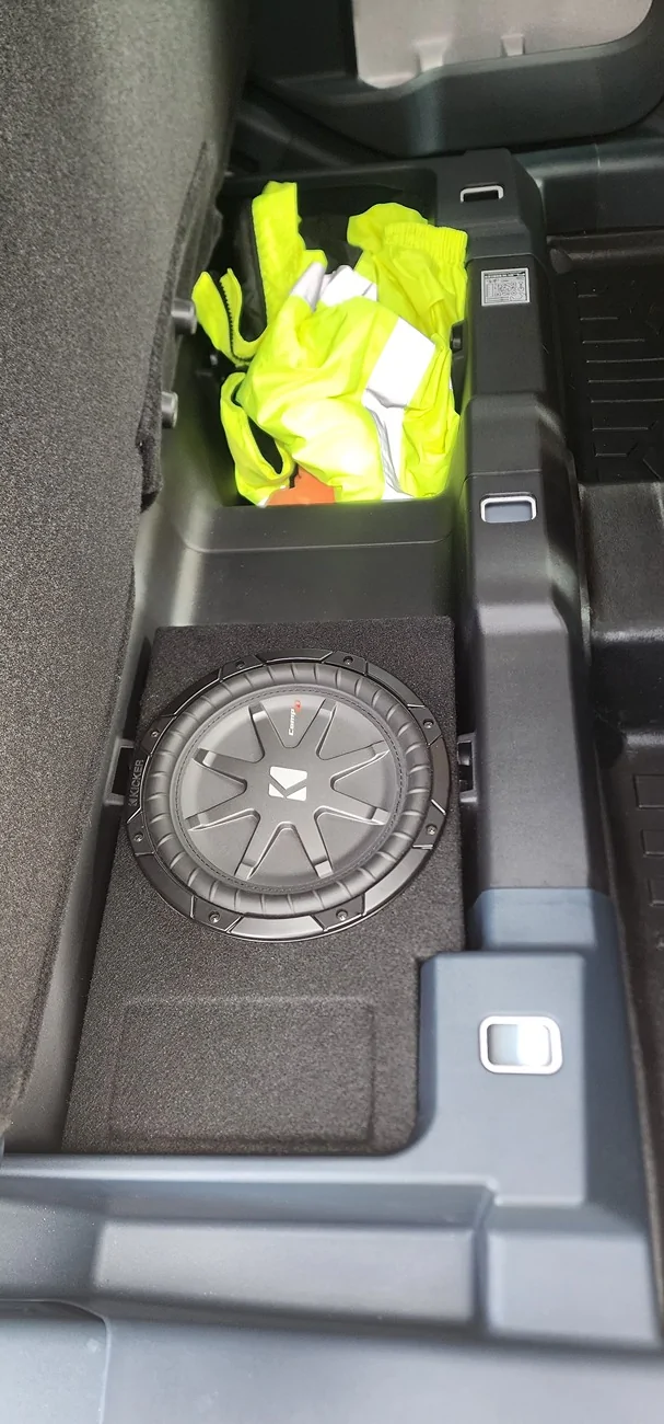

No I don't have the kicker hideaway I have a kicker 10-in shallow mount sub in a box under the passenger side of the rear seat and my Alpine amp is mounted where the OEM amp would mount on the rear wall.
