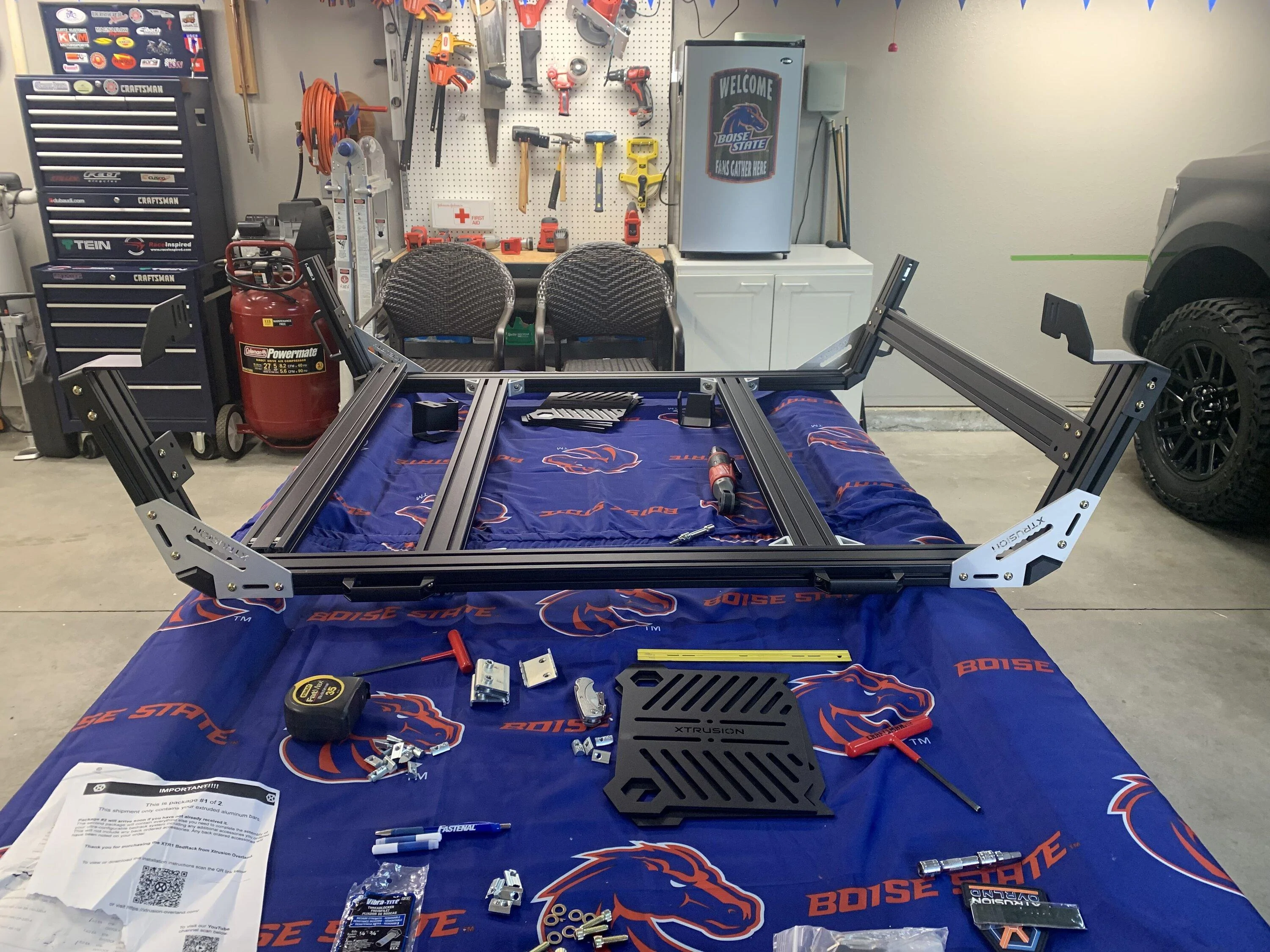

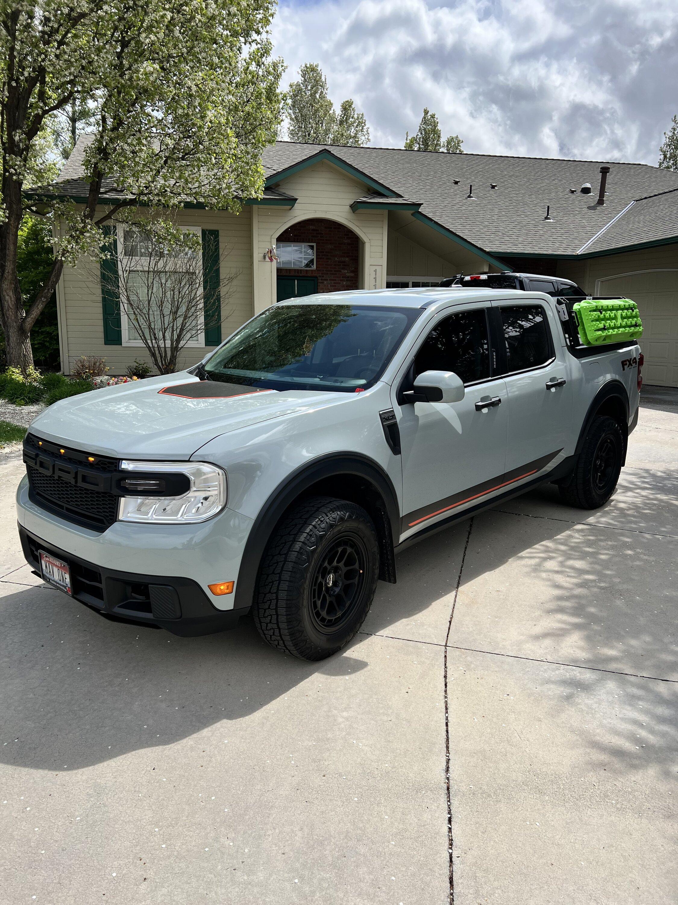

Finally got my XTR1 this week and will finish getting it on this weekend!
Ford Maverick Xtrusion Overland XTR1 Bed Rack released IMG_1355

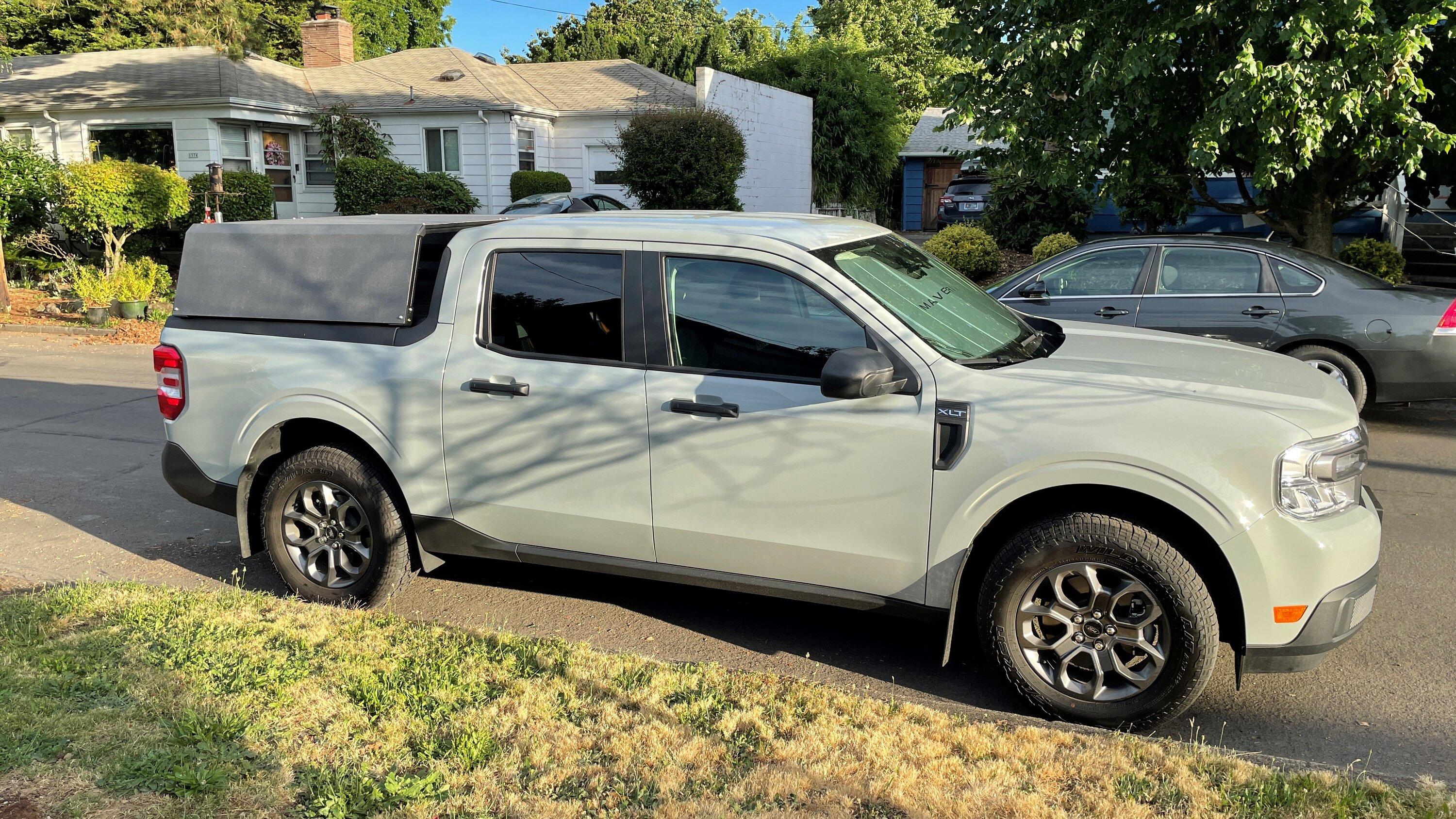

HI Alan,
Love the rack. We are looking at getting a new Maverick for our adventure rig. Can we use one of your racks over a softtopper on a mav?

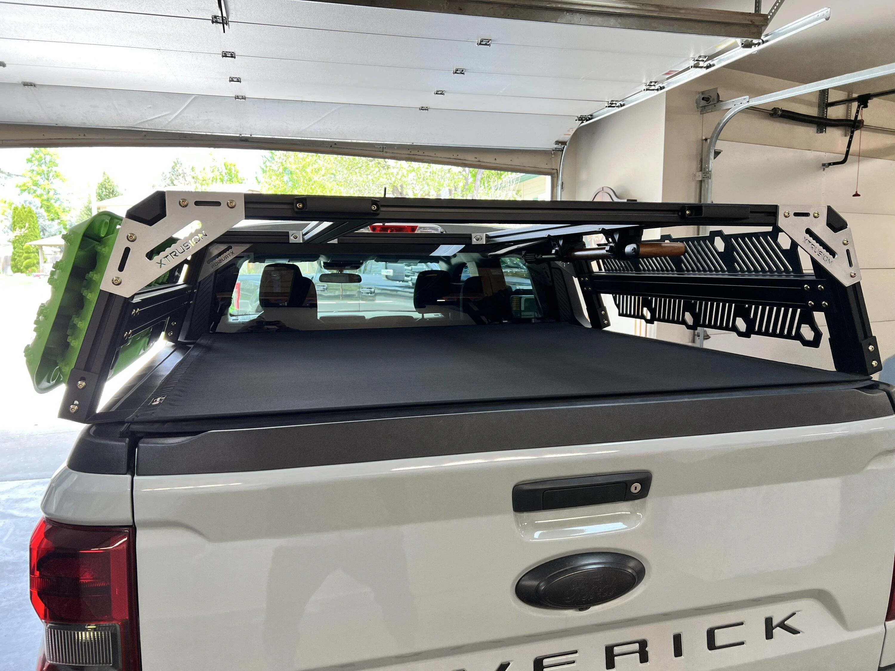

Yes and no (I cut the foam insulation where the brackets run under the tonneau). Tonneau bracket placement strategy is key. This Truxedo one has 3 on each side. I have the ends right next to the Xtrusion brackets and one in the middle on each side. It would be ideal to have the bed rack hanging from above with as little weight on the bed/xtrusion brackets when installing. Then you re-install the tonneau and "torque" the tonneau down over the brackets making a tighter fit. Then I would release the tension on the bed rack and tighten the bolts. Rack bolts should be tight if you measured everything correctly. Just tighten the 4 on each post going to brackets. I need to make a youtube video on this....
Did you ever make a video for this.? I am wanting the same rack and I have the Truxedo tonneau already. Thanks!

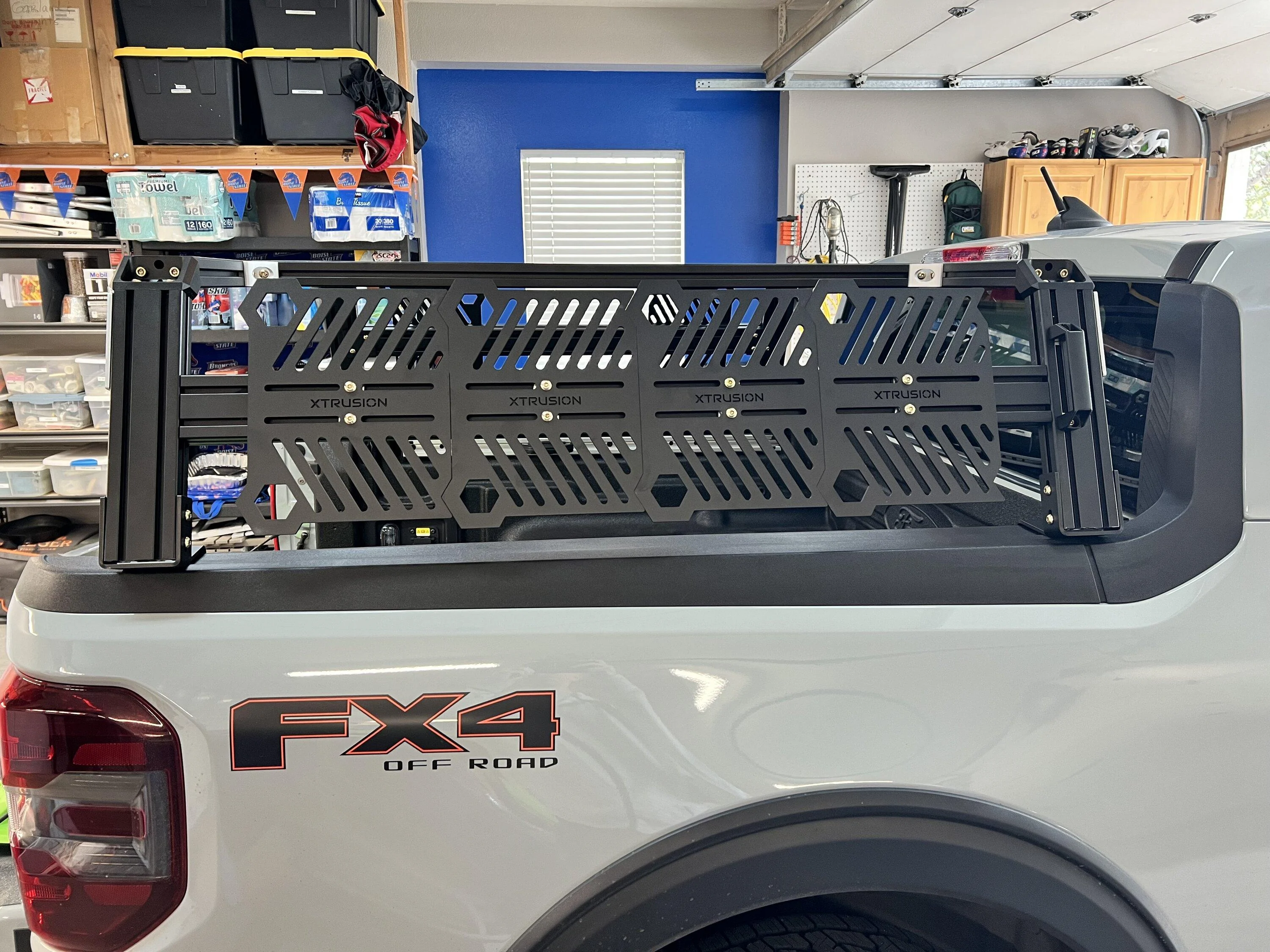

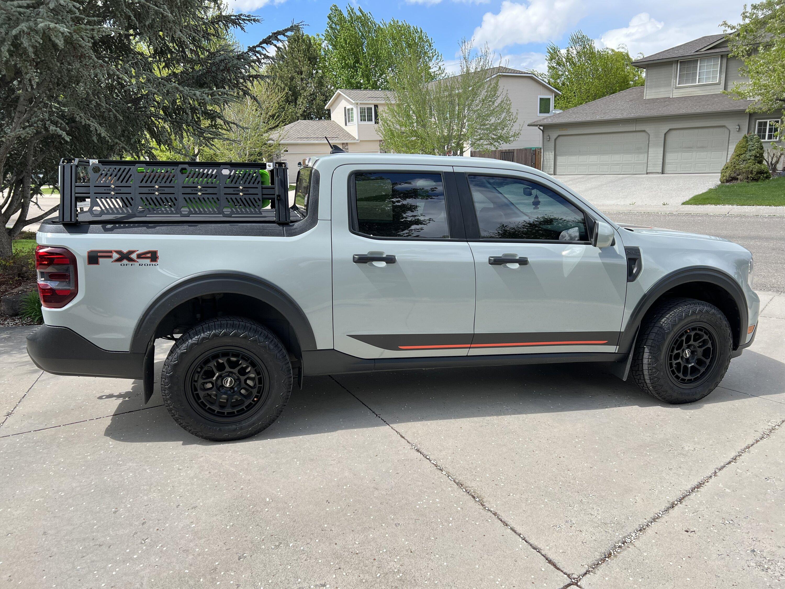

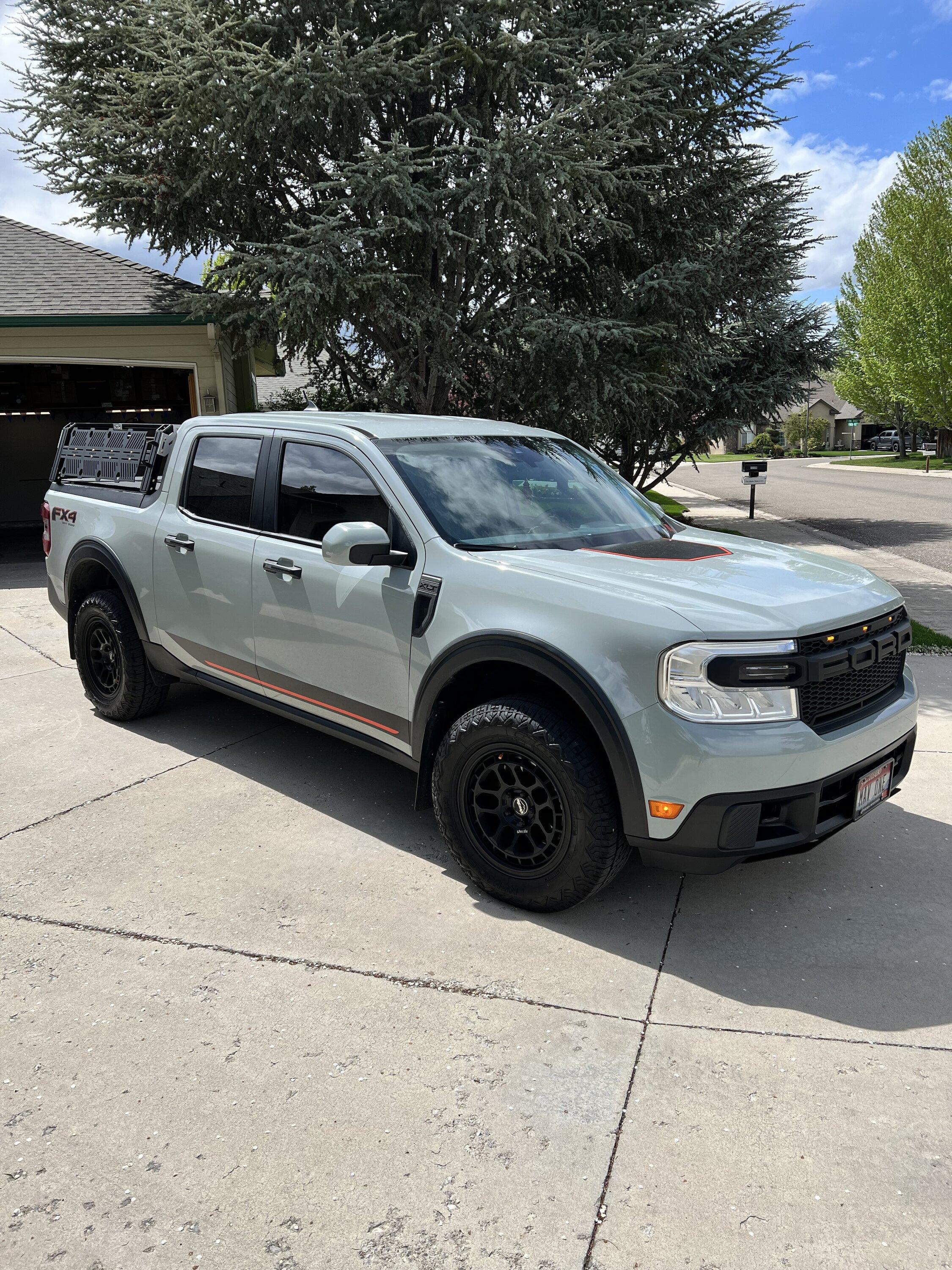

Done and ready for my RTT to go on
Nice, Love all the side panels that close it out.
Is that the 15" height? Looks like its JUST below the CHMSL/tail-light.

Thanks! It's 14" height and is now on the back of my Frontier after I replaced the crossbars to accommodate for the difference in width.
