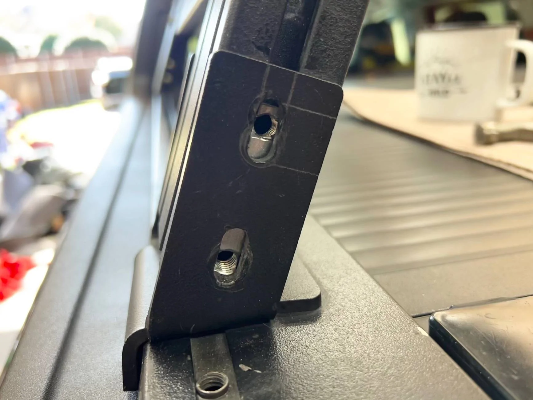

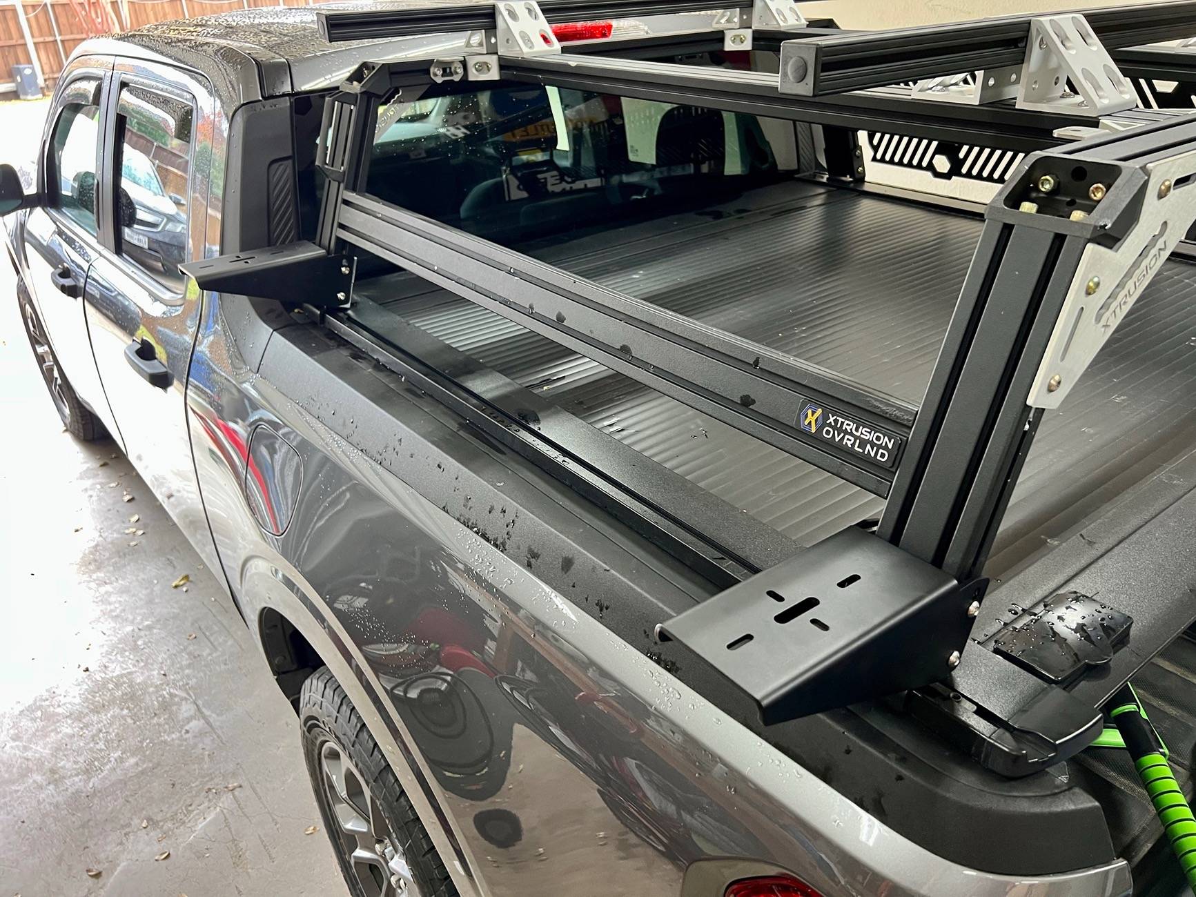

As expected, the holes on the mounts did not match the holes on the base of my rack uprights. And, luckily, the mounts were 0.25" wider than the base of my rack upright base.

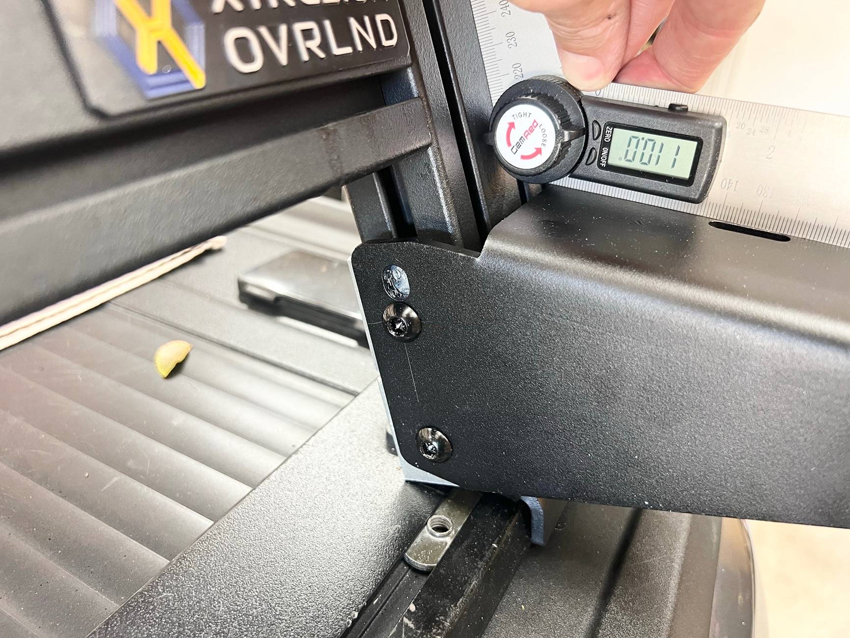

The Xtrusion Overland uprights are at a 20-degree angle. So, if I want the mounts to be level to the ground I need to drill a hole allowing the mount to be at 110-degrees from the uprights.
Using some shade-tree methodology, I determined the location where I need to drill a new top hole in the mounts.

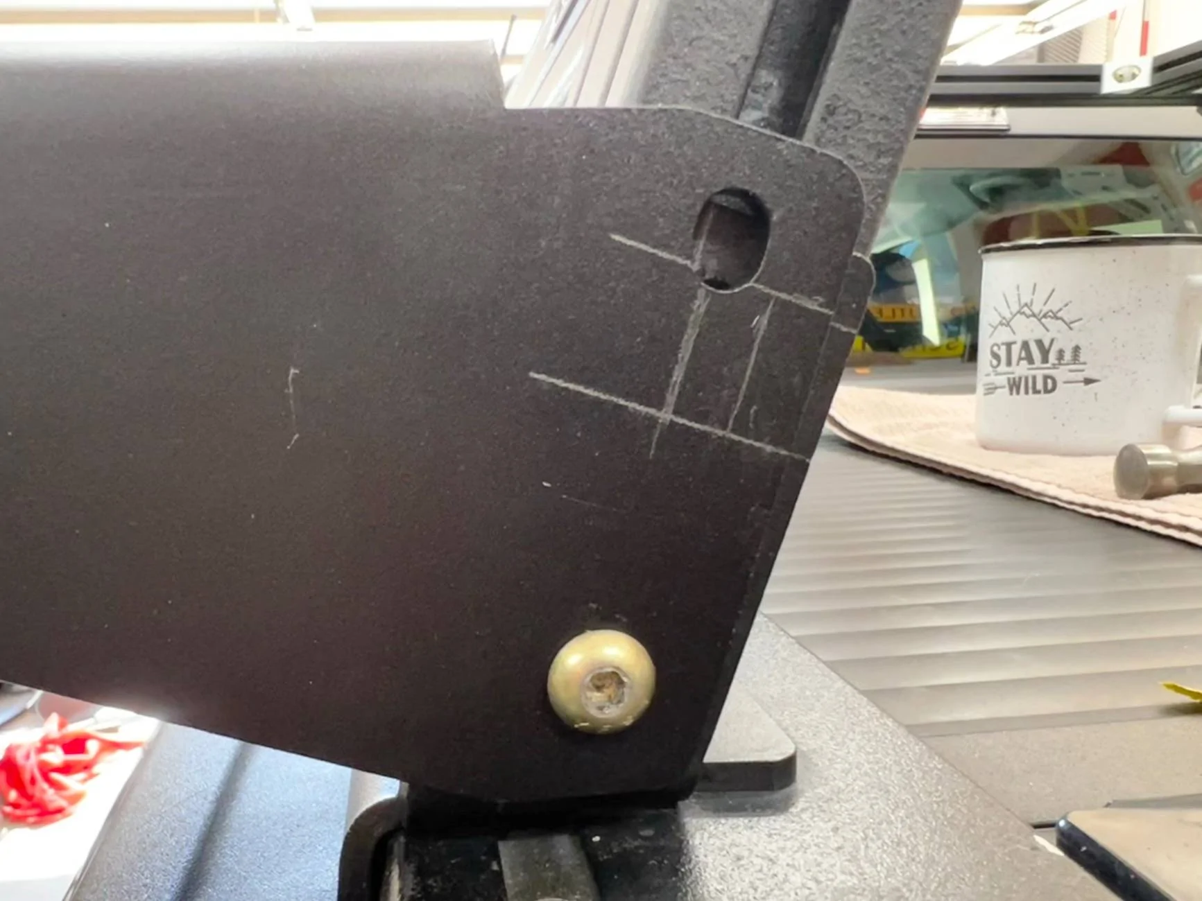

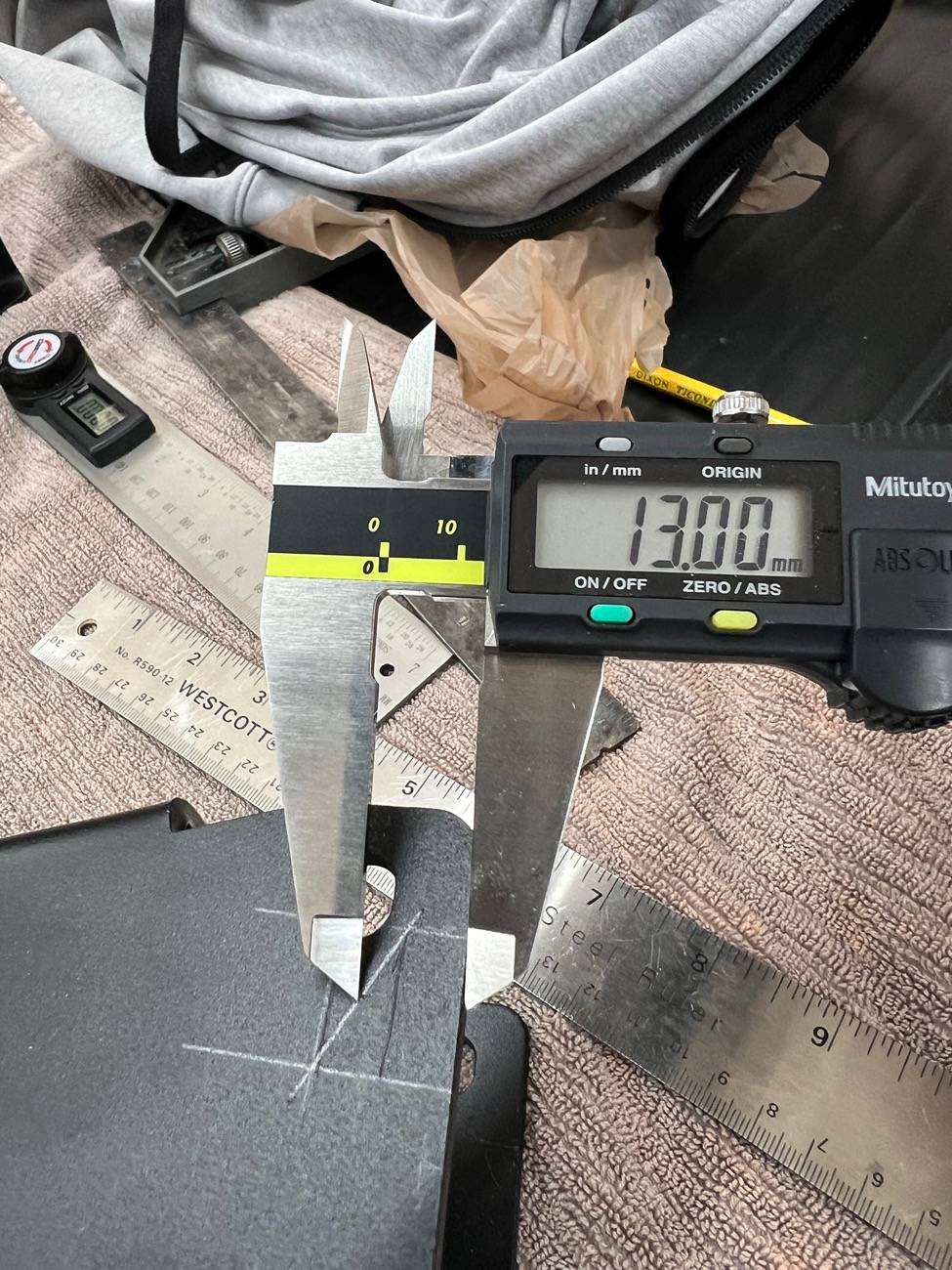

Prior to drilling, I took some measurements so I could more easily mark the hole on the opposite side of this mount and both sides of the second mount.
The new top hole needs to be 13mm from the back of the mount flange and 26mm from the top of the mount flange.
Ford Maverick Installing BillieBars Bike Mount Kit on Xtrusion Overland XTR1 Rack IMG_9750.JPG
Ford Maverick Installing BillieBars Bike Mount Kit on Xtrusion Overland XTR1 Rack IMG_9748.JPG
I drilled a 5/16" hole as I wanted a little bit of play in case my super duper scientific method of measuring was incorrect. Apologies in advance to any machinists reading this thread. lol
After drilling, I test fit the one side of the bike mount to the upright mount to ensure the holes were aligned and the mount was at the desired angle. Then I removed it and drilled out the other flanges.

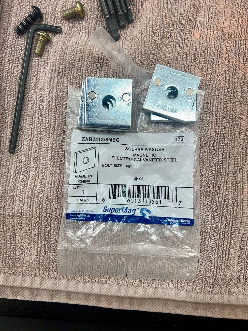

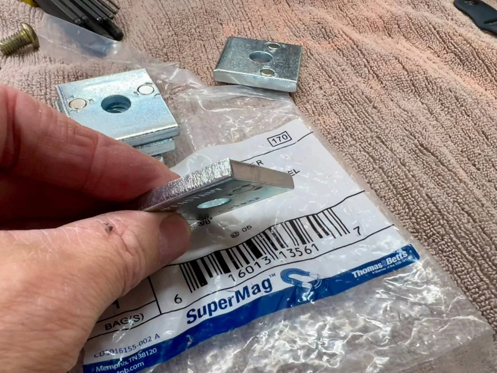

To fill in the 0.25" gap, I used some strut channel washers that I picked up from Home Depot. They were exactly 0.25".

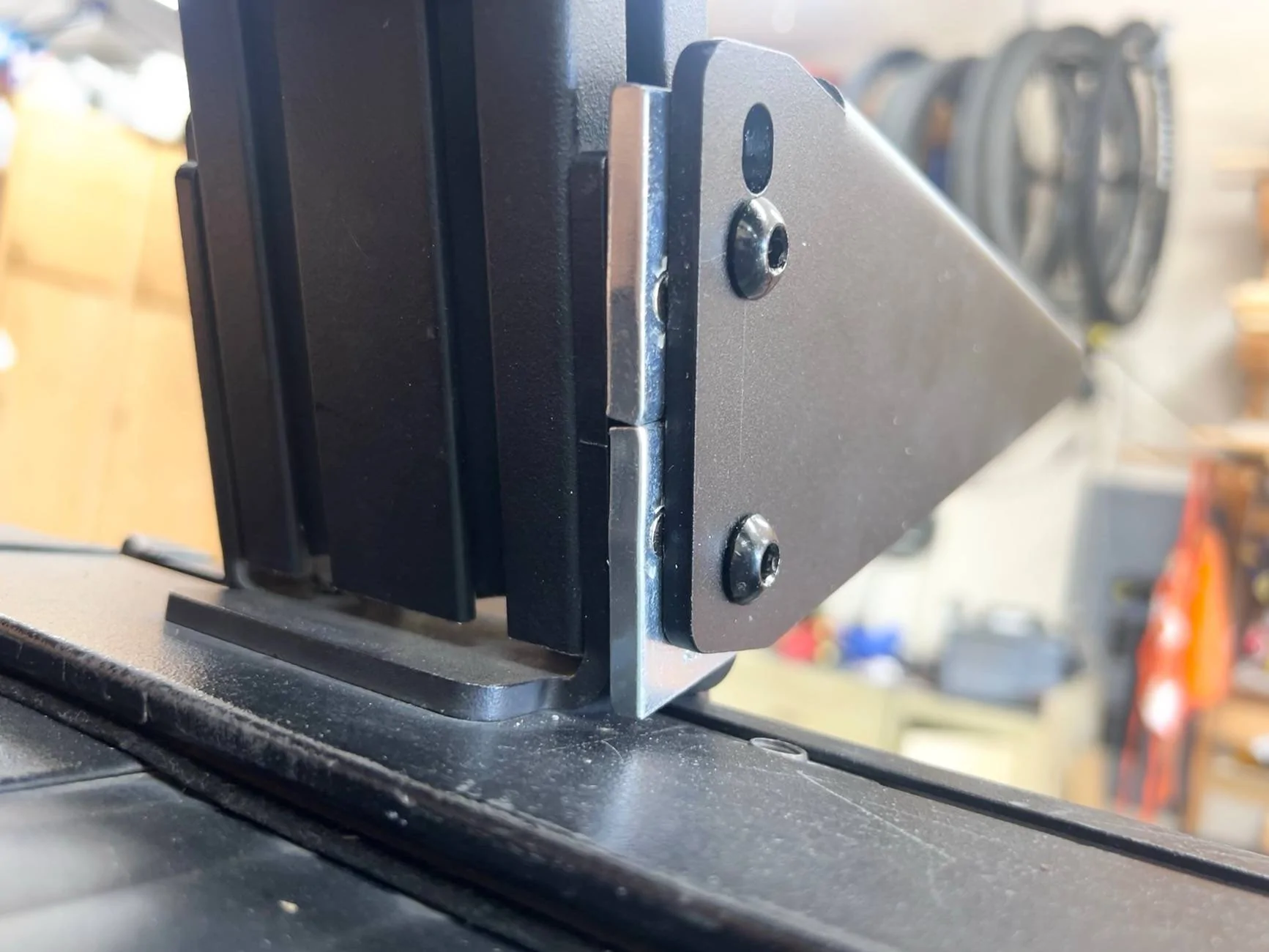

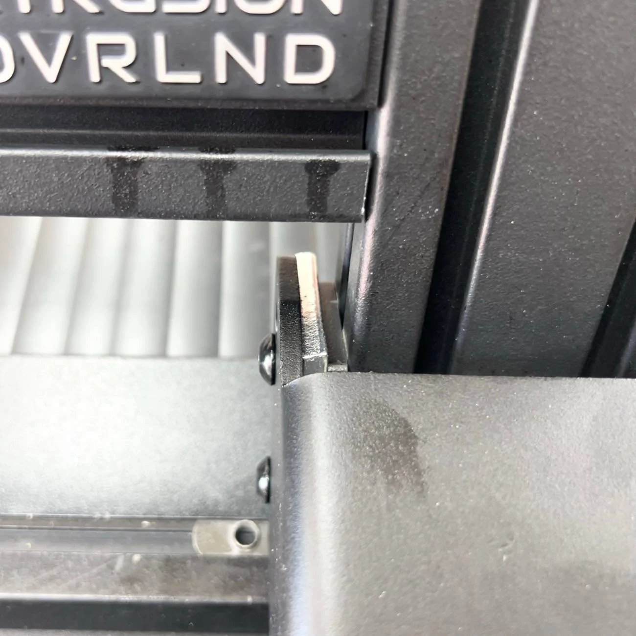

Here's a few photos with the washers in place.
Ford Maverick Installing BillieBars Bike Mount Kit on Xtrusion Overland XTR1 Rack IMG_9772_edited
Ford Maverick Installing BillieBars Bike Mount Kit on Xtrusion Overland XTR1 Rack IMG_9770_edited
Ford Maverick Installing BillieBars Bike Mount Kit on Xtrusion Overland XTR1 Rack IMG_9769_edited.JPG
Lastly, you'll need bolts longer than the 5/16-18 x 5/8" bolts currently in place. I used 3/4" long bolts on the non-washer side and 1" bolts on the washer side.
Before you tighten everything down, use some type of angle finder to ensure the surface of the bike mount is 110-degrees from the upright. The 5/16" hole allows a couple degrees of play in the mount.

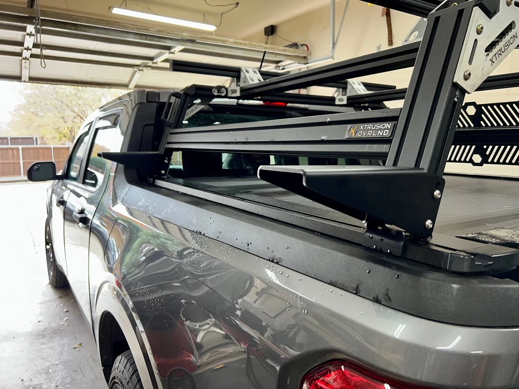

I ended up purchasing some 1UP Equip'd components and putting together my own rack. The BillieBars mounts came with hardware to mount a 1UP roof rack and the Equip'd rack has the same dimension slots - so it worked out perfectly. I'm super happy with how the project turned out.
