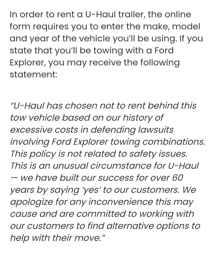

I loved my Sport Trac right up to the point I needed to rent a motorcycle trailer from U-Haul.
U-Haul prohibited any of their trailers from being towed behind Ford Explorers model years 2002 to 2010, including the Explorer Sport Trac.
At that point my Sport Trac became a useless vehicle to me. I sold it within a few months.
They rented me a motorcycle trailer to pull behind my Toyota Yaris but not the Sport Trac
U-Haul has a serious hate relationship with Ford ever since the explorer incident. Even with modern Explorers, most locations wont rent you anything over a 2,000 lb capacity, even though they are rated for 5,000 lbs.
