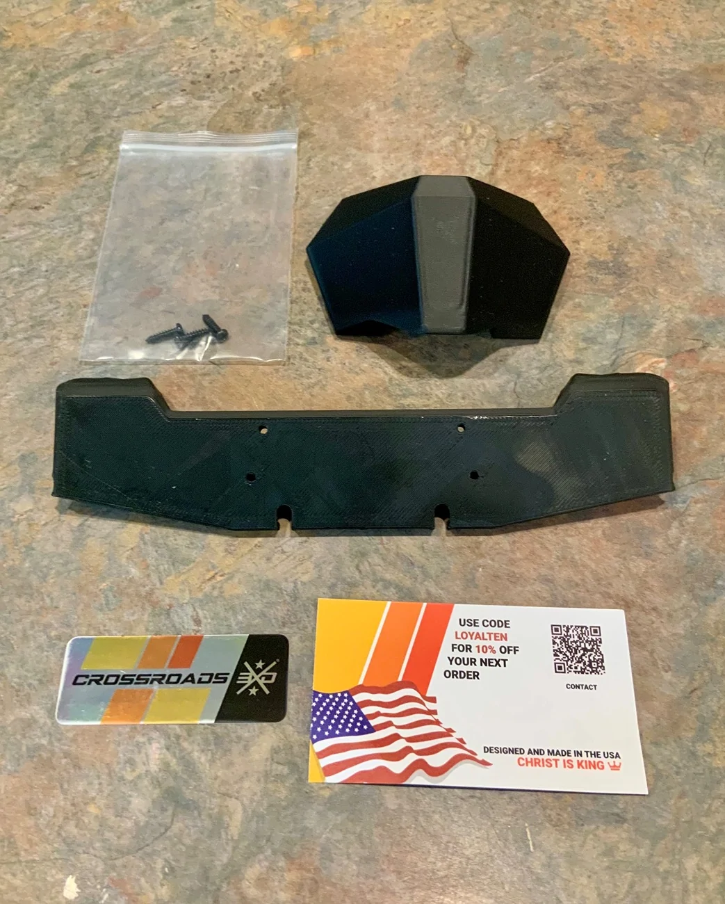

I used this 3D Printed Camera Mount on the outside that connects to the 3rd brake light without any modifications requirements

That mount has been solid and works perfect for me. I still appreciate you sharing that before. Keeps the camera dry in the rain too.
