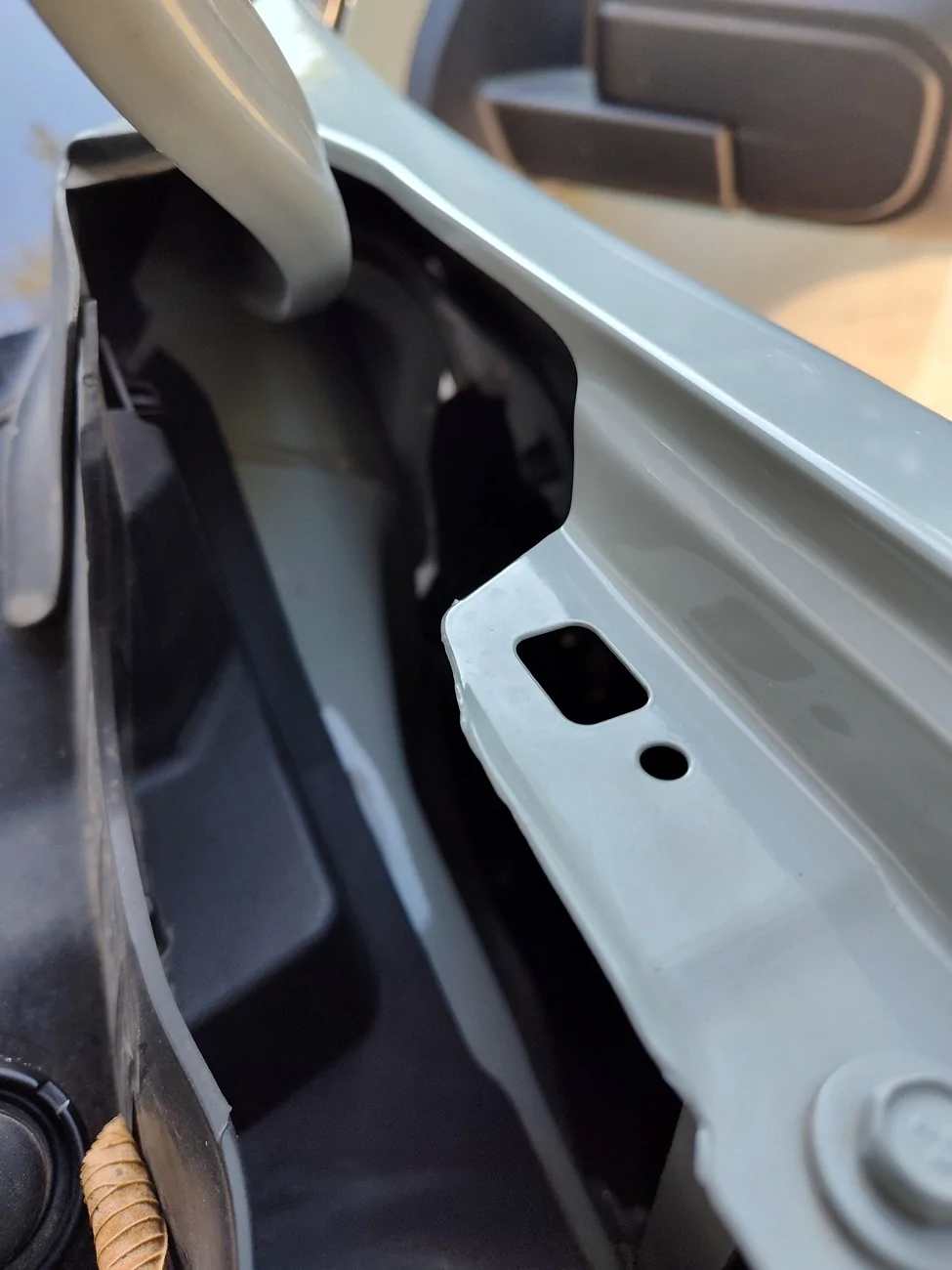

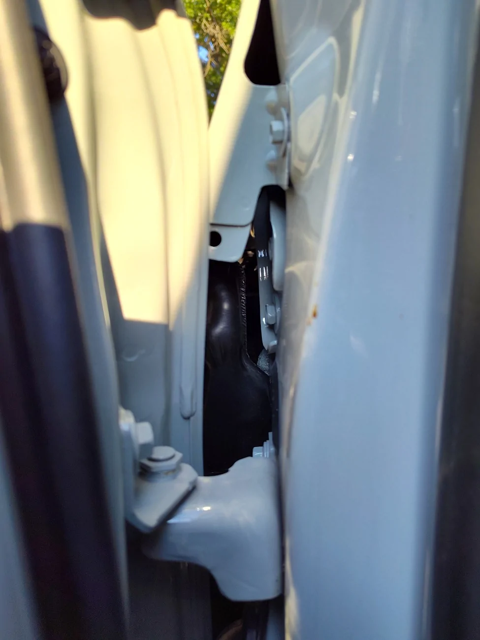

If it is pulled up higher (probably not attached at bottom, just stuck there), it wedges over the hood/panel attachment point and is squeezed tighter.
Long coat hanger bent for a hook on end will grab it for you.
Just has to be pulled back/up close enough to inside hood access area to grab it.

Camera focused too close maybe, but pic shows you pull it on backside of braces so it can't flop over, and other pic shows I already got another gap at top so I give up on that part.
