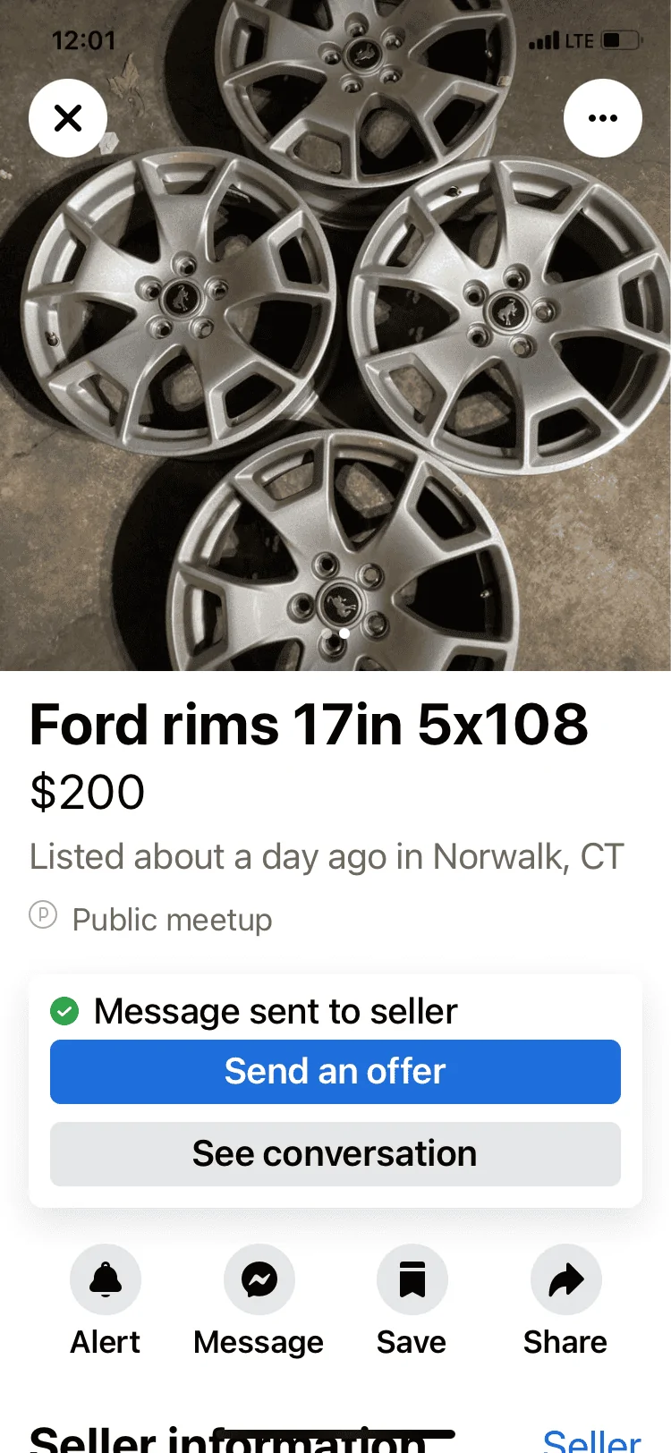

Well that is unfortunate and kind of surprising given that it’s the same platform.
Wheels still fit you just need to use the original lug nuts from your Maverick or purchase fancy lug nuts made for the F150 m14x1.5. they use larger lugs I'm sure to keep with the payload capacity of the Maverick vs the bronco sport. It's a good thing

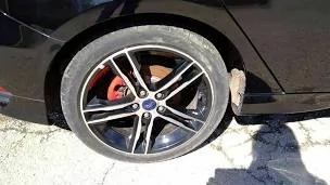

Yes they will fit. These are 18"mach E wheels with a et47 offset. (I do not have my Mav yet) Others on this forum have installed them and they fit with no rubbing. All Mavericks have a 5x108 lug pattern.
