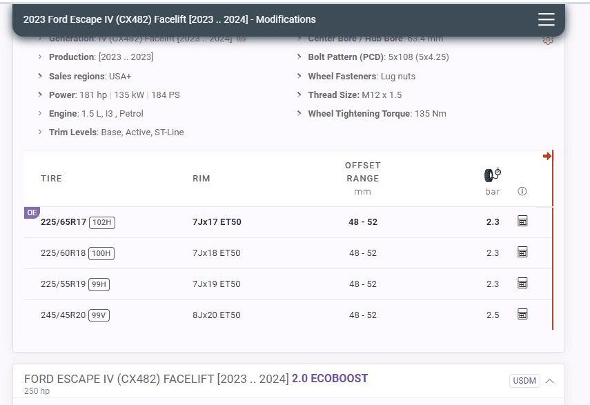

Here's your escape Offset:
Ford Maverick Will Escape wheels fit my Maverick? 1702860824756
So, you're comparing a 37mm to 48 or 52mm offset.... So 11 to 15mm.... Let's just call it a 1/2" difference... That's the spacer you want if want identical offset... Otherwise, your rims/tires will sit more inboard...

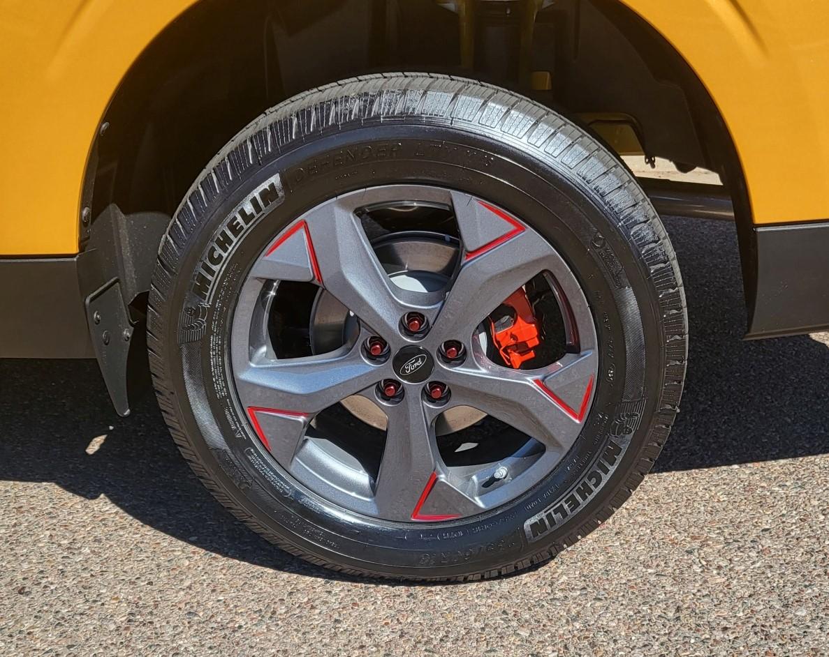

On my cyber orange Maverick, I am running Mach-E wheels (offset 47.5) and I have no problems with fit. Tires are 236/60/18.
