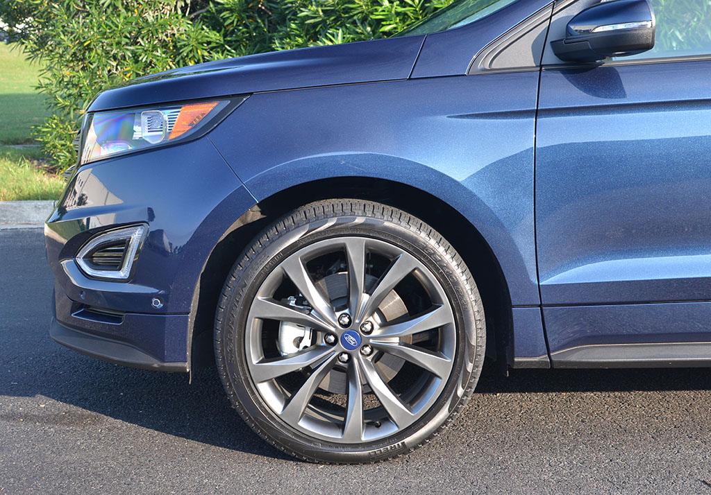

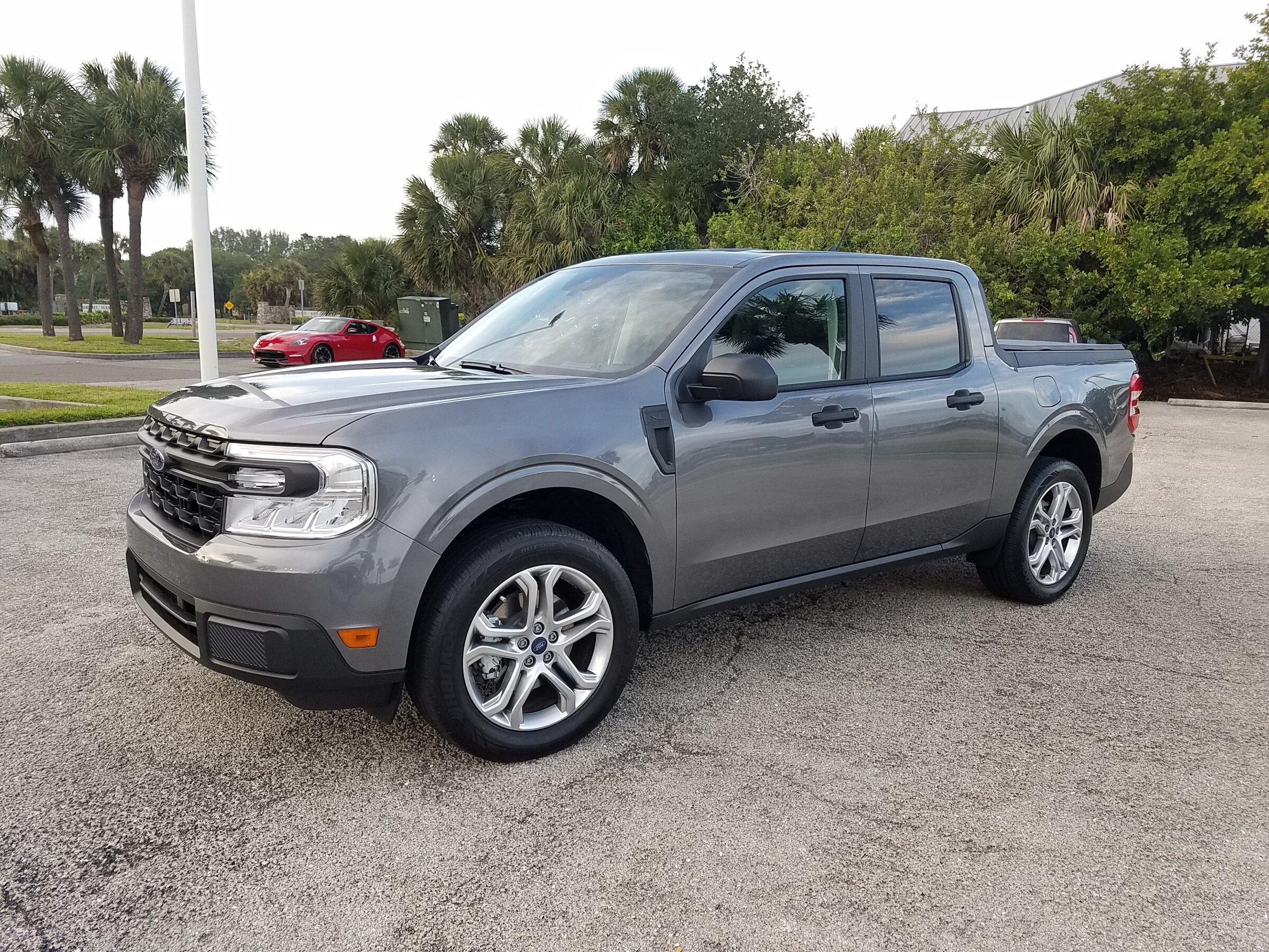

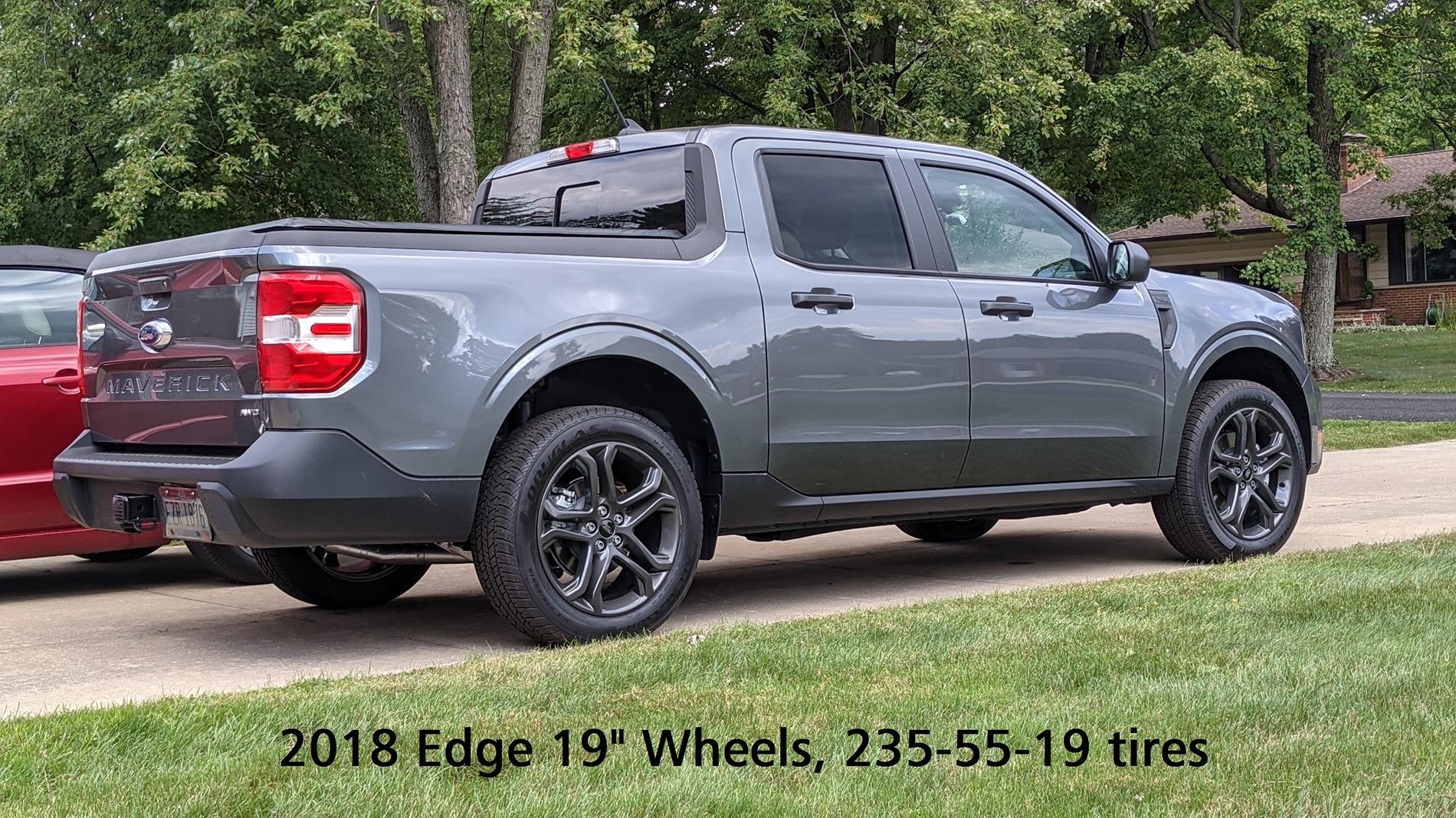

There's been a lot of talk about wheels, but your EDGE setup seems to make the most sense:
  • 19" wheel looks appropriate.
  • Tire fills the wheel well nicely.
  • There is still some side wall for ride quality.

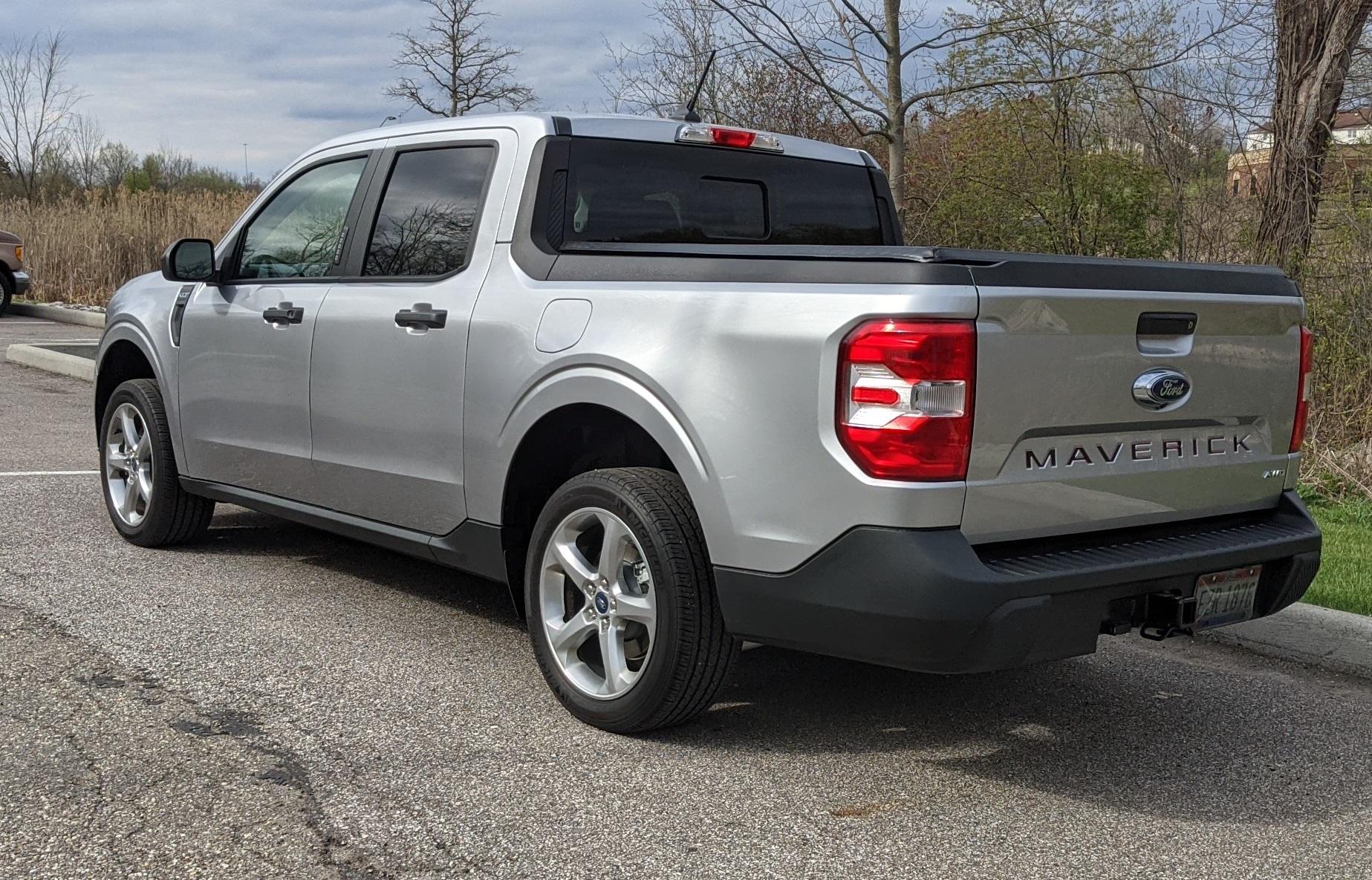

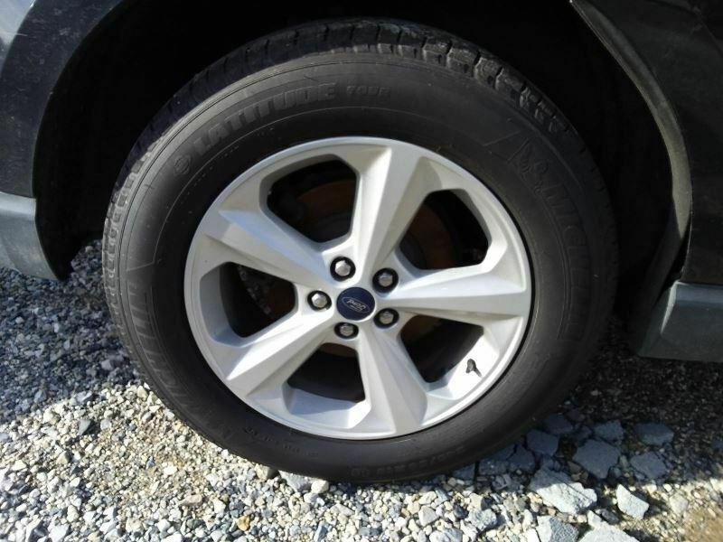

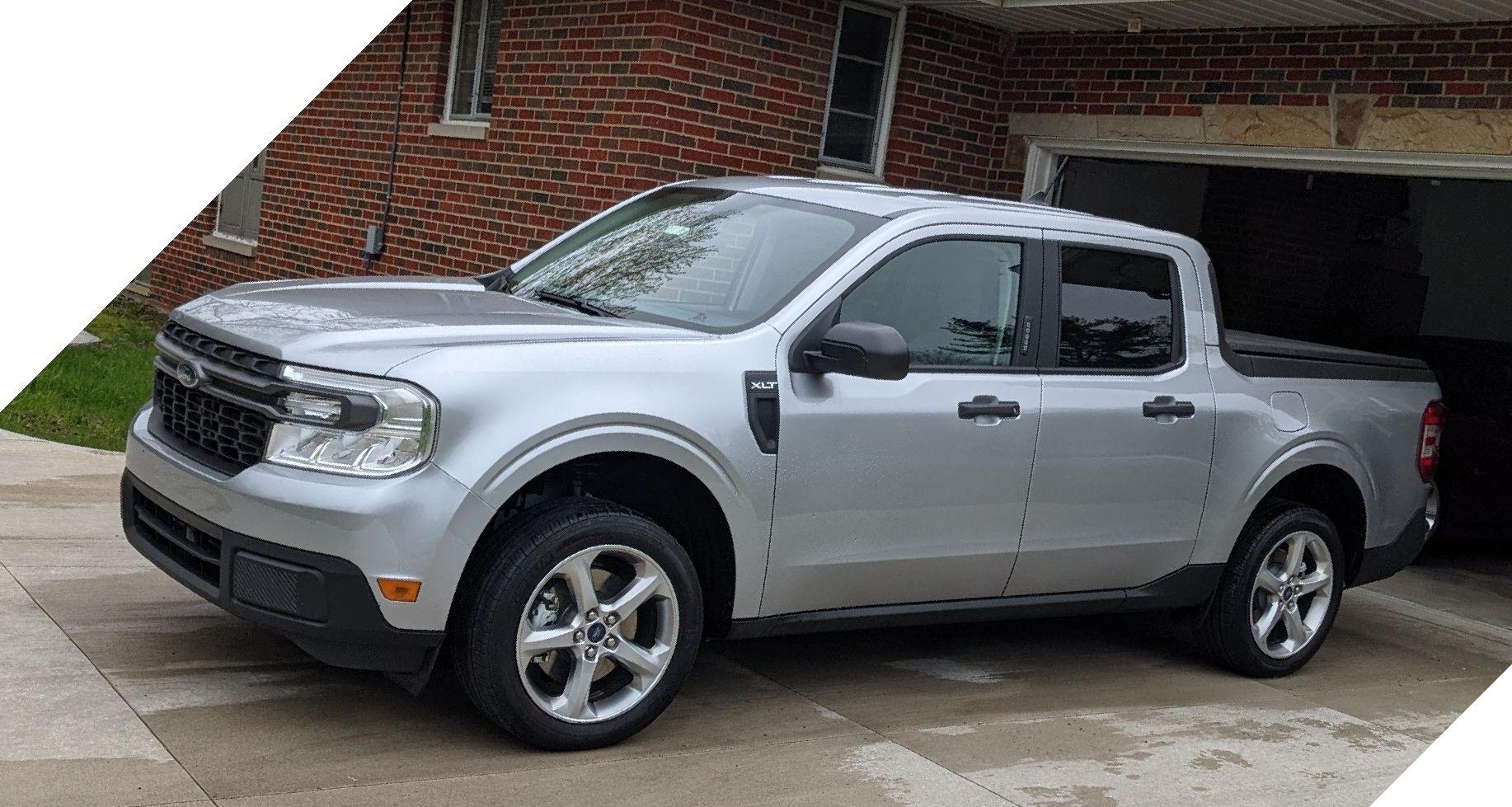

Here's a pic of my 2018 5-spoke wheels, 235/50/18. (BELOW)
Wheels look good but the tires WAY TOO SMALL (50 series)!
I'm switching them back tonight.

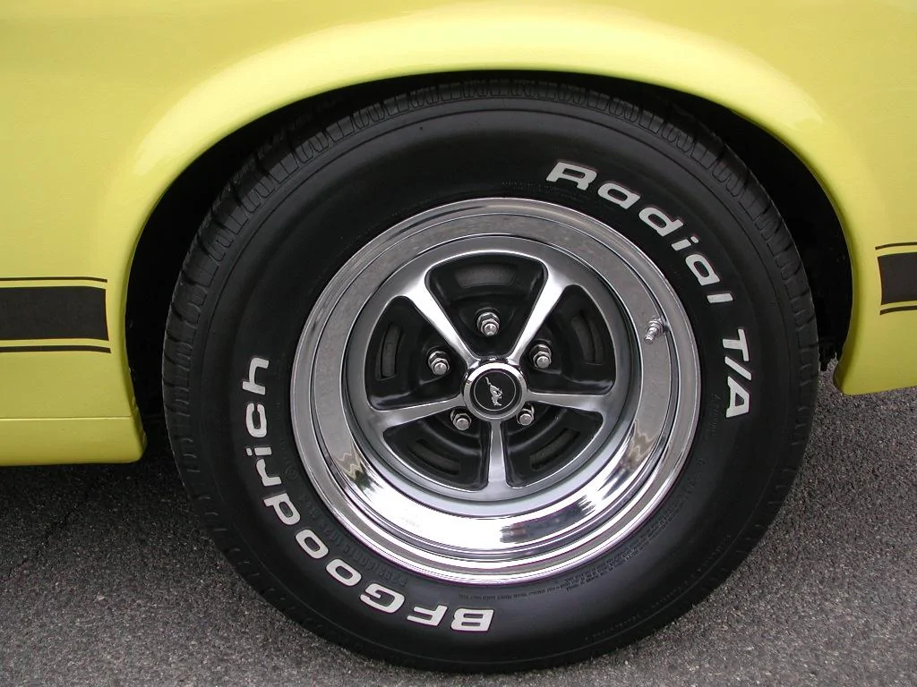

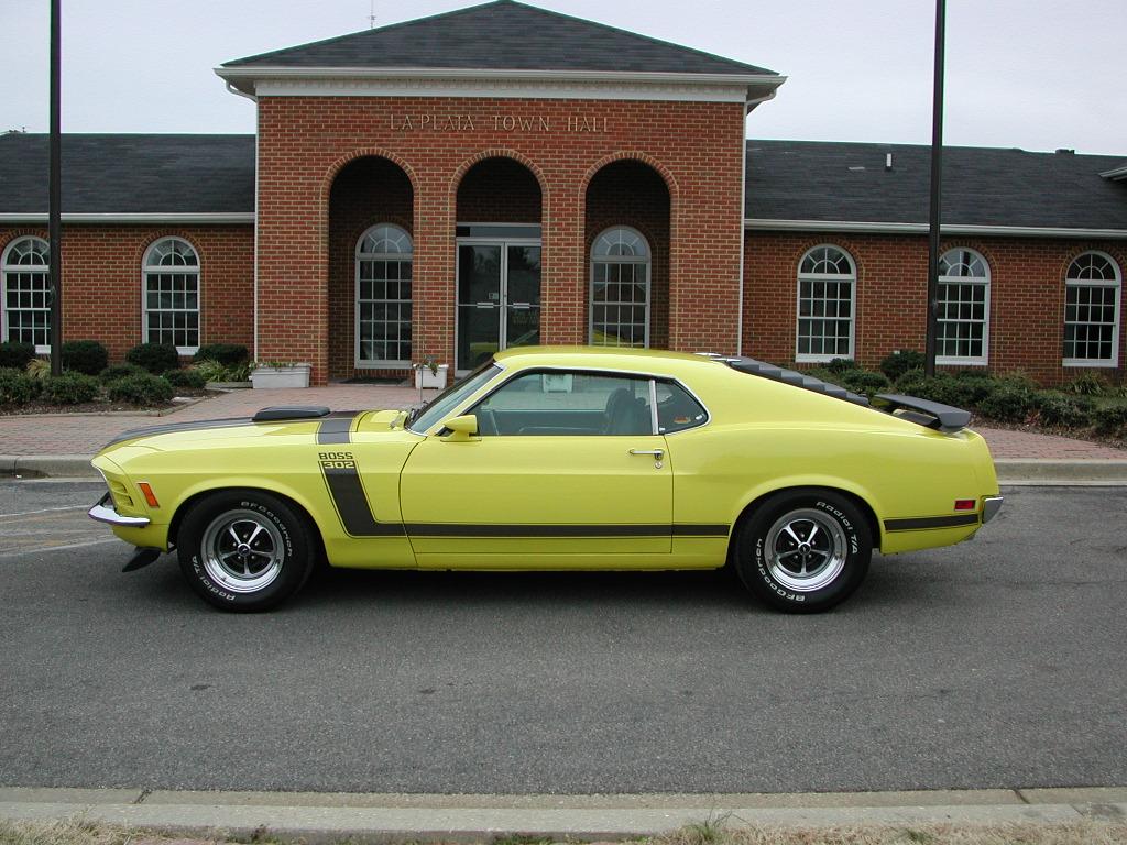

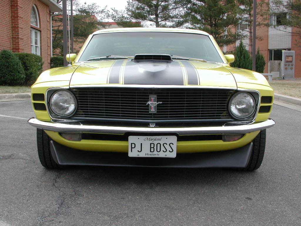

twoquickcapri said:
Don't know if they will fit but the 18" wheels kinda look like Magnum 500.
Get some Simichrome out and you'd have a Cragar SS vibe going (for us old guys!)
HRG
This is a Magnum 500 wheel:
Agreed, wheels look great, especially on your Silver truck, it just needs more tire.
good luck...

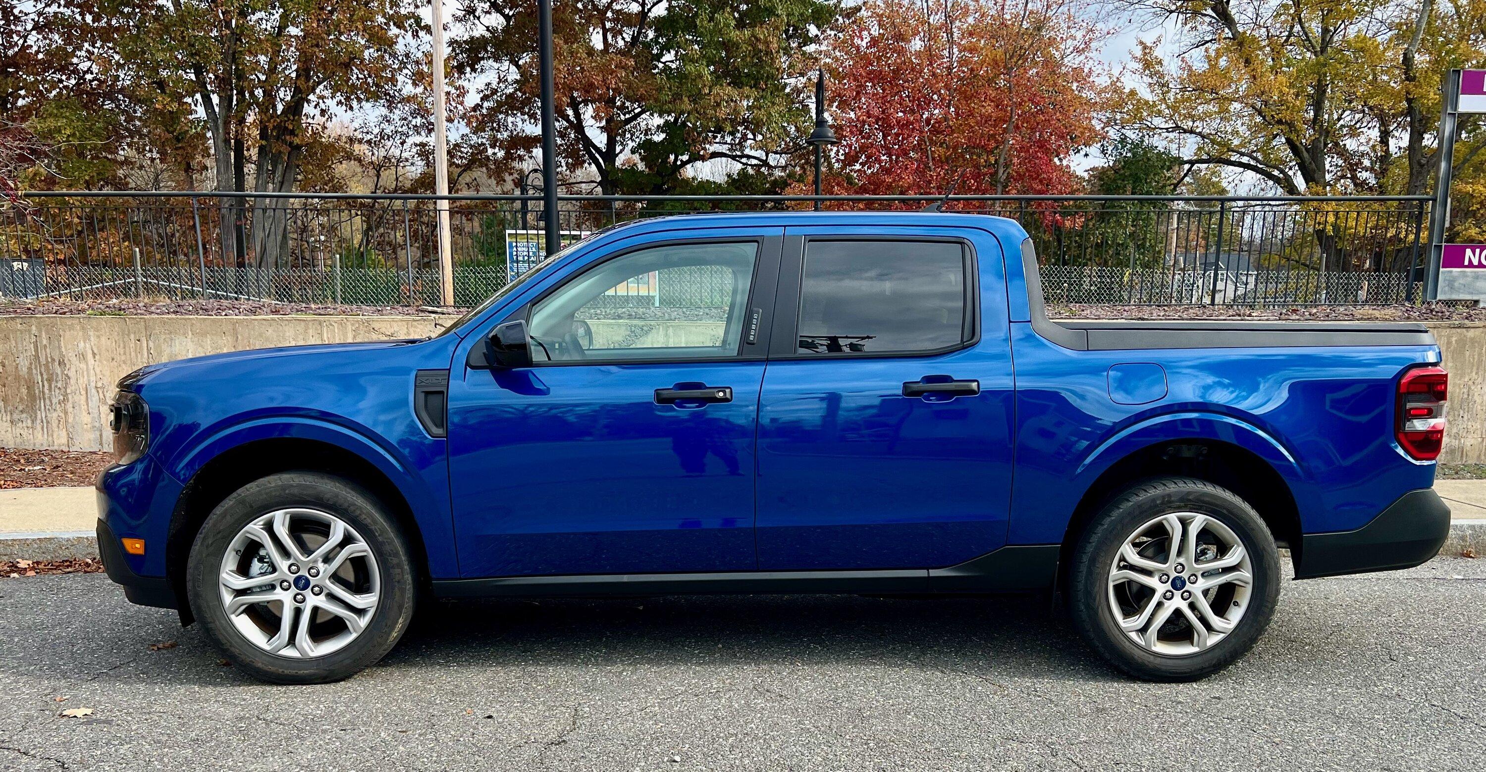

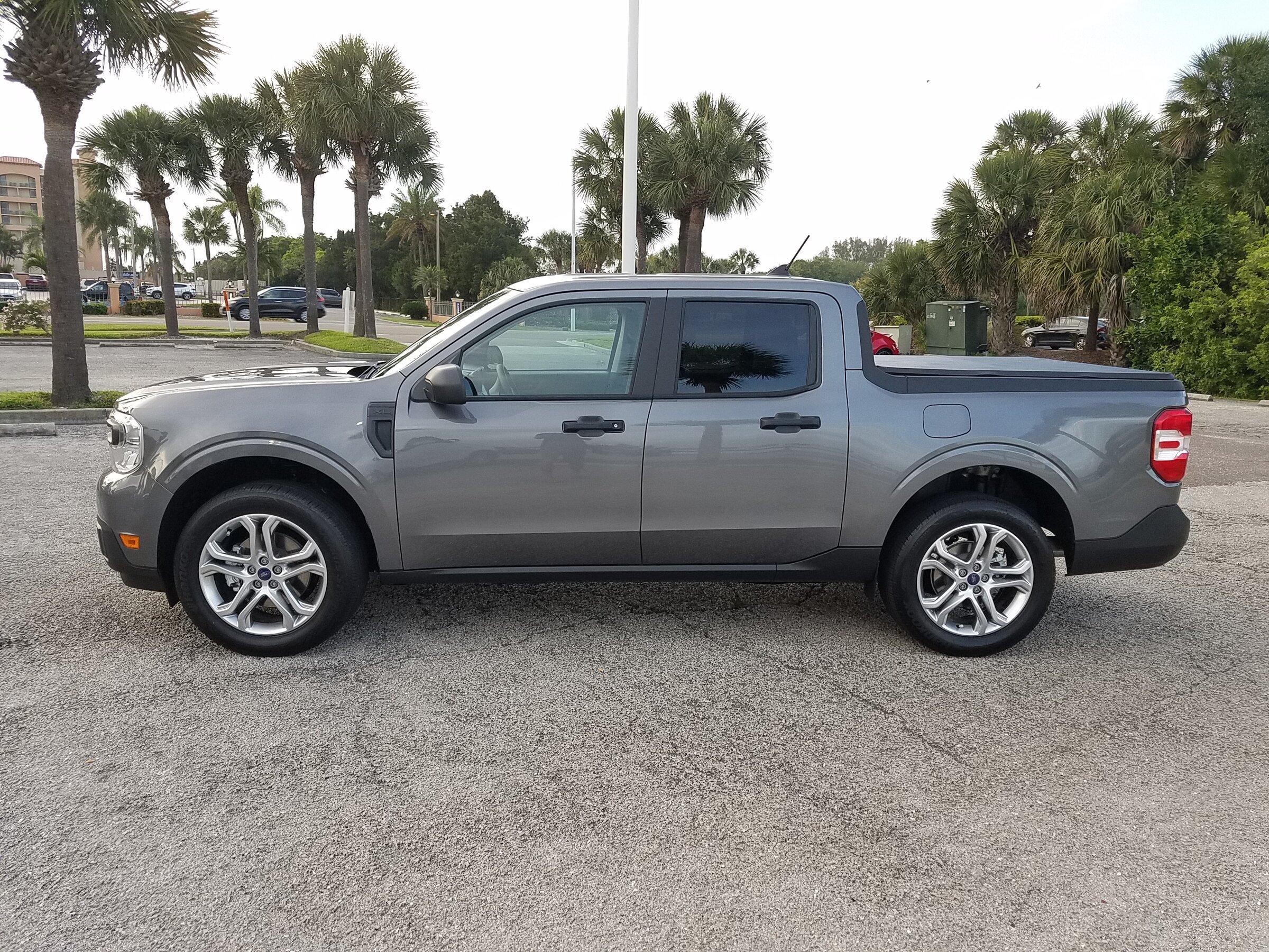

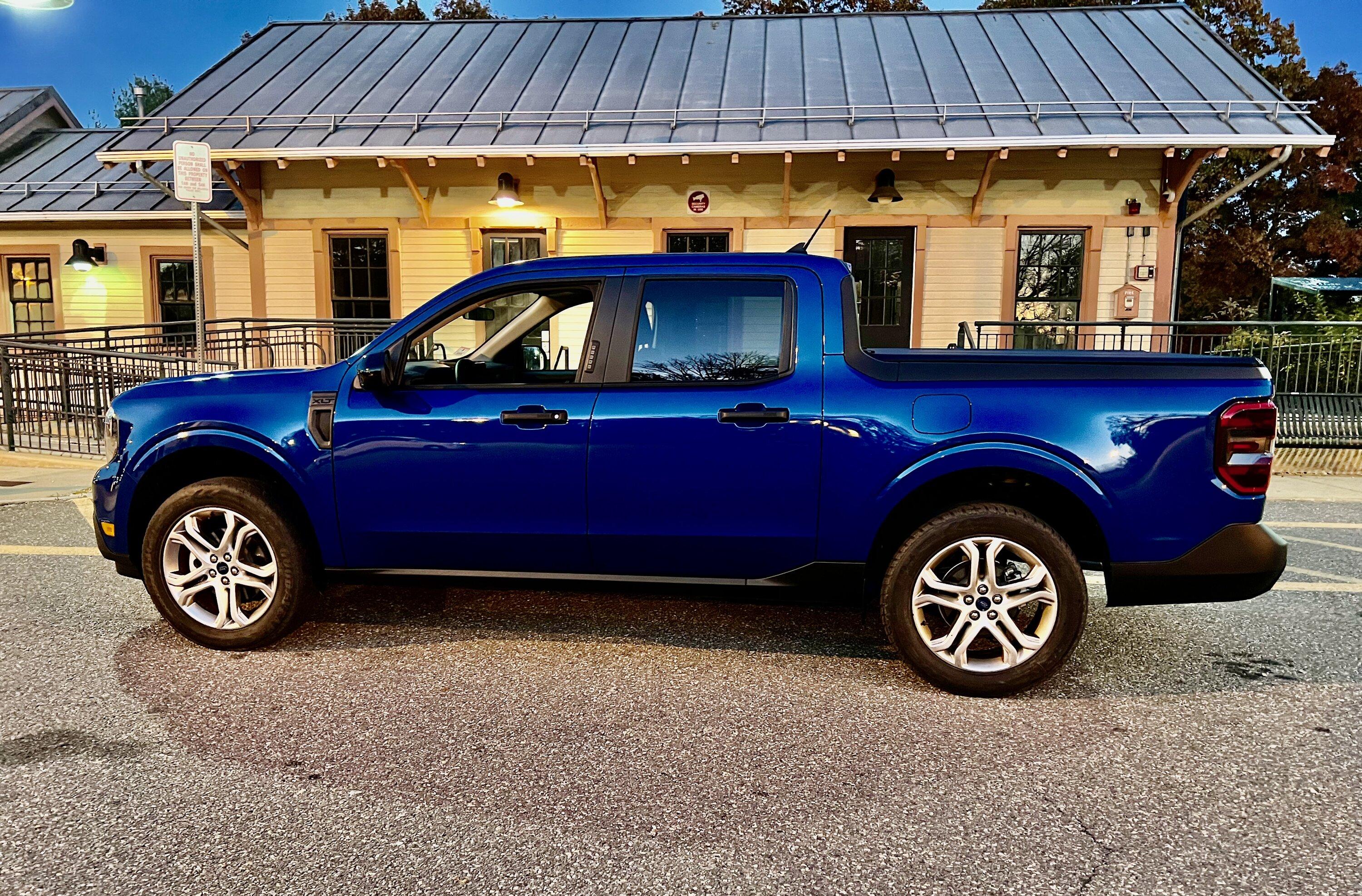

I agree that the Edge Wheels look great on a Maverick and I hunted down a set and tried them on this afternoon. This set had 255/55 19 tires that were very worn, but I wanted to check for rubbing before buying new tires. I don't think there was any issue in front but it's hard to tell with the soft front wheel well liner. I didn't hear any rubbing. I did have rubbing in the back on the hard inner liner. I'll take them off in the morning and see where, but I suspect it's at the widest part of the tire.

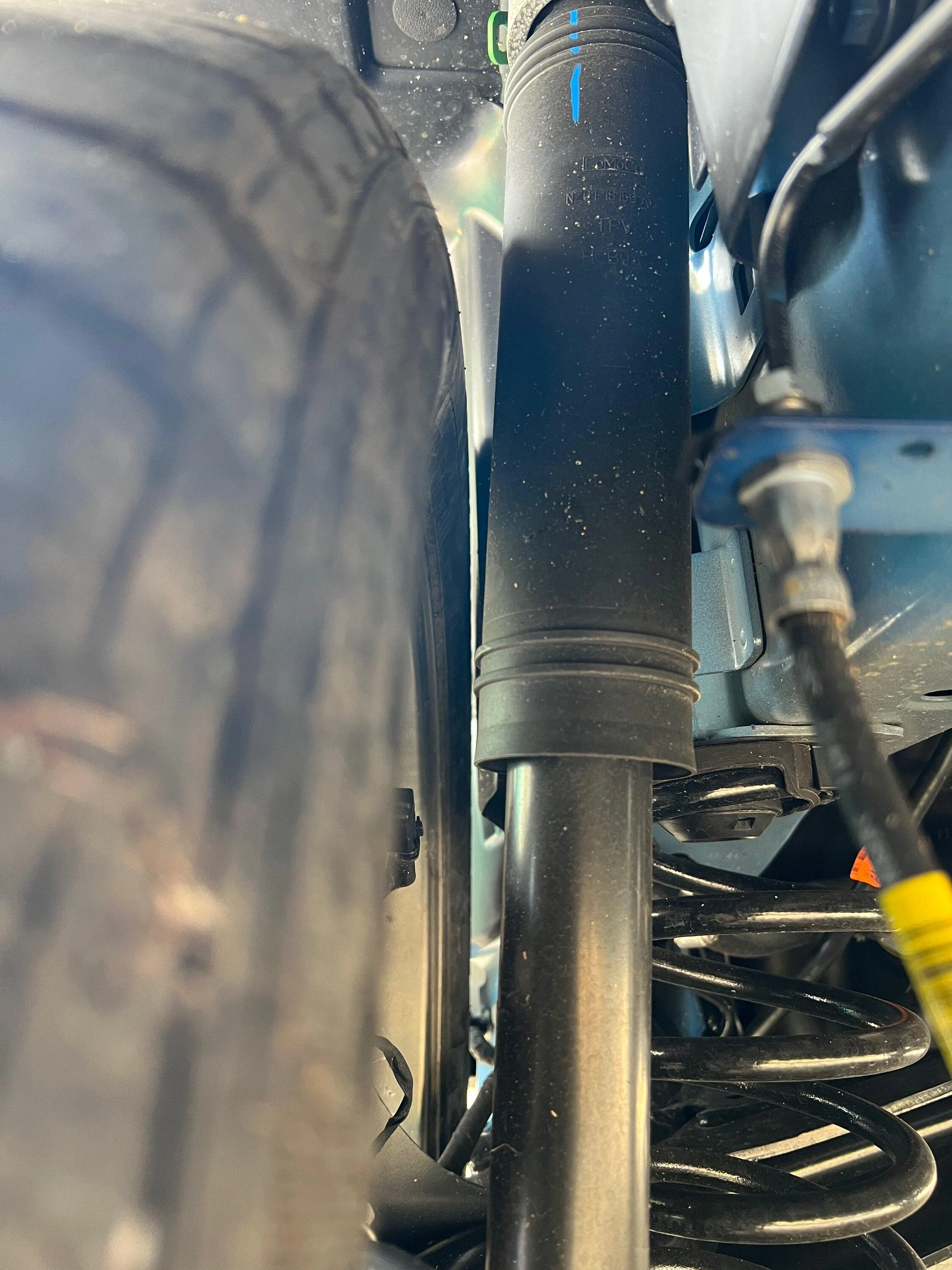

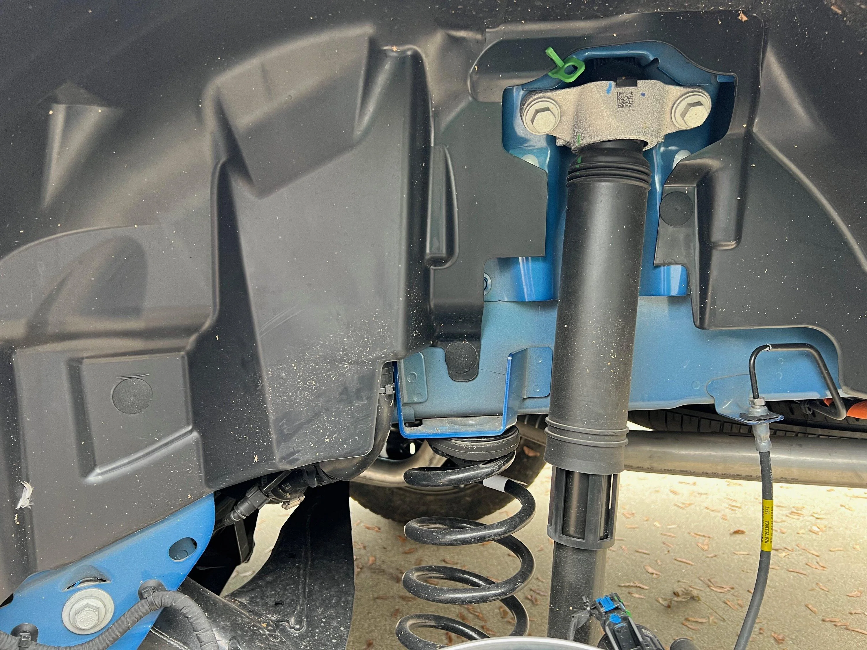

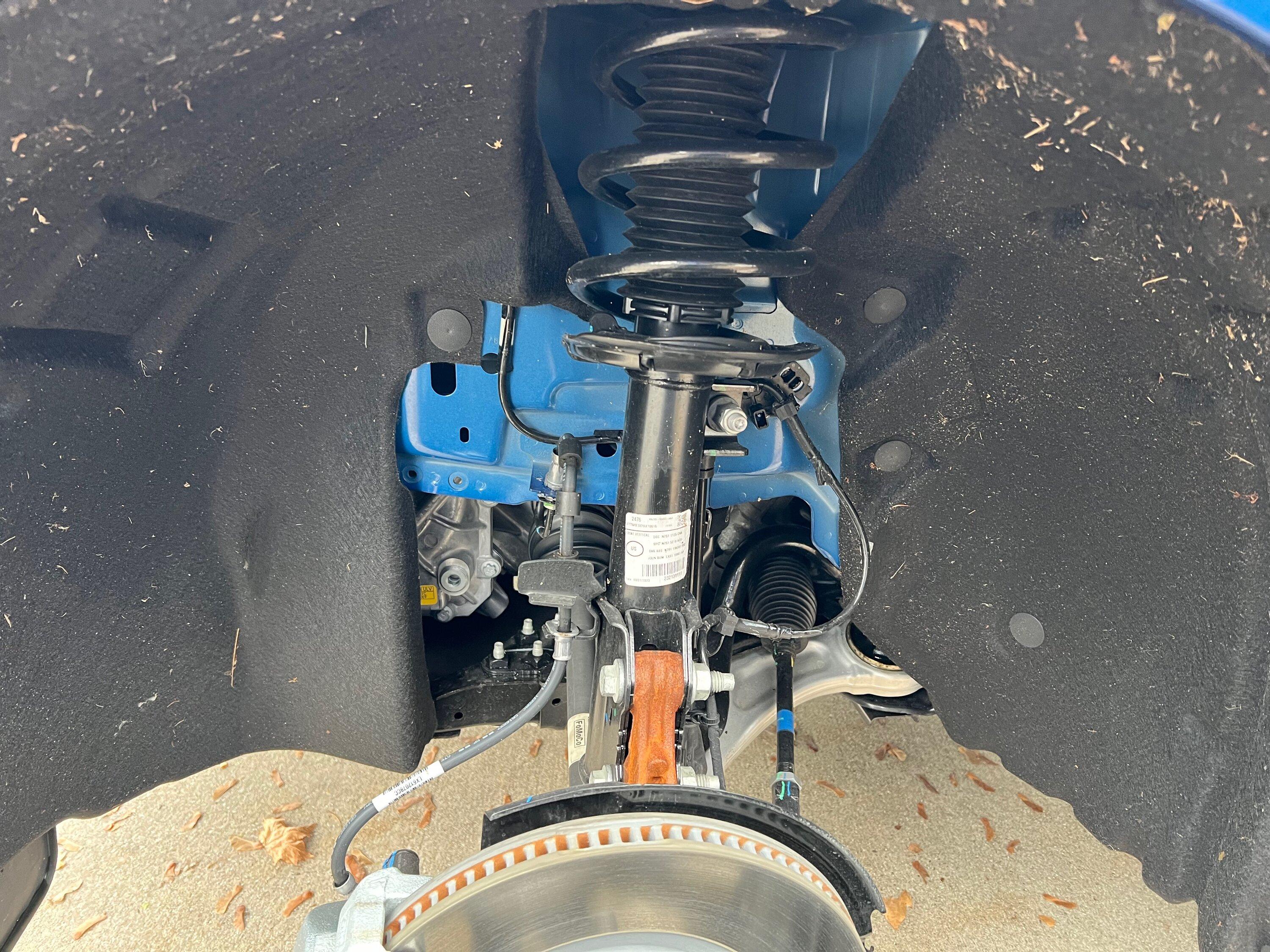

The 255 55 19 on Edge wheels do rub a bit. Just a touch on the front inner liner on both sides, Shown is the front drivers' side. You can see the rub at 9 o'clock in the picture.
Ford Maverick Ford Edge Wheels WILL fit your Maverick Left front rub
And on the driver's rear it rubs the hardliner where it covers the fuel fill.
Ford Maverick Ford Edge Wheels WILL fit your Maverick Left rear rub2

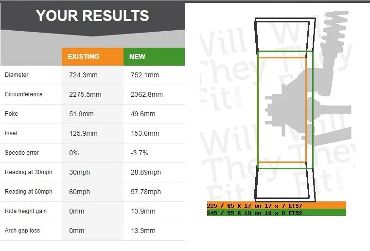

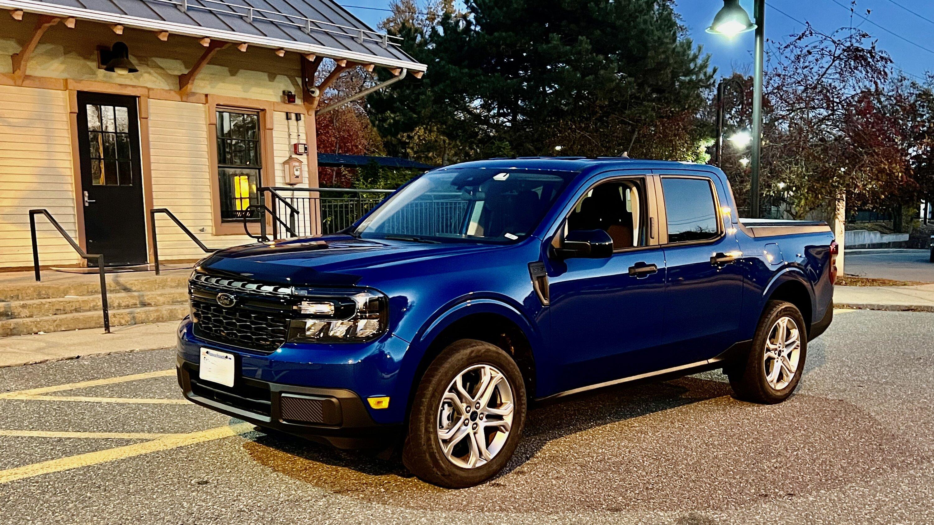

I still like the rims and it's just the oversized tires that cause interference. I'm going to get a set of 245/55 19s for these rims. I'd like to stay away from spacers.
