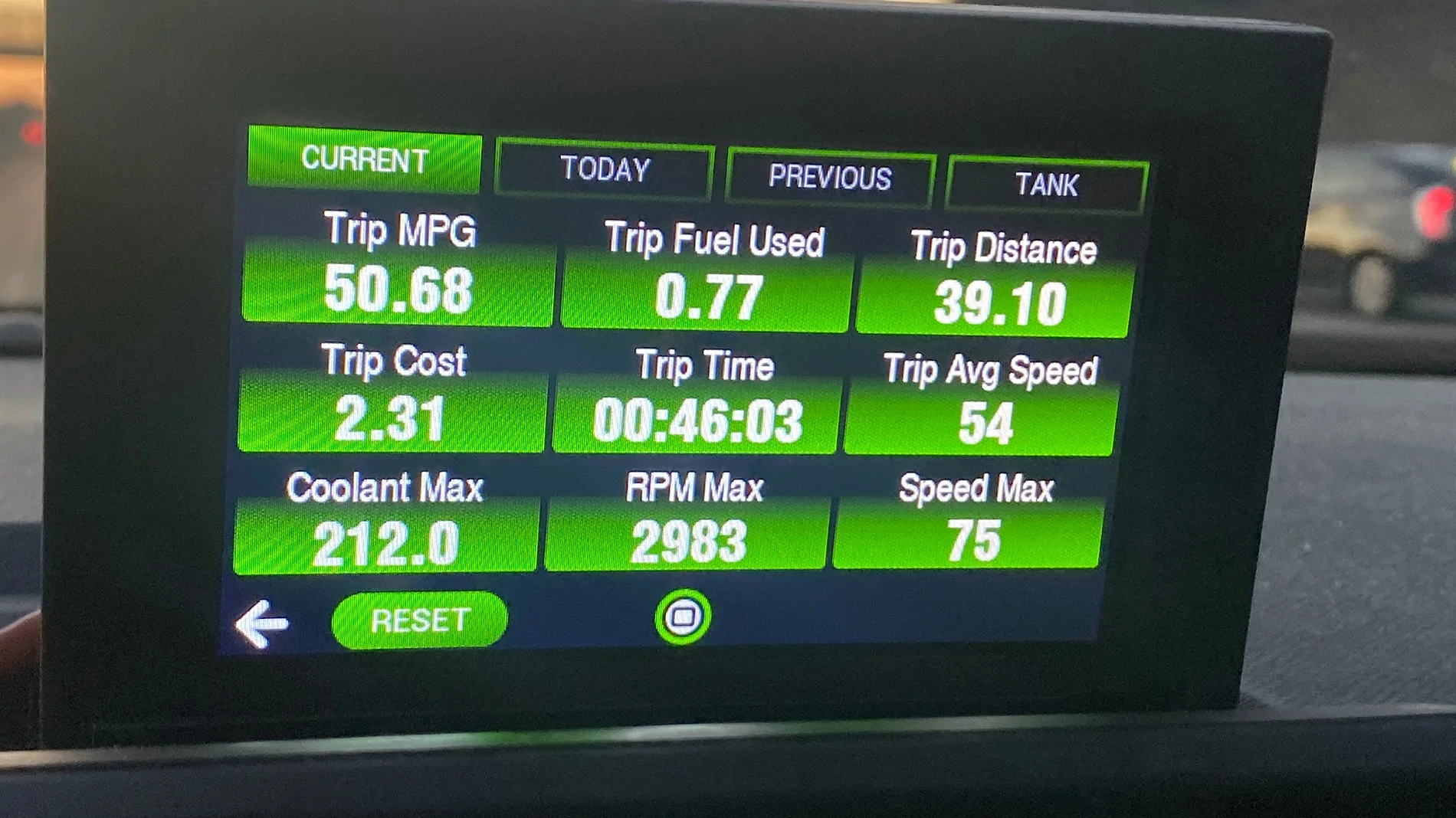

It is advantageous 100% of the time to drive in "serial hybrid mode". Think of a Chevy Volt.
The Maverick can behave like this, and there are ways to force it to do this more often than naturally occurs.
(Driving in reverse past battery depletion is always serial hybrid mode.)
Pulse and glide with battery use to extend the glide is forcing a form of serial mode.
Before talk of "conversion losses" pops up, let me nip that in the bud.
It is better to drive with electricity (90+ percent efficient) than to drive with gas (30-35 percent efficient) with brief periods of battery boost getting your average to 40 percent efficient.
The electric drive is SO DARN GOOD it is a fuel saver after and including the conversion losses.
How do I know?
50 MPG HWY and 60 MPG city when I focus on making the most serial drive mode minutes per trip.
