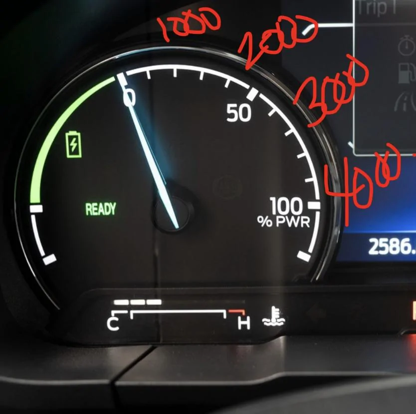

i really enjoy the side by side kW gauge on fusion hybrid. ICE kW arch on top and EV kW underneath. Gives you a tach like equivalent. Has battery gauge and ICE/EV miles listed as well. Makes it easier to stay on EV when possible.
The hybrid % gauge is a tach of sorts. Display could be done better, perhaps with multiple visual scale rings with multiple pointers. An actual ice tach would be nice to determine if ice was on or not, scale could be green if powered and orange if engine braking. Pointer aka battery tach! showing rate of charge or discharge of HVB, another for 12v. Ford could charge extra for a tach package? Would be interesting to see what starter/generator was doing. When are hydraulic brakes being used? Aaarrrggghhh!

Problem Solved:
Not bad and kinda-sorta true.
Except the bottom is 1250 and the top end is 5600. I've measured.
But it's also a horsepower gauge.
The first tick mark: 10% is really 19 horsepower : EV or ICE. The next, 20% is 38 horsepower; and so on.
Ya all have figured out by now you have to really baby it to stay all electric right? And you've noticed this is in the 10% and less zone, right?
That is what 19 horsepower feels like.
There is a 22 electric horsepower limit in EV. I've never seen more. The EV power limit is set, presumably, to keep enough power headroom to start the ICE at the same time the battery is propelling you.

We need someone to do a peel-n-stick decal to put on what is normally a useless gauge on the power side.

Everyone realizes that the hybrid goes to 11, right?
10% over 100% power by the looks of the gauge. That's an engineering feat. All coaches should be so happy to find a vehicle that can give 110%.
