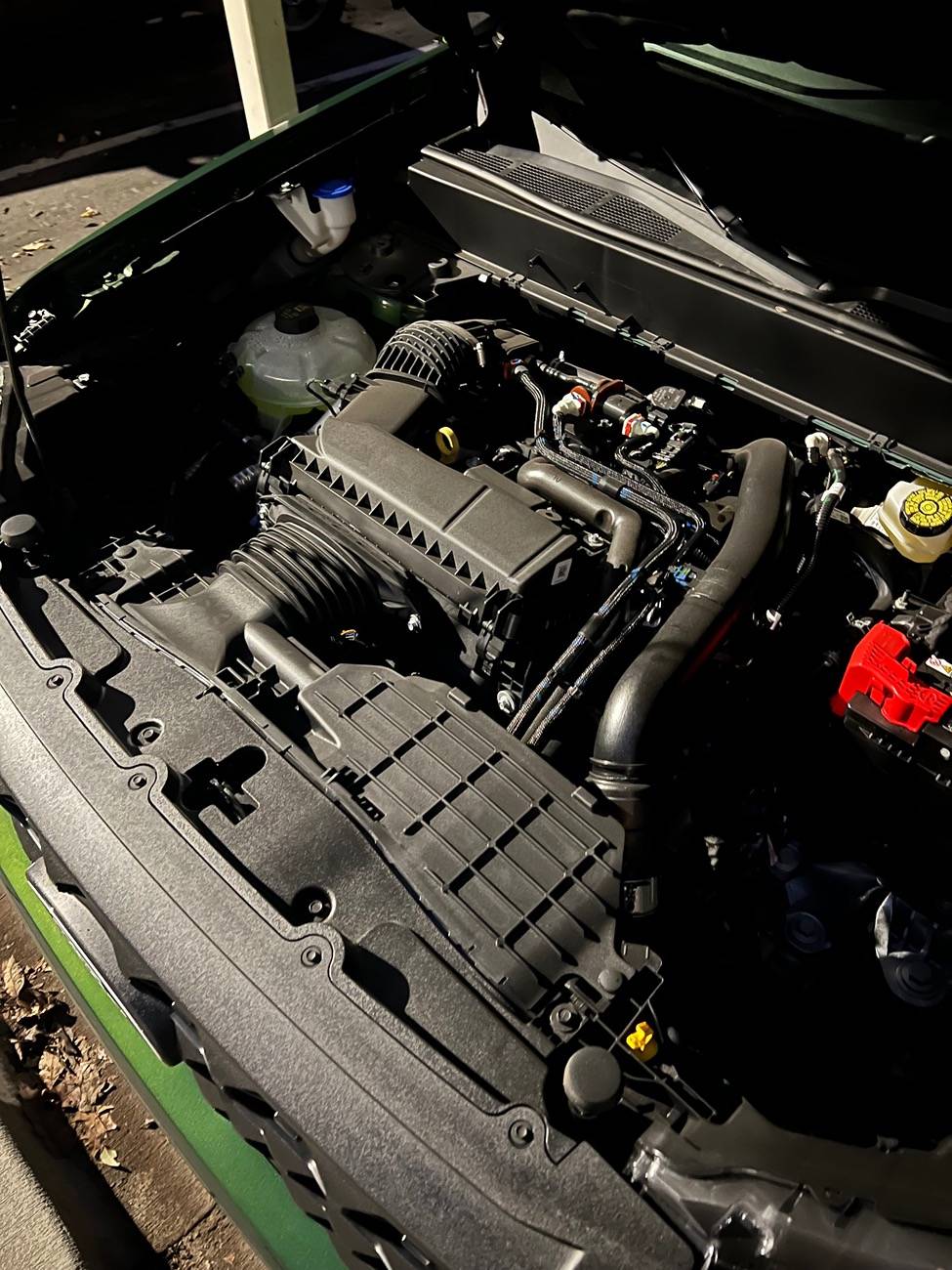

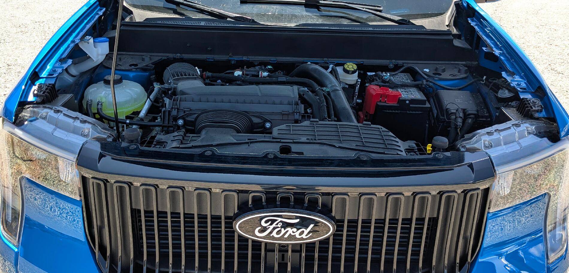

it's taking air from the top of the grille which is as cold as it's going to get - much better than a K&N open in the engine bay - and it's a very direct path from the inlet to a small airbox, and into the intake manifold.
I highly, highly doubt an aftermarket intake would improve upon this especially on otherwise stock trucks. I'd vote that removing this will decrease performance for most if not all trucks.
Thanks again for info. I do notice quite a large intake resonator to the right of the short intake duct. If I’m looking hear more intake - do you think that resonator can be manipulated? If I’m pestering you too much it is ok to “ghost me”:).

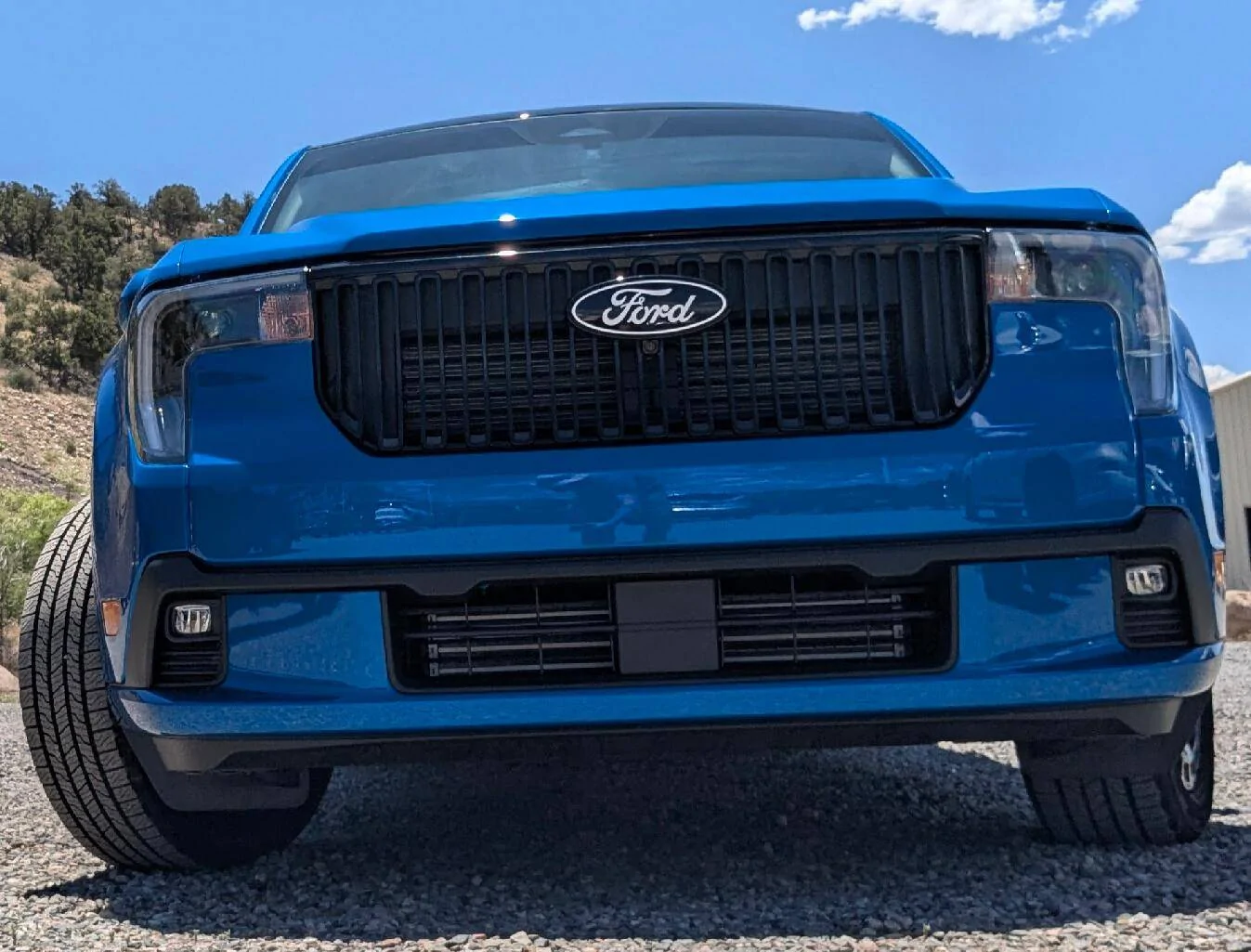

Well, I think it at least is ingesting air from somewhere in front of the vehicle by looking at the intake path.
But, I can't confirm where, by looking from the front grille. No obvious intake tube extending in front of the radiator.
The air can't be all bad even if just pulling from just above the radiator without an exposed intake tube. Assuming your moving, with even minimal air flow it should provide fairly decent fresh air intake.

so that resonator may be doing more than noise control. it could be tuned to alter the air velocity in a certain way.
I would not change this in any way other than a drop-in filter, if you really want that and it's available.

The intake resonator is mainly for noise reduction - “the Helmholtz effect. This occurs when the resonator, a chamber designed to cancel specific frequencies, uses the Helmholtz resonance principle to reduce unwanted noise from the air intake system.” Grok3
But I agree with you to be carful if fiddling with it and be able to return it to stock condition.
