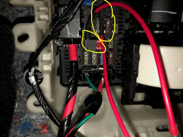

Here's a photo of my fuse panel. I've circled the two wires from the cam, but I do not remember which one should be acc and which one was for constant. Black, of course is for ground and you should be able to find one in that area. Clearly, your cam might be different.
You can look on a fuse diagram (in your manual) to see what these fuses power. Hope this helps a bit.
By the way, I'm in Southern California, not Indiana ways, but I'm sure if I was we'd have a beer together.
