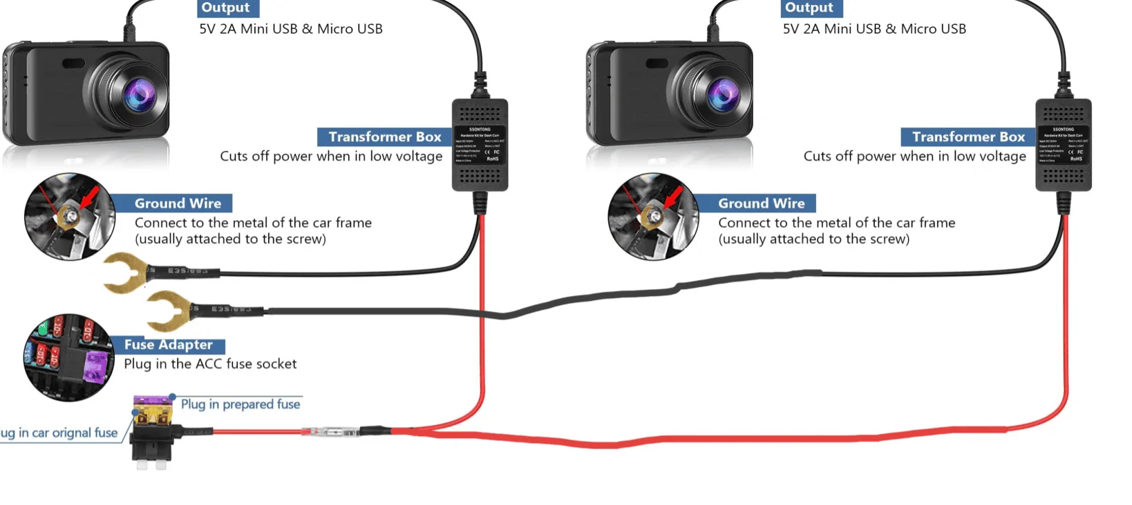

How would you run both cameras off a single tap ?

You should be able to strip the red cable on both cameras twist them together and put them in the blue connector on the fuse tap. It's possible you might have to change out the blue connector for a larger one but it should work.

Do you mean like this :
Like this ?
Ford Maverick Dash Cam #2 (Rear) - Can I Fuse Tap to Under Hood Fuse Box ? Screen Shot 2022-12-05 at 9.04.07 PM

Like this ?
Yep. I think the fuse tap you linked would probably be a better option, so if you're in no hurry then I'd go that route, otherwise I think your diagram should work.
